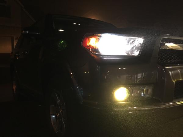

I did the H9 and 9011 upgrade (65 watt) last spring in my 2014 and no issues whatsoever (other than better light). Also installed 55W H11 in to the fogs where 19W H16 were. No issues.
Reverse lights also upgraded to 50 watt.
Pics in this post...
