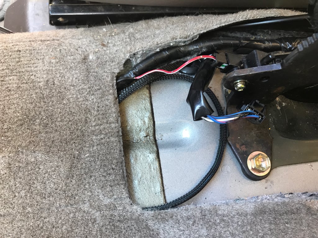

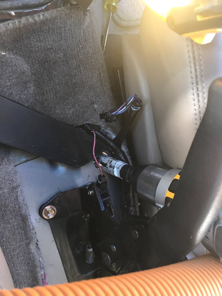

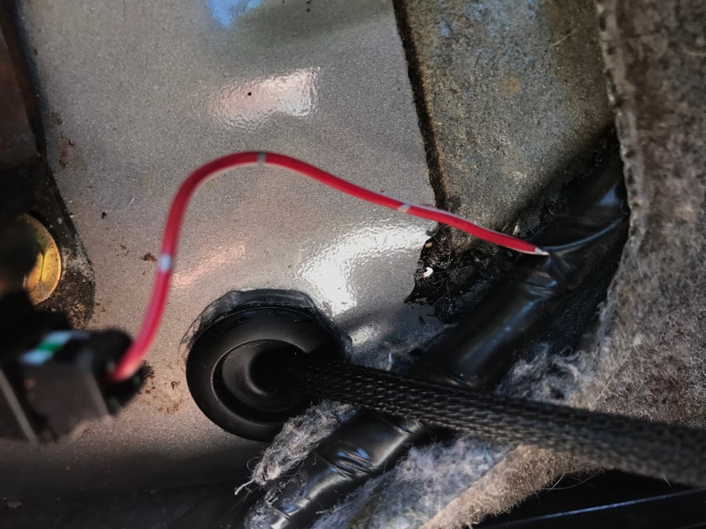

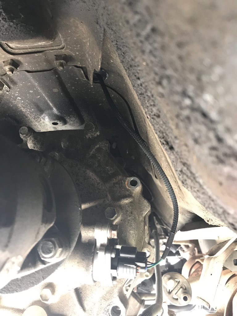

Picked a spot and went for it-
I know some guys are like "run it with the rest of the wiring...go through the firewall boot" Yeah, fvck that. I like easy, and this was easy. I also like no extra wiring in the engine bay, and this is 100% unseen.
Put a little silicone around the gromet for some insurance. The hole saw was bigger than I should have used, so the gromet wasn't a super snug fit. Should have used a step bit; oh well.
Cell phone AND sideways pics?! I must really not care right now.
Left a 6" loop, because who doesn't like dual cases?
Ran it with the other wiring I ran for the manual swap-
Hoping it works [emoji1374][emoji51]

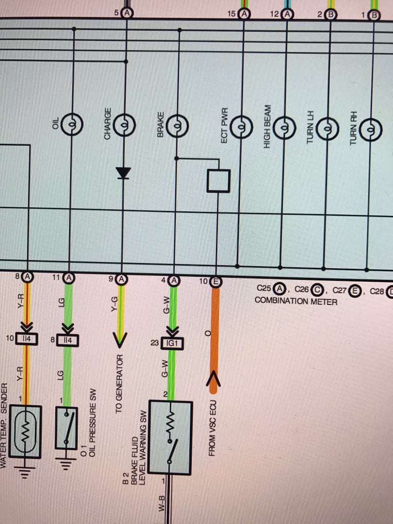

Don't mind the FVCKING BRAKE LIGHT! [emoji35][emoji21][emoji36]

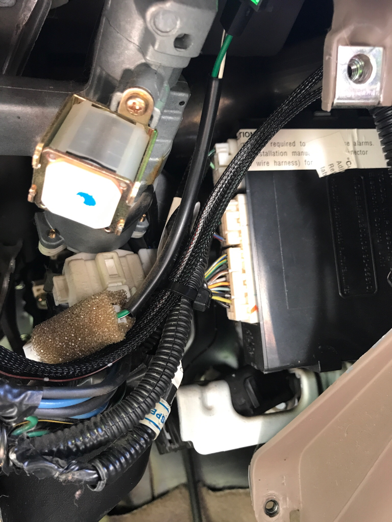

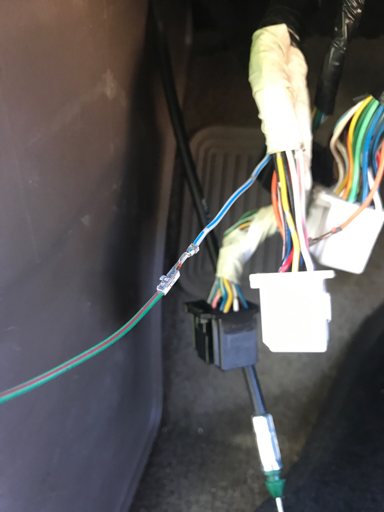

For those not reading my current thread about the brake light-
It's tied into the VSC ECU, and since my manual engine ECU doesn't have VSC, the system isn't going to be used at all. The parking brake lead actually goes straight to the VSC ECU, then to the cluster from there. Without the VSC ECU in, the brake light just stays lit. I'm trying to figure out how to defeat it, but the EWD isn't super clear.
I need to figure out what the square is that's in-line with the ground path of the brake light-
It has +12v to ground when the ignition is on. I might just have to send it to ground, but I'm hesitant to try things with electronics that I don't know 100% what I am doing.

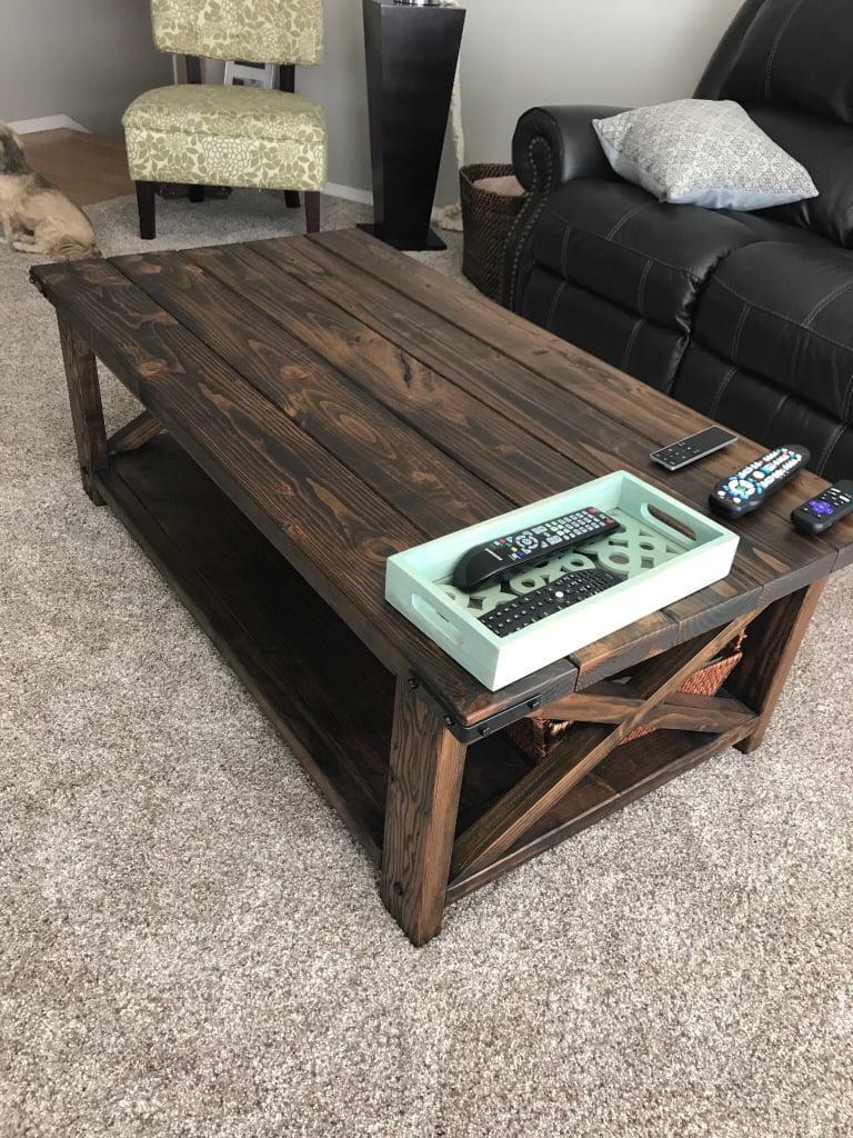

Thanks for the compliments on the wood projects! It's pretty freakin cheap man. The table was only $54 in lumber, and the coffee table was probably about the same. The only tools we have are a 12" DeWalt compound miter saw, 18g nail gun, orbital sander, impact driver, and a Kreg pocket hole jig. A table saw would be really nice to have, but we've gotten by without one so far.
Got into it from my wife finding people like @shanty2chic on Instagram building cool shit, to be honest. Haha
It's been a ton of fun, and definitely makes it possible to have cool furniture without the expense!

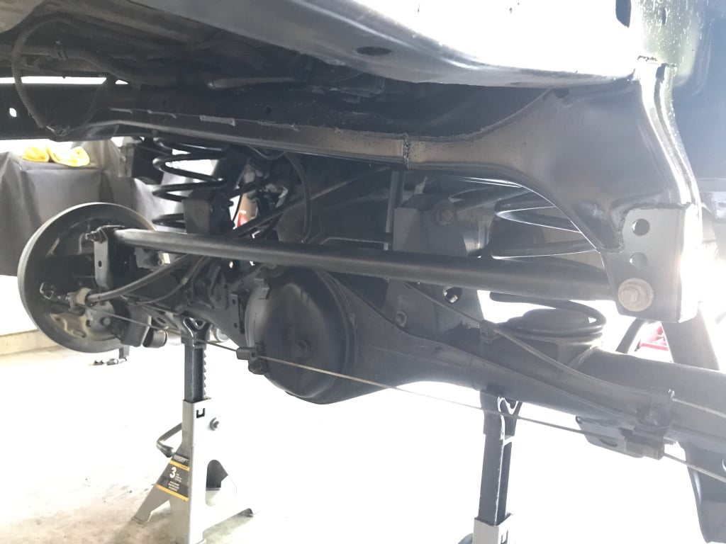

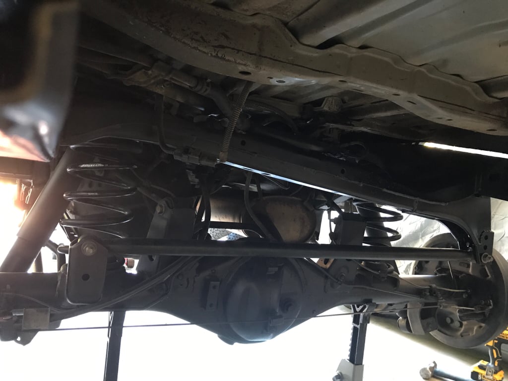

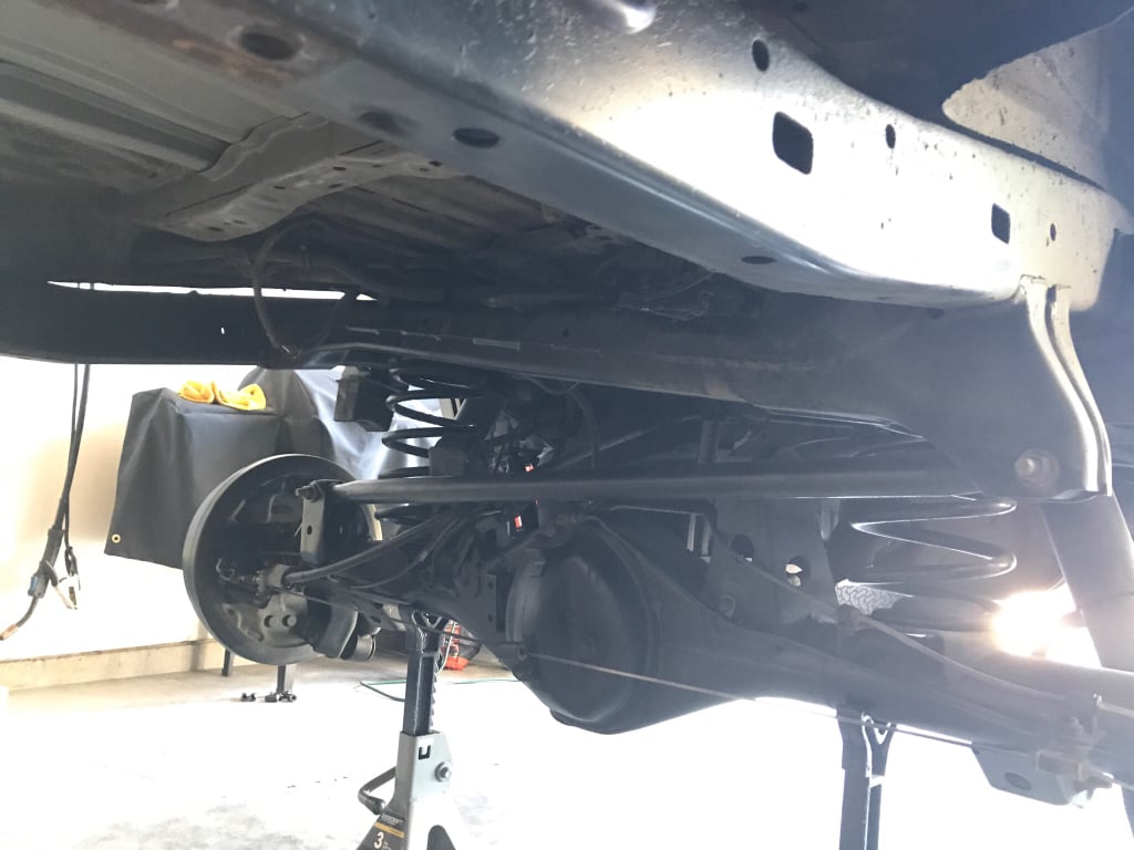

I need to learn how changing the panhard bar would affect the movement of the driveshaft. I don't want to deal with it contacting my gas tank skid plate anymore. I don't even want to think about that topic with everything I had to deal with on that...
Hm, no promises on that. Having the bar corrected WILL push your drive shaft closer to the tank. Your axle isn't centered right now, and having the bar corrected re-centers it- meaning closer to the tank. Would it be a big deal to do a little BFH clearancing on the tank skid?

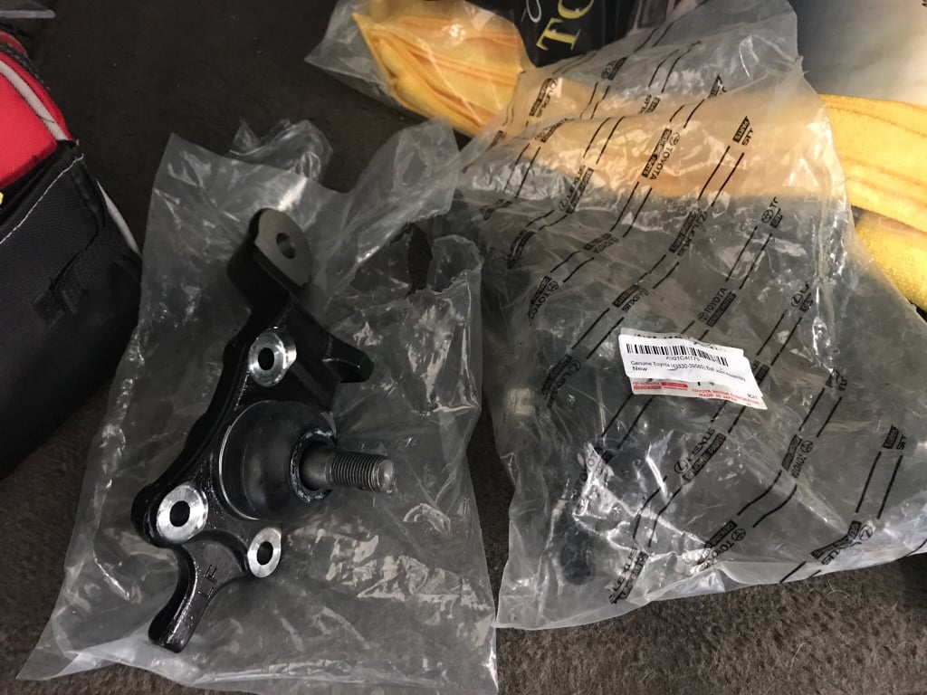

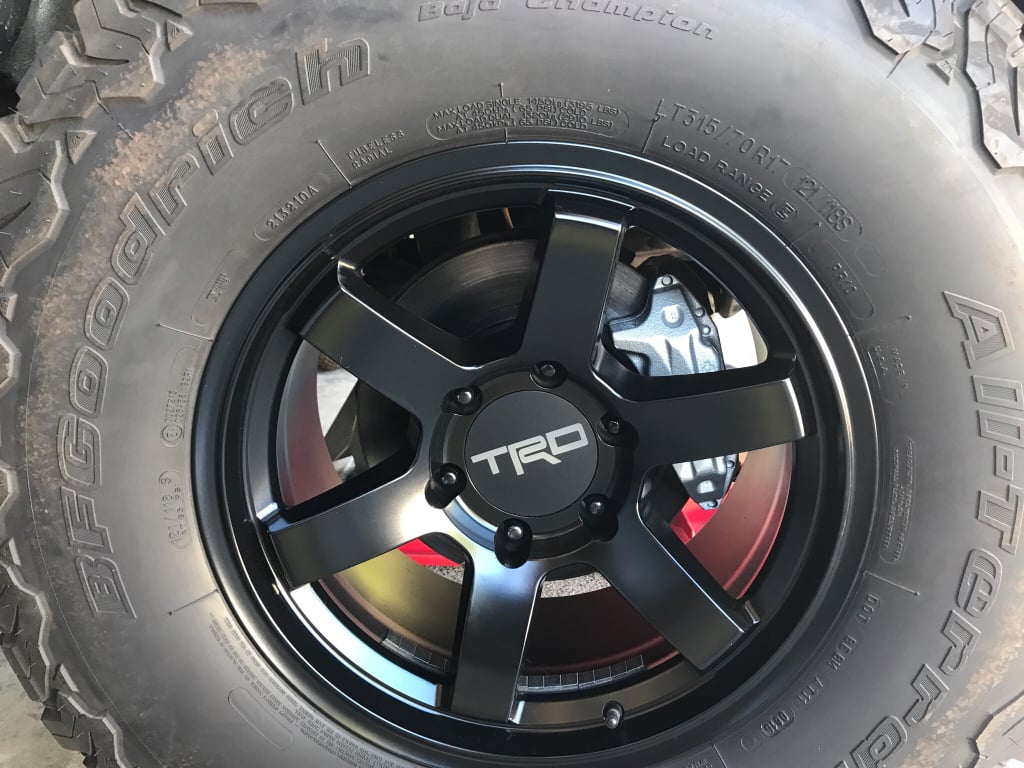

Finally replacing the LBJs
Rotor and calipers were all nasty, so I got those wire wheel'd and painted up

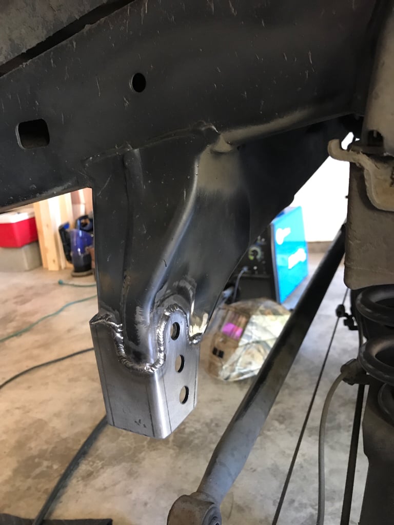

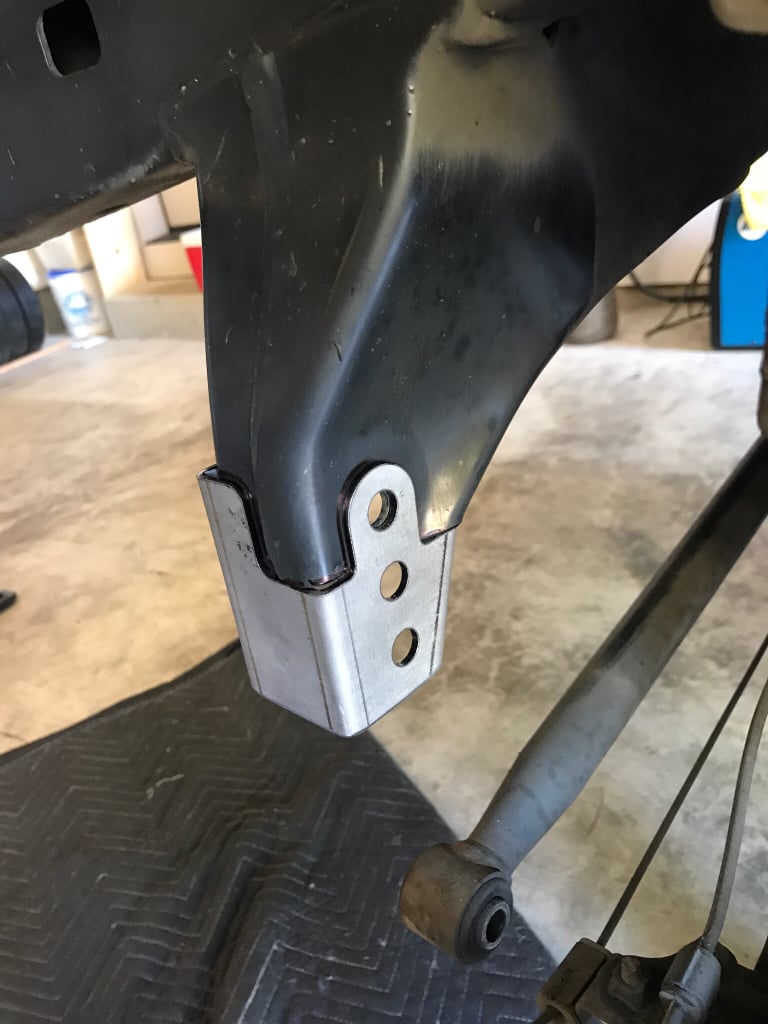

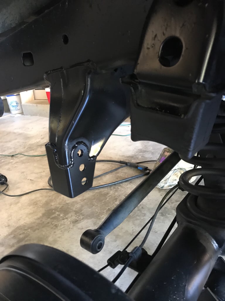

Also, finally got my dude [MENTION=28464]eimkeith[/MENTION]'S upper bracket welded on
Before
After
Just wanted to update and reiterate how well the [MENTION=28464]eimkeith[/MENTION] brackets make these things handle, and how flat they keep you in corners. Don't do just one. Don't be scared of "butt welding" the lower bracket on. Have a competent welder weld it on, and it won't be going anywhere. Chamfer the edges where the butt-weld is, and it will be PLENTY strong for the forces that it sees. [MENTION=116387]Unner[/MENTION] you need these.
I was thinking about this earlier today. Glad to hear another good review, I've heard nothing but good things about them. I might go with them and try to find a welder this Fall that I trust to weld on my truck.
