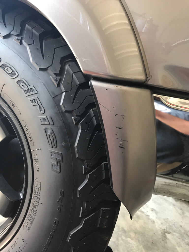

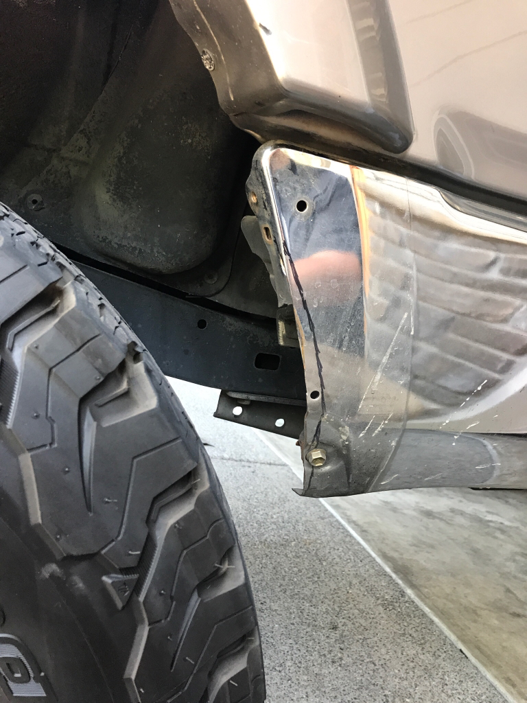

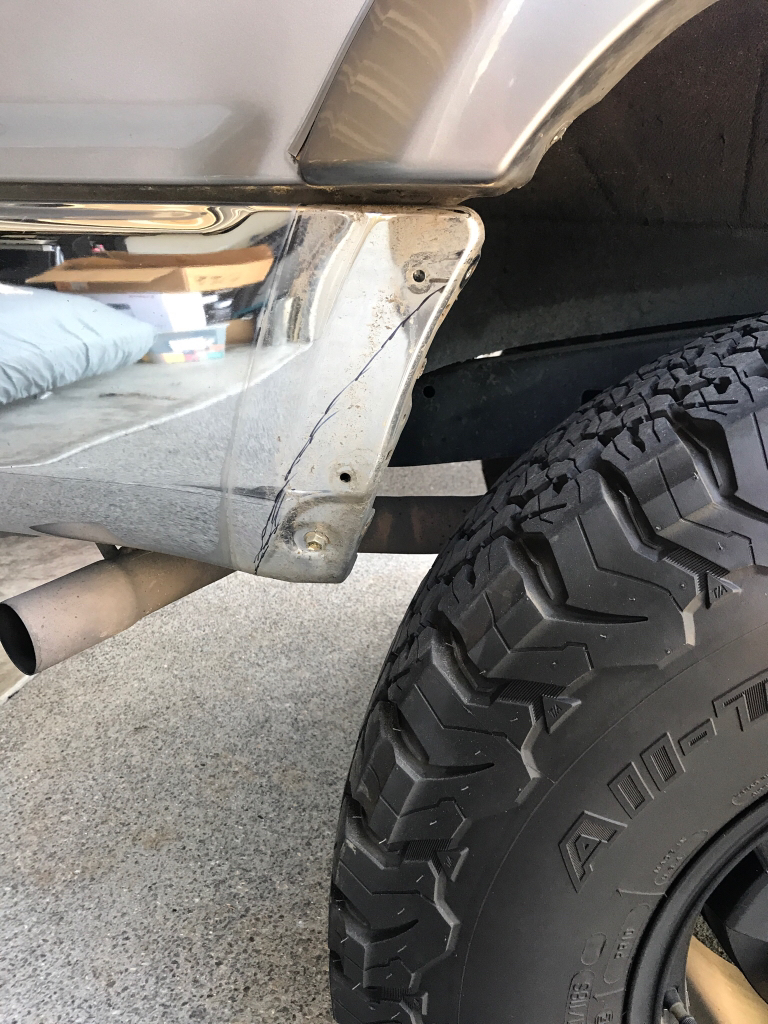

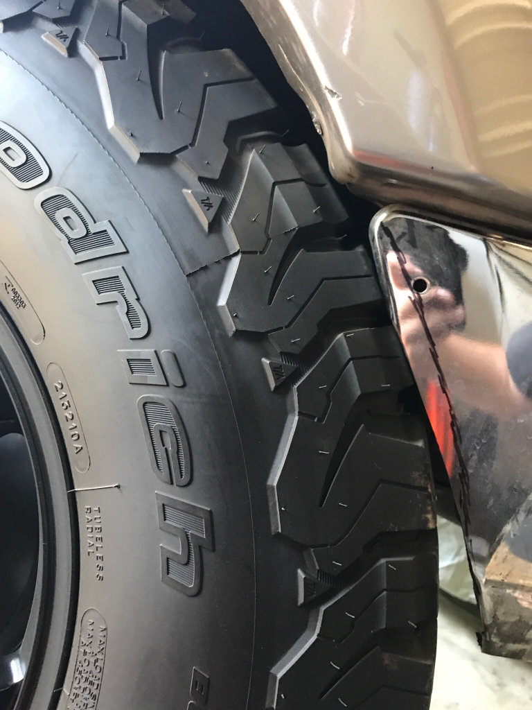

Working on clearancing the rear bumper/flares. This is how it started-
Trimmed, but not enough. The bolt is gonna have to get sacrificed-

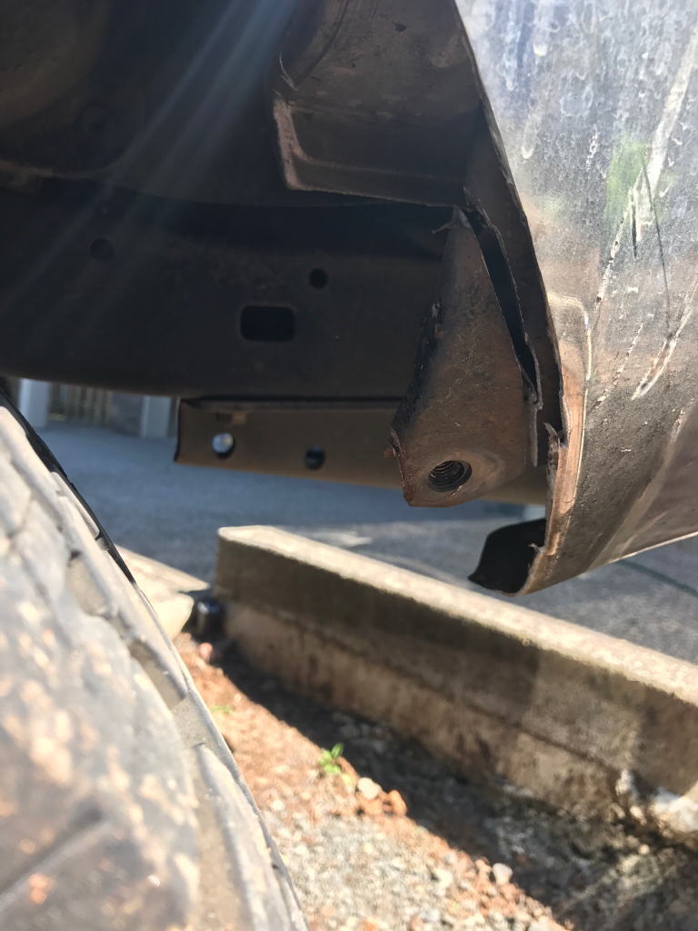

Boom-
Hm, guess that still wasn't enough. New cut marked. Losing the inside bolt I was hoping to keep. Not sure how this beautiful flare is gonna stay attached [emoji23]

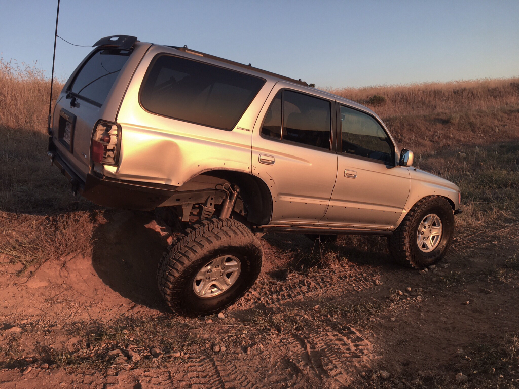

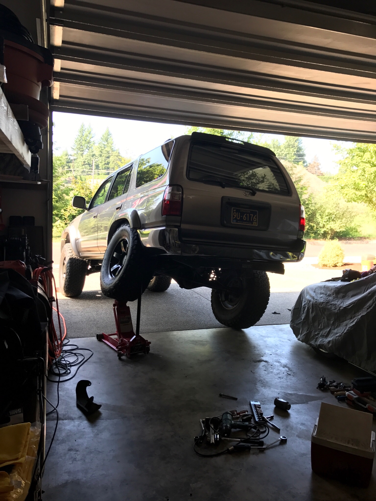

5th gen shocks are a great length, btw. About got the "35" stuffed-
Droop isn't horrible either. I'm really gonna fight [MENTION=57546]4-Ripcord[/MENTION] on his claims about having "way more droop with outboarded shocks" once I get the longer LC shocks-
That's before any tires left the ground, stock RSB end links still hooked up.

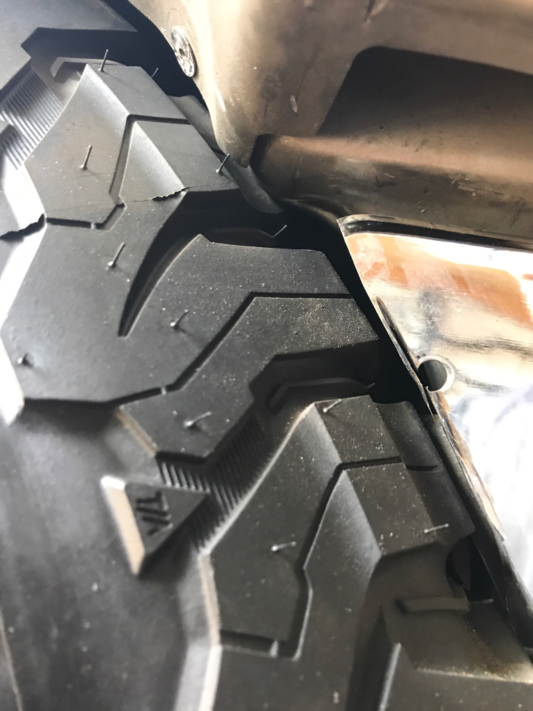

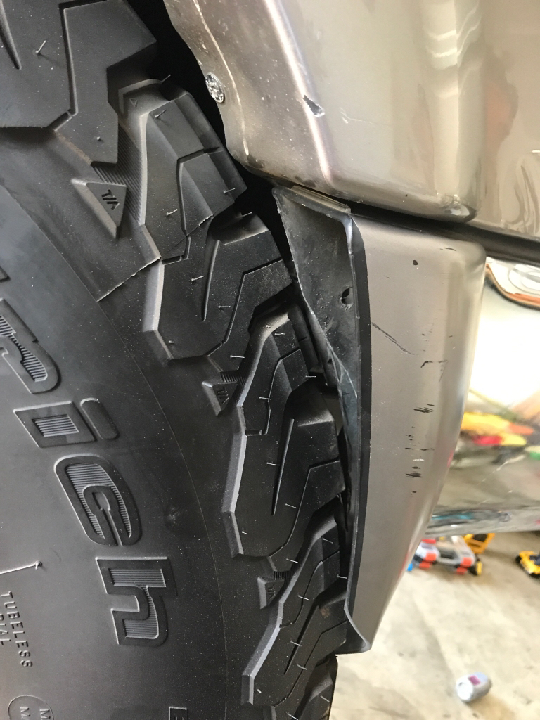

A little bummed to see I am actually up against my quarter [emoji19] Not really wanting to trim my quarter, I think I'll call this max bump. Like I said in my last post- my up-travel stops when the tire hits my quarter. I am also not really interested in shortening my wheelbase just to get more up-travel... or am I... [emoji848] 1/2" might be worth it. I guess we'll see.
The flare will be scooted back 1/2", but I don't think it will be too noticeable- it'll definitely look better than no flare!

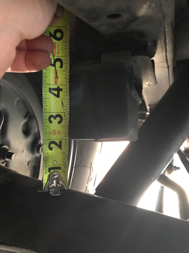

I guess a 3" bump stop extension would about work for me.

I need to add about 3" myself. I'm thinking of the Daystar's 4.5" bumps that [MENTION=118730]AssBurns[/MENTION] is running plus a 2" extension. That should have me bottoming the stops just a hair short of the rear wells. I also might get out the grinder to make it even more clear. lol
Here is a good option for 3" extended bump stops
You can get 3" Extended bump stops for less than $10. Go to a junkyard and find a 1995-2005 Chevy blazer/S10/Oldsmobile Bravada and take the rear bump stops.

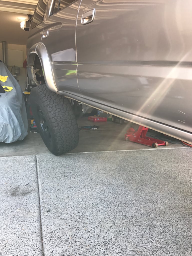

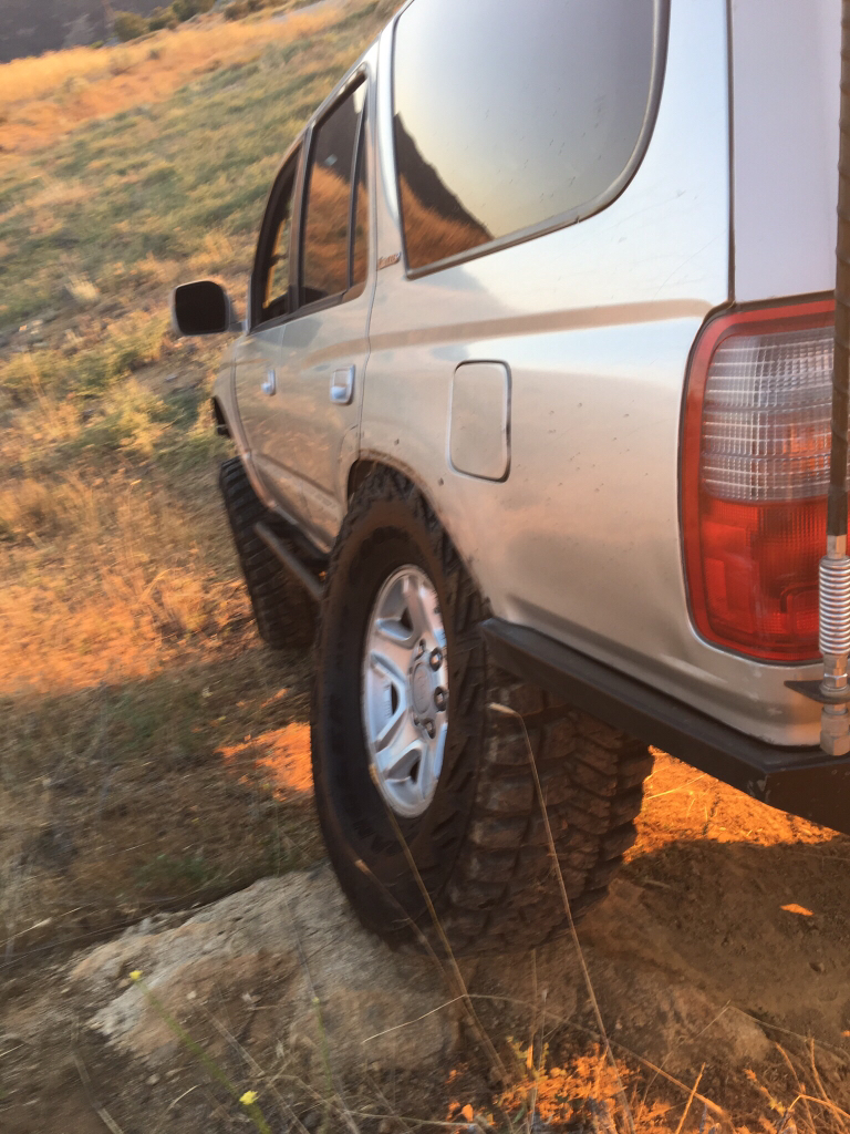

[MENTION=57546]4-Ripcord[/MENTION] Don't listen to [MENTION=116470]Tyler James Inc[/MENTION]. [emoji6] You can have similar droop travel while still having loads of up travel. Only thing limiting my up travel at this point is the top of the inner wheel well. Soon to be fixed. Outboard is the way to go!
Sorry for the super blurry pic but it's the only decent one showing almost full bump.
Droop too [emoji1303]
If you don't want to trim for stock bump, you can just have major droop.
