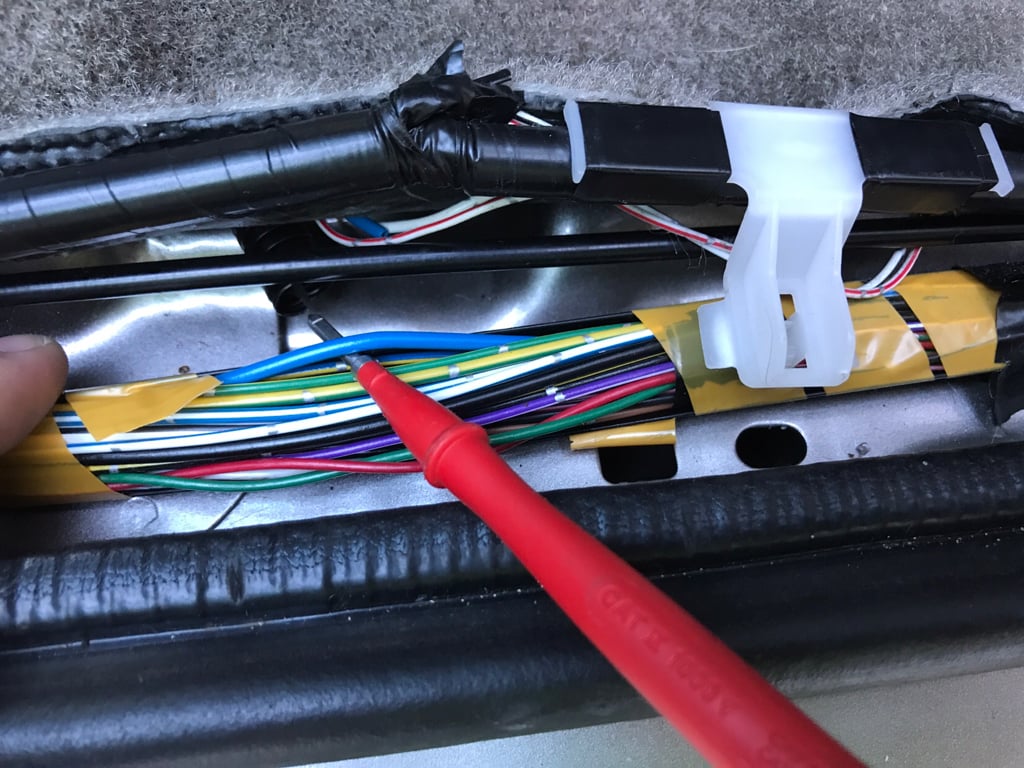

Finally got power to my new seats! The driver seat was in a fine position, so it wasn't a big deal to not have power for a couple weeks.

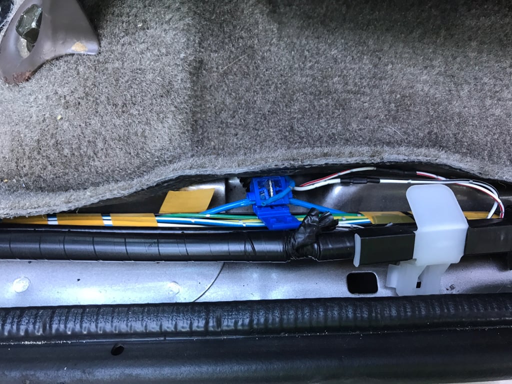

Pretty simple to do. Just find the larger gauge blue wire in the wire trough-

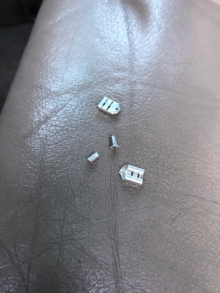

I HATE these things, and never use them. I bought them when I was feeling lazy, and just wanted an easy quick job tonight, so I went to use the damn POS-
Fortunately, it didn't work worth a shit. I didn't want it on my 4Runner anyway. And yes- it was sized properly to the wires being tapped.

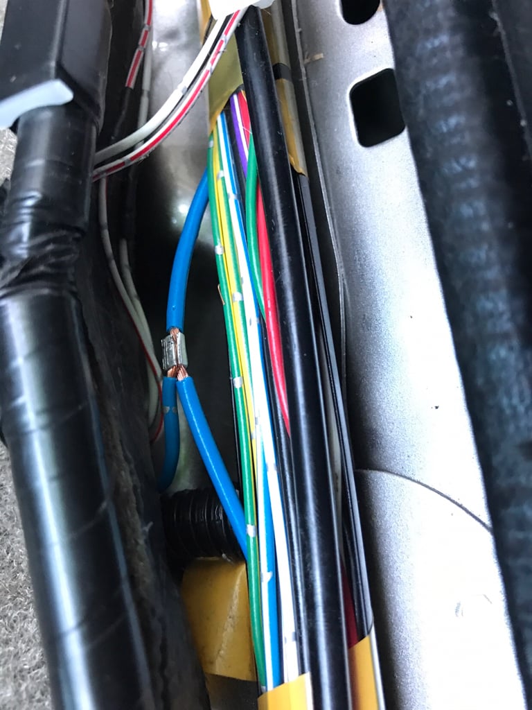

Stripped some insulation, and used a barrel I made. Now you know my secret-
The red was too small, so I ended up using a blue. You get the idea.
Much better connection [emoji1360]

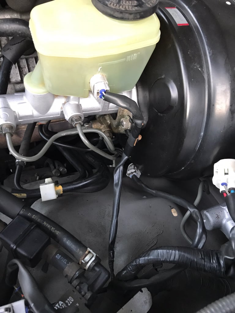

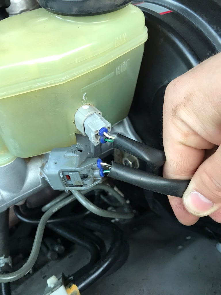

Also re-pinned my low res warning SW-
Tried to route it factory-like, but it's a little on the short side. Oh well.
I need to get a T100 booster and master. The brakes work awesome, but the pedal feel sucks.
I guess I could try the bigger 3rd gen master first, but I think the T100 will be better with the 231 calipers anyway.

I'm curious about your brake concern and will await your findings.

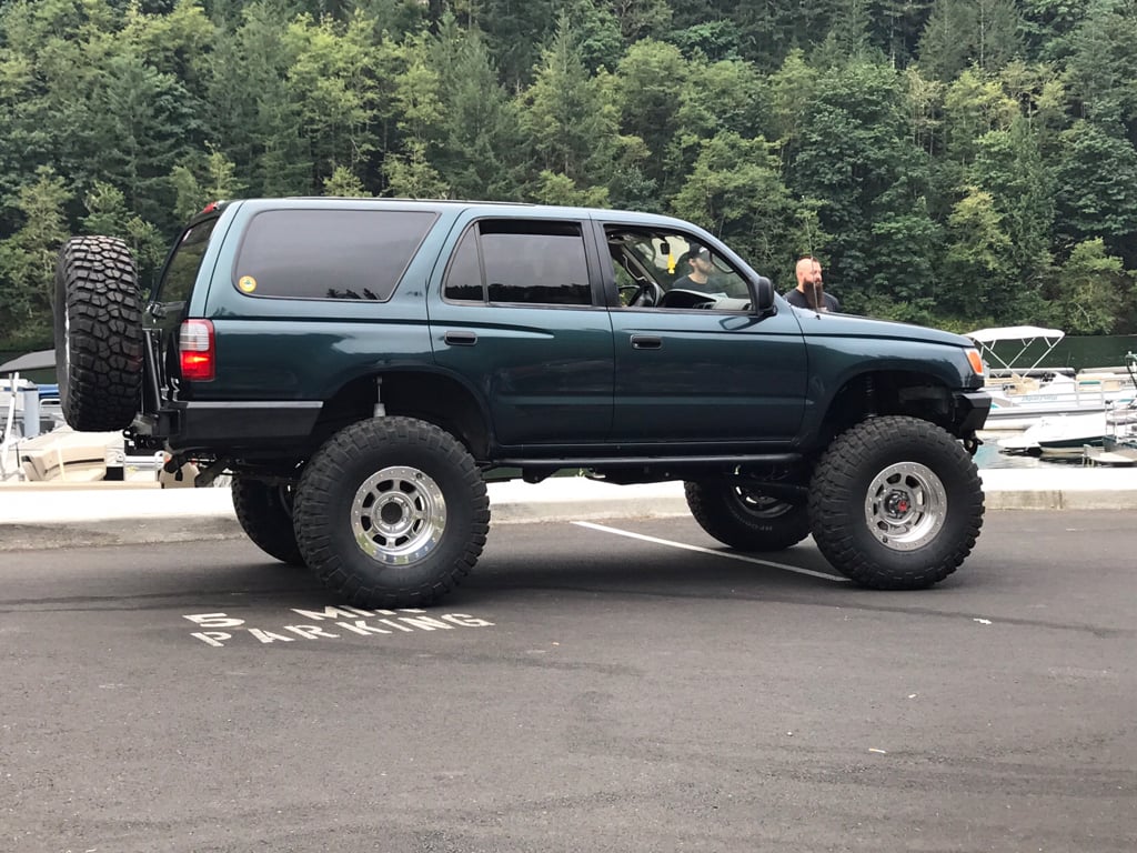

I'm more concerned why you are taking pics at almost 80mph! ;)
At least he got on the brake to take the pic! He was likely going 90+
before that. Steering w/ his leg, phone in one hand and a beer in the
other. Woo hoo!
Safety first right? :rockon:
other. Woo hoo!
And as 4Reak Show said.

I do tend to drive on the fast side, but the only moving violation I've gotten was for speeding when I was 18(I'm 30). I try not to be on my phone, and I don't drive like an idiot.

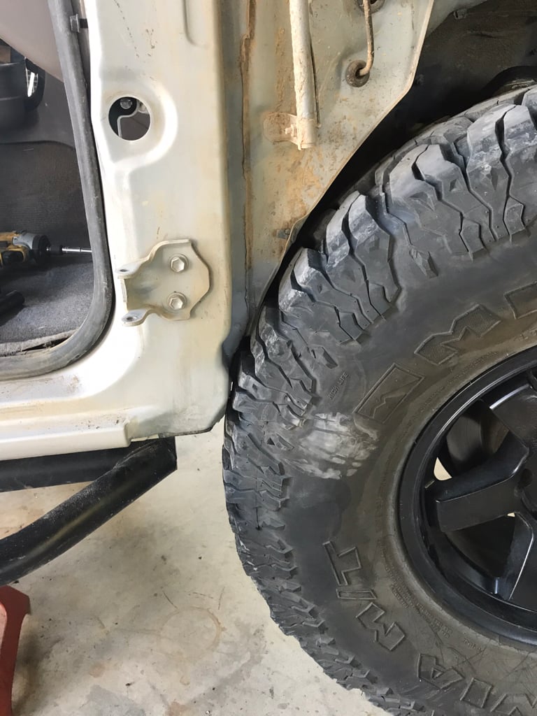

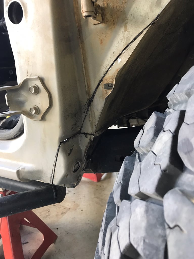

Hope he doesn't mind me sharing- I took a trip this last weekend to help a friend [MENTION=135317]rkntoy[/MENTION] make some room for his 35's. I was pretty excited to tackle the project, as it's been a long time since I've done work like that(10+yrs), and it was in my mini-truck days.

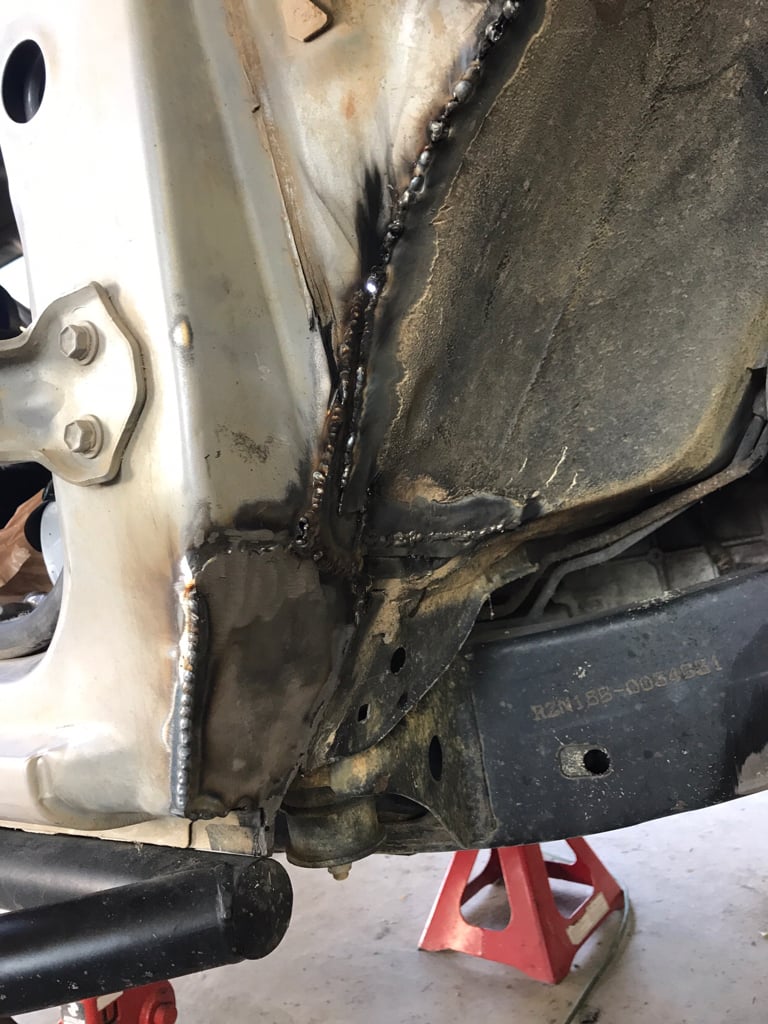

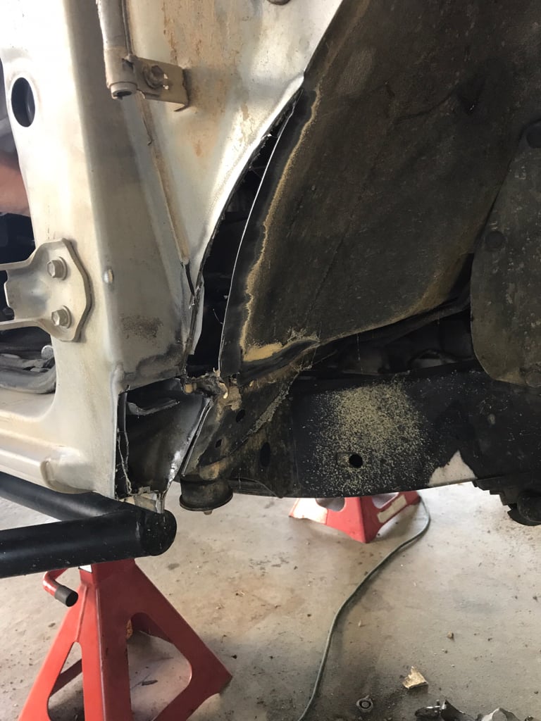

I was pretty stoked with the outcome of the tub job on his firewall. I've seen guys cut out wherever it rubs, and just build patch panels from there. I decided to keep as much of the factory firewall as possible, and just re-work it.
This is full bump, before any cutting-
How I cut it-
Notice I kept the body mount support, and just layed it back-

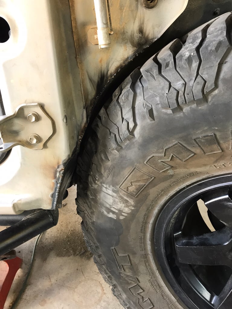

Please don't judge my welds*♂️ Sheetmetal isn't the easiest to begin with, and then we were having some feed issues after we swapped the .025 wire in from the .035. Anyway-
Ended up with about 1/2" clearance at full-bump/full-lock. That should be plenty- especially for a rig with a front sway bar-
I left him with some welding and sealing to finish, but we got the bulk of it done, and then had some killer pizza and brews before heading home(responsibly). I can't help but mention how cool Steve and his wife are. I wish I didn't live 2.5hrs away, but am still thankful I'm only 2.5hrs away! It's a beautiful area, and we hope to move there one day. Lots of places to go explore and have fun. Lots of snow in the winter too [emoji1598]
Thanks for sharing your work & pics. It's cool to see the different methods used to create room for larger tires. I think I remember reading in one of your posts that you just trimmed the front flare, fender liner and folded your pinch weld right? Do you plan on tubbing your firewall?
Yeah- there's definitely a few ways to go about it.
I need to tub mine for sure. It works for street driving and mild trails, but definitely needs tubbing for full clearance. Plus, it'll give me room for 37's and 40's later on [emoji12][emoji1598]
