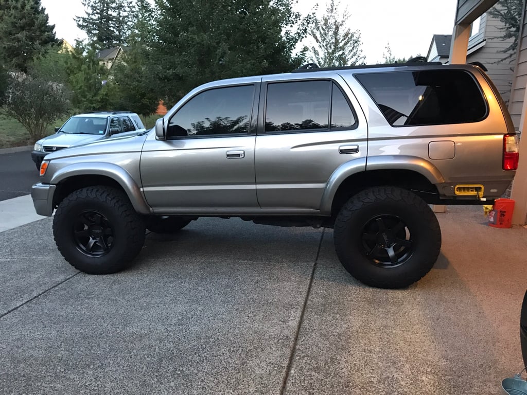

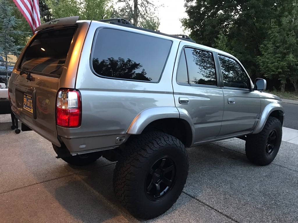

Tyler James Inc's Ultimate '01 SR5
SO STOKED.

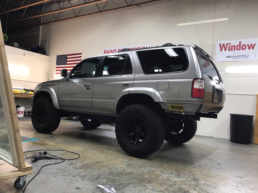

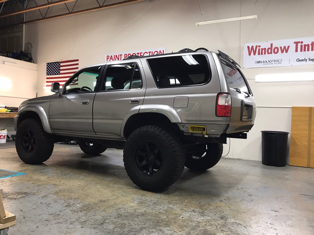

Finally did the fishbowl delete mod!
The dude I went to used to love SunTek, but SunTek was bought out by the parent company of Llumar(Eastman Chemical Company), and has gone downhill.
The founder/former CEO of SunTek started another company called Max Pro Films. They're dropping a new line of film that is ALMOST as efficient as ceramic at blocking heat, and matches the Toyota factory tint color really well!
He actually just had a sample roll, and I was his guinea pig for the new Element line.
It looks awesome.

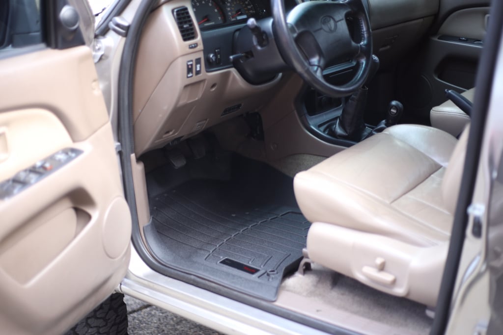

Something new: my wife got me WeatherTech's for our anniversary [emoji7][emoji1598]

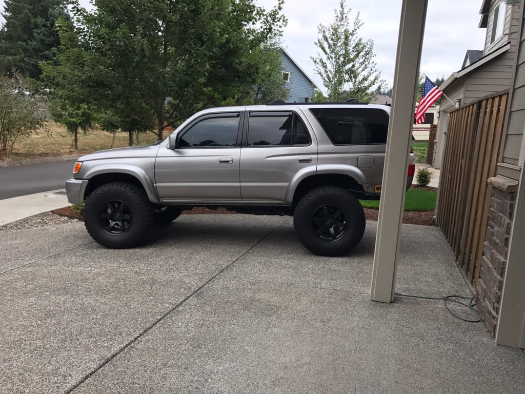

I know I've already said it but.. sexiest third gen I've ever seen. Keep it up.
Your 4runner is so clean, holy cow. These millennium silvers look great when they are clean and really make all the black hardware stand out really well. My 4runner's body is more of a trail body, lol. I am not sure that there is a single area on mine that doesn't have some sort of dent or dimple, pretty much ALL of which were done from the PO. I am always impressed when I come across a show class looking 4runner that has made it this far and looks as good as it does. Nice looking tint man.

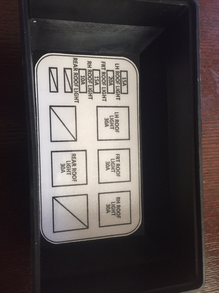

I installed a seperate fuse/relay box for my rack lights and even went as far as putting a laminated sticker diagram on the inside of the lid.
I was thinking how this might live up to your standards.
DUDE!!! That's so money [emoji1362][emoji1376]
Know what's even crazier? I just installed the same fuse/relay box in my buddies truck this weekend [emoji23]
Only pic I have-
Man, I'm super impressed with your diagram. Awesome work; guess we can inspire each other ❤️
Wow small world! It's a decent little Chinese box I thought. If your buddy wants a diagram it's easy for me to change the words and get it laminated. (I just found out if yuh laminate sticker paper, after you cut it out the sticker still works with the plastic covering it!) so let me know and I can make another one and mail it.

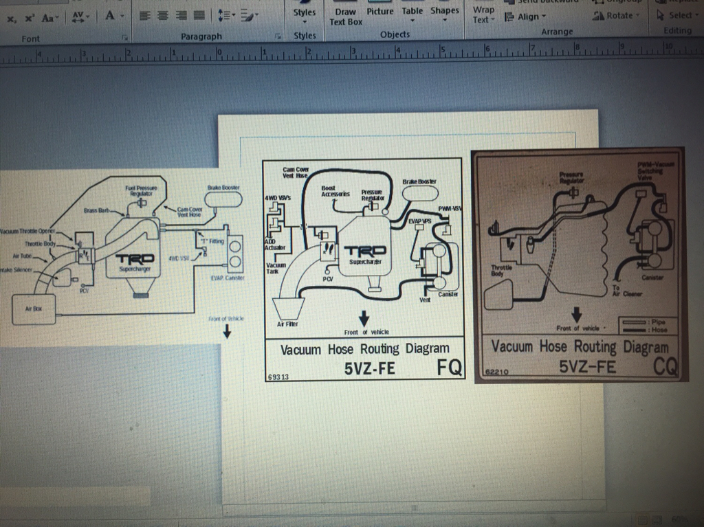

You think this is cool, wait until I make new under hood smog and vacuum labels to match the engine swap. Going for full factory look.
Well.... I work in Napa and let's just say I haven't been too anxious to go to work so I've had some time indoors.

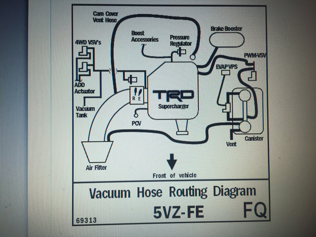

I told you I was working on the vacuum label. I combined a stock 5vz one from the Internet and TRD chart. You can see mine in the middle.
And since my 2nd gen is unique to say the least I had to add things like the VSV on the left side instead of the normal right side of the 3rd gens with this engine.
I just made up the little numbers and code on the very bottom. Looks stock to me!
Again, being anal retentive has its perks sometimes.
