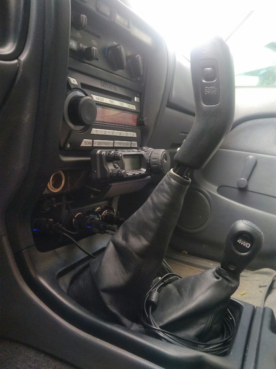

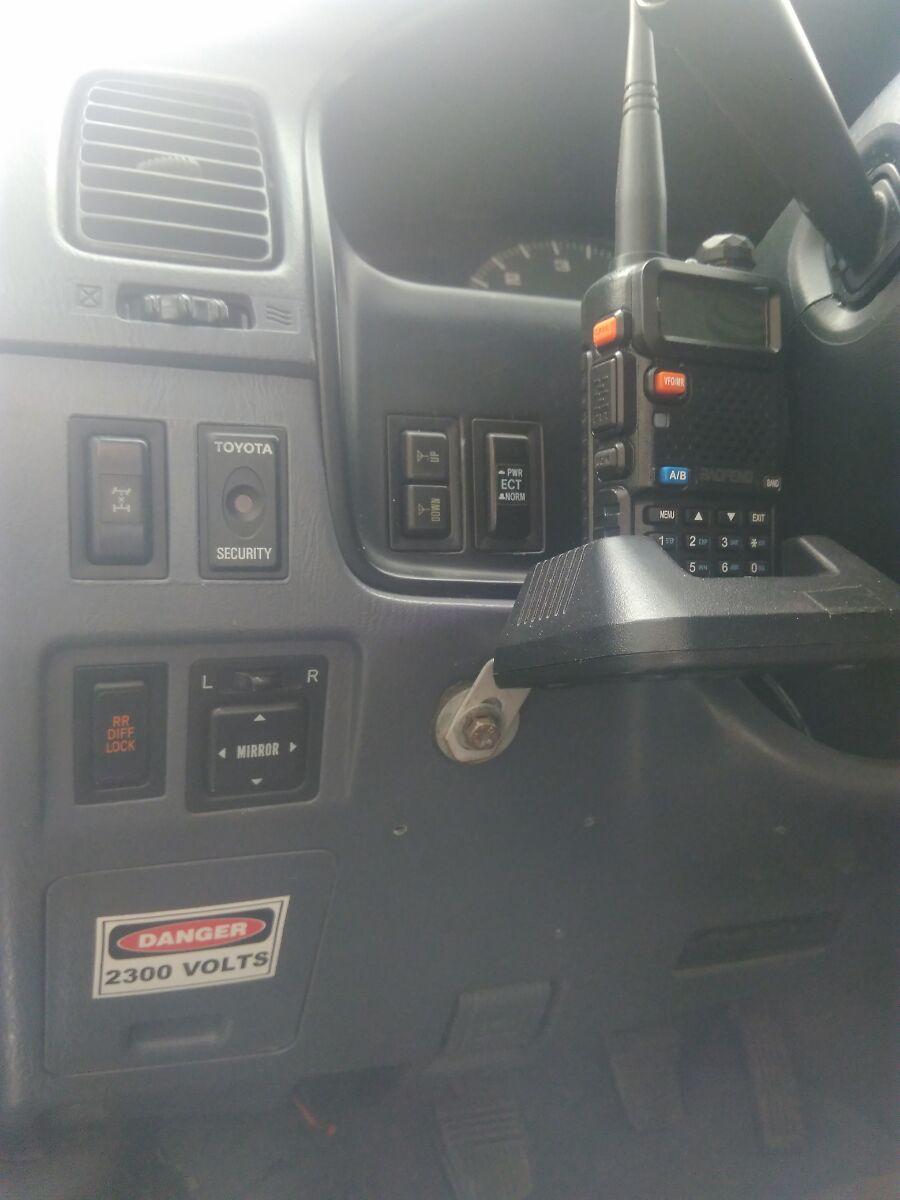

If you do decide on doing this, let me know and I will dig out the part numbers of the parts that you need in order to make this job appear stock made.
I did mine a while back and plan one doing in on another 4Runner soon, and will post a write up once done.
I am happy how it turned out and here are some pics of both levers, and the CDL button on the dash and the dash lights.
Hey, thanks a lot for the offer, and for the pictures. What do you mean the parts needed to make it appear stock? Will the multi-mode not bolt up and- work properly- behind the manual without issue? I was under the understanding the multi-mode wasn't incorporated into the auto trans. That said, if VSC/TRAC isn't functioning, maybe that would affect the multi-mode capabilities...
Why in the world do you have the auto shift lever on the manual shifter?!
Hehe I bolted the handle from the auto transm to the lever of the manual, as I use the OD button as a PTT for my ham radio, as a hands free, which is actually very comfortable. The mic is right under the sun visor.
The transfer will fit the R150f but its shifter originaly is bolted onto the transmission and the two shafts of the single mode Jshifter that protrude from the transfer enter the transmission to appear in the rear opening assuming that your transmission has the dual opening extension for two levers. This has to be done the same way when you bolt the multimode case to the R150f, othewise if you keep the the transfer lever bolted to the transfer opening, it will be another 4-6 inches aft of the manual lever in the cab where your cup holder is located.
The difference comes from the fact the the auto transmission is shorter than the manual one. Or so i remember.

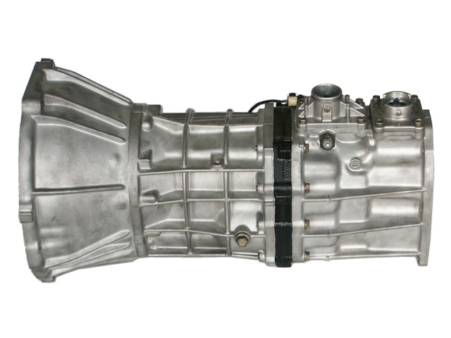

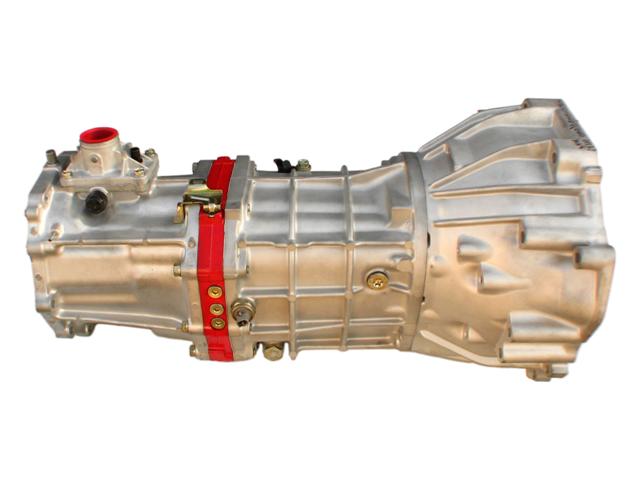

There are two extension housings for the R150 transmission. One has two openings instead of one which you can see in the pictures. I believe they are for 4wd and 2wd configurations.
In my rig, the lever opening on the original transfer case had a cover on it and the transfer shift lever was bolted onto the extension housing of the transmission right behind the gear lever.
I installed my new transfer case without cutting the pan an inch or so,as [MENTION=133074]anniesball72[/MENTION] mentioned in his post. I believe he was talking about lengthening the hole where the two shift levers enter the cab.
In fact, [MENTION=133074]anniesball72[/MENTION] can you show me a photo of how the two shift levers are positioned on your 4Runner? I want to see what is the location of both. And what engine you have.
Im trying to figure out if engine lengths make a difference in the levers position.

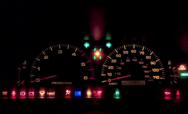

Since I decided to keep the multi-mode, I decided to do more cluster swapping. I went back to the '01 bezel to get the 4WD/xfer case lock indicators back. That meant I no longer had the PRND2L blanked, and I had to deal with that. I pulled the lens with the letters off, and pulled the backing off. Then I used electrical tape on the back of the backing to eliminate any bleed through. Used the PRND2L lens as a spacer, and put the backing up front. Looks factory [emoji1360][emoji1598]
It was also obvious the PO cleaned the cluster lens with sand paper- so I got a new one.
Old, and with the '99 manual bezel-
Finished with new lens! Now no PRND2L-
