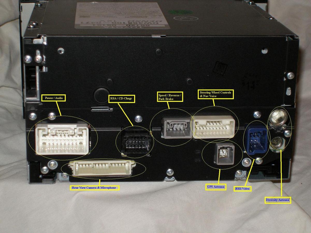

i have this saved for reference, its supposedly from an e7007 JBL nav unit. i cannot confirm or deny if its correct...
if it is correct, it appears that plug could be for a CD changer?
