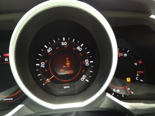

You'll have brakes but you won't have any ABS brakes,vsc ,trac or other electronic safety nannies that work in the background and we all have grown accustom to.You'll have to pump the brakes old school if you have to make an emergency stop. Not sure if the assisted braking works or not as I never tried that but I'm guessing not.The Toyota's shut them all down when it senses a problem in anyone of them. I couldn't even lock in the 4x4 when I had a abs wire problem. Nothing worked!

Unfortunately I don't have a way to pull codes or diagnose it. I have attached a photo of the dash light. It's only the traction light. I will work on getting some wheel well shots. I just wasn't able to get a shot when I tried. I will post some soon. Just to add to their trim job........well they didn't do a very good job, they still scrape. I don't even have to make a hard turn to have the tires scrape. Although I know that is to be expected until the lift gets installed.

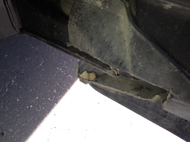

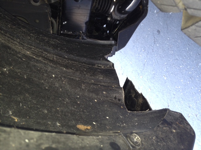

I have attached the drivers side front then driver side rear wheel well trimming done by the shop. Not very happy with this. Also I might point out that they did more trimming to the driver side then the passenger side. The drivers side flexes now and will rub because the wind pushes it into the tire.

I'd be pretty upset right about now if that was my 4runner...I forget if you mentioned this earlier, but did you authorize the trimming work? If not, maybe on top of having the check light fixed by the dealer, have them pay to put in new fender liners and whatever else they hacked up? I feel bad for you just reading this thread, you must be fuming :(

Oh my!They trimmed the rear!!! :crybaby: There's no need to trim the rear at all unless they thought you had rear wheel steering. I'm running 34's and don't come close to rubbing there .Are you sure your only running 33" tires.
The front liner could have just been located forward by relocating the holes in the liner,pushing it forward and reinstalling the screws instead of cutting too. It looks like they cut so much that you'll need new ones or else as you said they are will just blow back into the tire.You really need to read the mods sticky and ask questions before doing any more mods...............http://www.toyota-4runner.org/5th-gen-t4rs/87546-will-285s-fit-black-wheel-question.html#post759604
You really should tell us who did this so we can warn everybody else not to go there.
Also ,feel free to pm me or any of the other regulars if you need explanations or help.

Easy, Gary. That's the rear of the drivers front fender well. You can see the body mount there.

No the trimming was on the front wheel wells only. Not the back. I didn't explain this right. I think I am just going to get new liners and then I can fix what's been done. I honestly thought when they said they would trim them that they would only do a minor shave to the plastic.
