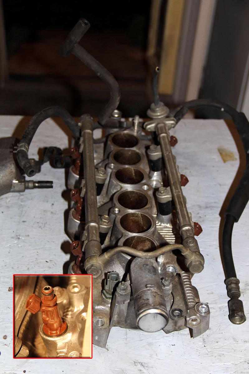

Here's a pic of the manifold. Have "cough... cough" fun! You got this. :thumb3:
Quick EDIT: The channel is in the lower left in the picture where the radiator hose goes.
