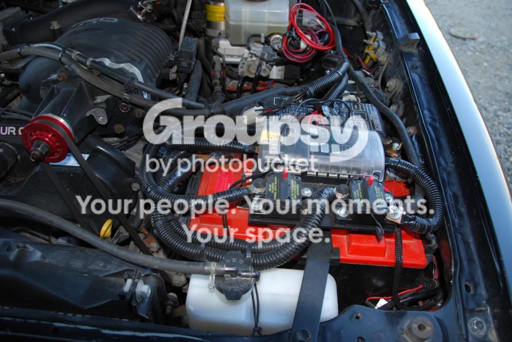

I recently added and upgraded some lights and have plans for a few additional electronic goodies. However, I wanted to clean up some wiring moving forward.

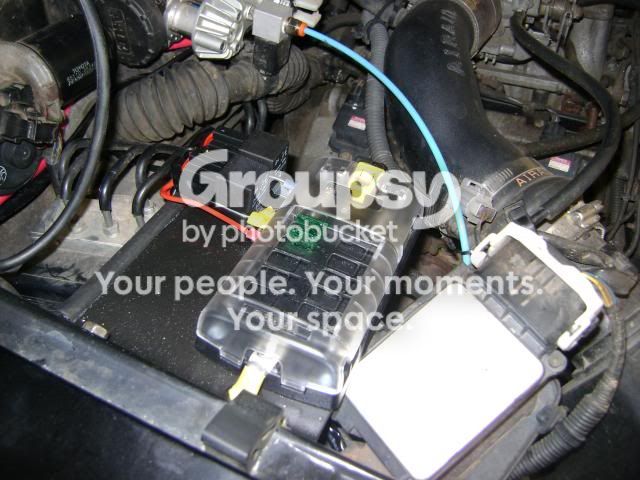

I added a Blue Sea Accessory fuse box. I originally wanted to add this on the drivers side firewall, though space is tight. Especially with the manual proportioning brake valve I added with the rear full float setup, and the EVAP box.
All this was based on an idea I remember seeing in [MENTION=63060]rickashay[/MENTION] 's build. Thanks!
There is much more room on the passenger side. I bent up a piece of scrap metal and used some existing bolts for attachment.
I've since added a few more things, but this pic gives you the idea. Fuse and relay management.

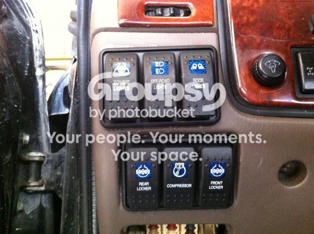

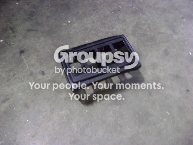

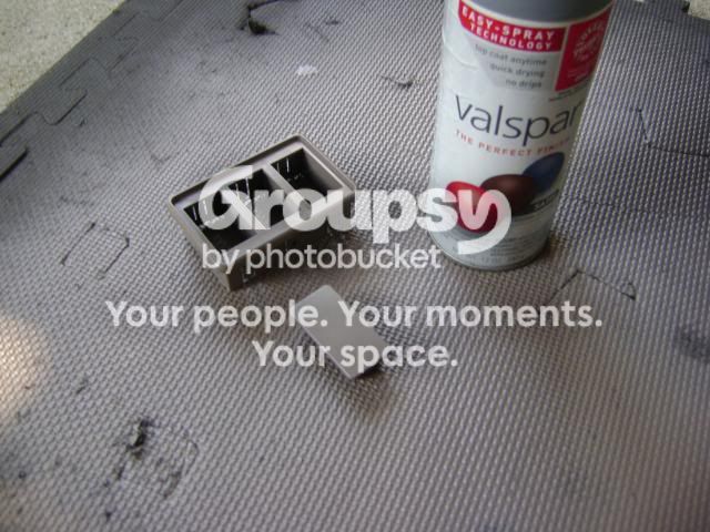

So, new goodies need switches. I don't need an ashtray, and my CB is in my center console. The ashtray is prime real estate. I made a fiberglass block in the same fashion I made the in-cab winch control box.
I used switch housings from OTRATTW.
I also expanded the 2 bank switch on the drivers side dash to a 3 bank panel. Also, I color matched it to the dash.
I've seen the 3 switch idea a few times and I can't remember where I saw it first. It may have been [MENTION=58830]JWaldz[/MENTION] but correct me if I'm wrong.
I tried to take a few pics of the finished product tonight but the flash was washing it out. I will take some daytime pics tomorrow.

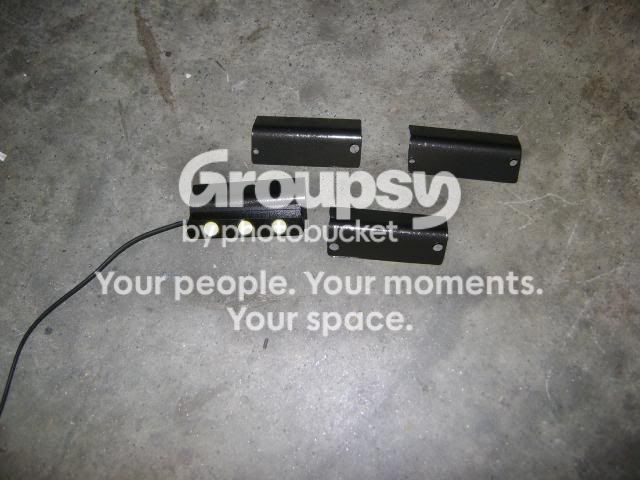

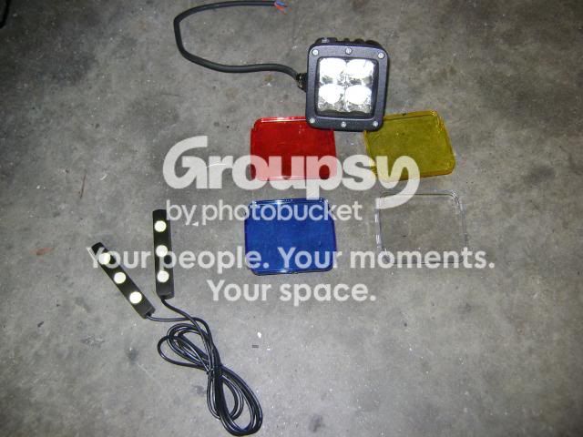

Some of the lights include 2x2 square LED's and some LED's rock lights. I went with a package from Olympus Off Road. If you order a pair of the 2x2's you get a pair of their 3 LED Rock lights pods. I added an additional pair of the rock lights to the order so that I could have a pair of rock lights pods on each side.
The 2x2's come with a clear lens protector, and yw, bl, rd filters. They snap on/off over the housing.

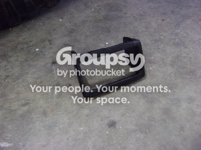

I cut some angle iron for the rock lights so that they shine down/out from the frame. I tack welded them to the frame on both sides.
I'm waiting on some pics from this past weekend's night run at Gulches Off Road. They worked well.

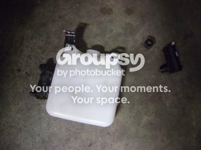

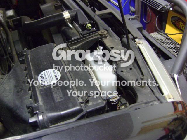

35's will rip out your factory windshield fluid reservoir.
I picked up a bottle and new pump from lowrangeoffroad.com.
I drilled an additional hole in the reservoir so that I could use both front and rear fluid pumps. I used the factory grommet from my factory reservoir. Seals perfectly. No leaks.
There is a nice little cubby just in front of the air intake. I made up some metal straps and mounted to the core support using existing threaded holes.

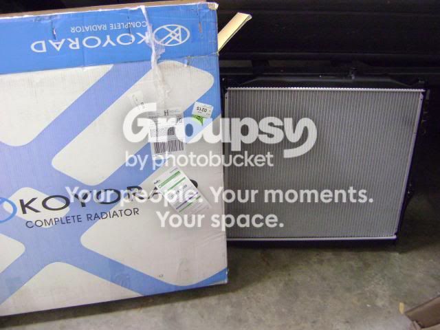

Also did some preventative maintenance and replaced the radiator.
Super easy. 1 beer project. This link was helpful:
http://www.toyota-4runner.org/3rd-gen-t4rs/115475-how-radiator-replacement.html
Replaced radiator hoses with silicone hoses, burped the system, then had another beer, since I was disappointed it was only a 1 beer project.

I used this one:
Universal Windshield Washer Kit, Pump, Reservoir, Lines, Switch
You can re-use your factory pumps if you have them. Otherwise this kit has a pump included. I needed a new pump since my tire damaged one of the factory ones. I've seen guys do this on the cheap with everything from a bike water bottle, to $10 Auto-parts store reservoir. This kit has everything you need, especially if you need a new pump.

Nice work, I've installed a 6" deck plate in to my air box so I couldn't place the reservoir where you did. Had to split it up in to two separate bottles connected by a tube. Seems to work out...

I did run a 100amp fuse (also from Blue Sea) in advance of the secondary fuse box. Did you also run a cutoff in advance of the factory fuse box? Hmmmm. That's not a bad idea.

My set up includes the 'Big 3' wiring upgrade so I've got a breaker (150amp) from the alternator direct to the battery, along side the fuse block which has the same style breaker in the 120amp flavour.
The Bussman breaker is great as I can just flip the lever to whichever position I need - off if I am working on the truck etc.
