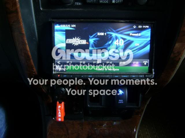

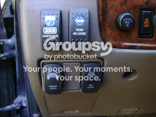

Here are a couple pics of the dash. Color matched housings and custom fittings for in-cab winch control and 4 switch bank. I still have a few blanks to fill, but I should have 2 to 3 spots available for future goodies. [MENTION=98812]shouldbeasy[/MENTION] that is a good idea to expand the factory top 2 switch to 3.
Thanks!
