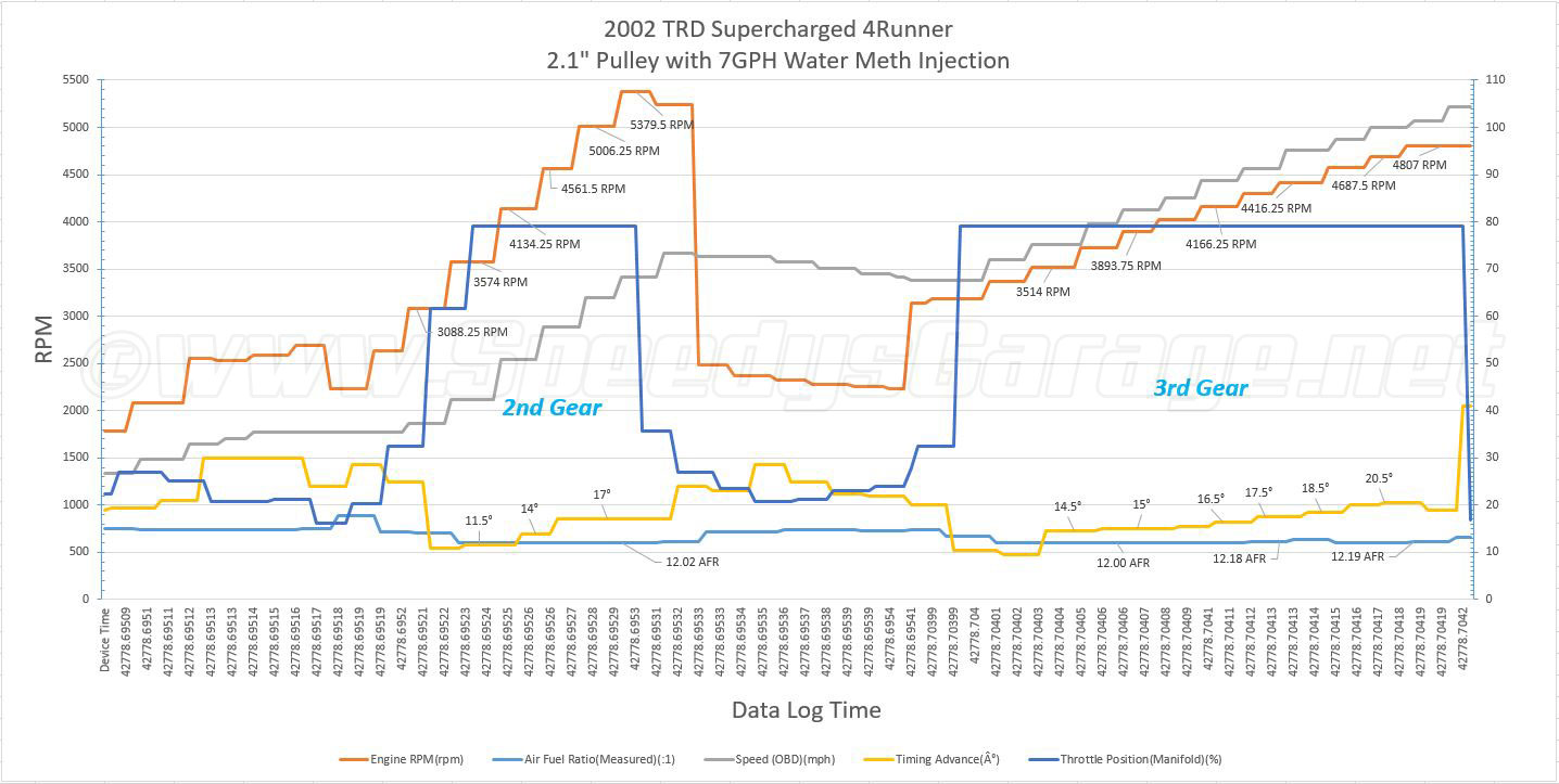

I also use Torque Pro and there is a PID for Ignition Advance, that's your timing. You'll want to log that with RPM, MAP, TPS, and I think I also did MPH. You can then export the data to CSV from Torque and put it to an Excel file to create a graph. Kind of a PITA, but he only way I've found to get a good look at what's going on. I think I made a post about it in my water/meth thread linked in my sig with some screen shots.
I'm using the URD 7th injector with MAF calibrator or whatever it's called that manipulates part throttle boost enrichment and I found it very easy to setup and tune. When I added the water/meth I had to just about disable the 7th and was able to completely zero out the timing map. With your lager injectors you'll just have to play with it to find the sweet spot, but you'll know when you're there. The truck will pull like you won't believe.

Yeah, Torque's interesting, but I'm not aware of another package that'll give us what we need. On my other rides I use a really slick tool that logs everything and displays it real time, graphs on the computer, the works. Wish we had that for these trucks.
I never could get the "email log" function to work. I had to connect my mobile device to my PC and go find the log file and copy it over. Then the fun of trying to make it look right in an Excel graph. If you get a log and want to email it to me I can try to look at it and tell ya what I see.
Here's one from mine as an example. Look at that timing :)

Oh geez, that's a bit of work. I'll give it a try though.

2nd gear would give you a decent readout.
