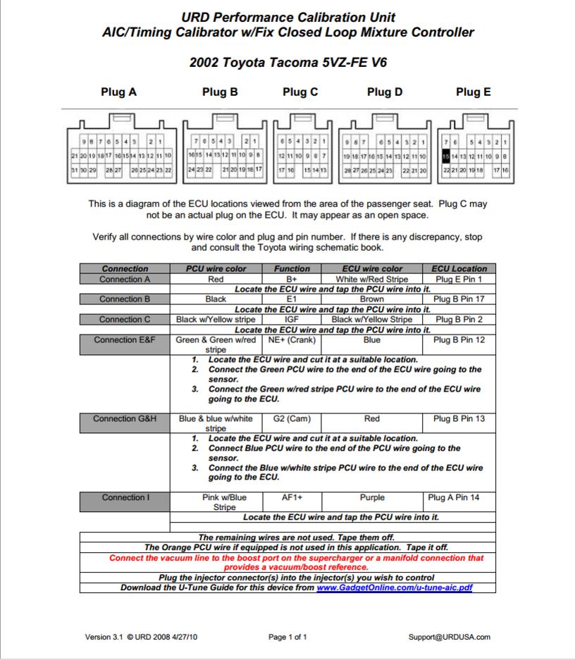

Does anyone happen to have the URD wiring diagram for a 2002? I have a note into Gadget, but I've not heard back yet, so I'm turning to the forum.

Attached wiring info for a 2002 Tacoma...
I only have the pinouts for the 2000 California and 2000 Federal Emission models, sorry.
Could you perhaps upload those? If they're the same as the 2002 Tacoma I uploaded (which is the same as the 2004 Tacoma I also found..) they could possibly all be the same past say 1999?

I will, but want to caution people that these wiring diagrams are very model-specific. 96-98s are generally different from 99-00, and 01-02 are different yet. Then there are California emission vs Federal.
Here is the diagram for the URD Additional Injector Controller w/the timing calibrator for the 2000 V6 Federal Emission model--->LINK
AIC-T for what I think is the California models--->LINK
Well theoretically he could use your pinout to get the function codes, then cross reference the FSM for a 2002 to get his correct wire colors to tap into...
Let me see if I can find that for him...

If I were you, I would follow the install instructions for the 2002 Tacoma. Of course I am not
Cross-referencing those instructions to the wiring diagram of a 2002 4Runner, the wires providing the function outlined in the instructions are the exact same... Color, pin location, everything.
EDIT**
The only difference is the color of the wire for AF1+. Tacoma says purple, 4Runner says white. Location is the same, however.
Awesome, thanks!

Any chance anyone can confirm this with their recent purchase of the 7th injector kit for a 2002? ...they forgot to send it with mine and I would rather not wait until sometime next week for URD to get back to me.
Confirmed. Just used this the other day. I would highly recommend getting in touch with URD however. Apparently they now have a harness so you don’t need to cut into your ECU.
