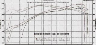

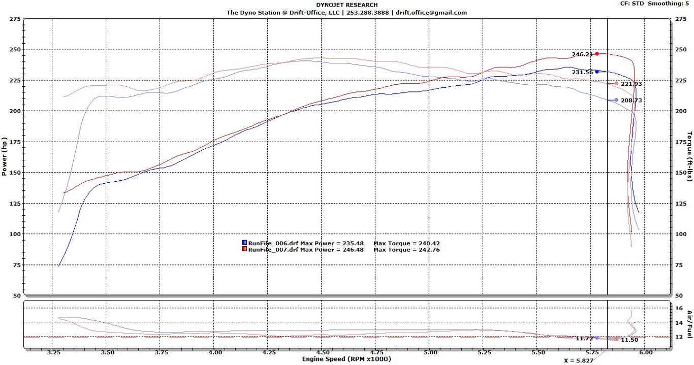

Dyno is up. I was running late today so there was no cool down time prior to this run. Went straight onto the Dyno after driving 40 miles hard in 93 degree weather.
They sent these over which includes one of the baseline runs. I will try get them to superimpose the original runs posted in this thread. WOT starts way too late on the baseline. But at least it's something you guys have to compare for the time being.
Am I reading this right?
At 4000rpm you get an extra ~50hp and ~50ft/lbs?!
I wish! The tech ran the truck at wide open throttle on the baseline run after 4200 rpm. It's not ideal and you should ignore everything before that point. I don't know why they chose that run as the baseline but they were very busy and that's what they sent over, (probably picked the first baseline run they had on file and didn't look through the rest). I will get them to superimpose the runs I posted earlier in this thread.
No too shabby. About a 10-15 gain in tq in most places. Using generally accepted drivetrain loss... that would be around 290hp at the flywheel.
I will post a more accurate comparison for you folks once they send it over. Attached to this post is the original baseline I posted a few pages back. Just looking at specific points under 4000 rpm and comparing them with the run I just posted, you can see there is some gain down low as well.
Not exactly 100% accurate but it gives an idea of the gains vs stock. Pretty decent gains, I'm impressed.
Thanks for superimposing the graphs. This is good for a rough eyeball but as you can see the rpm lines don't quite line up. It is appreciated though. Hopefully they will get back to me on Monday. I asked them to drop the cursor once below 4k rpm, once mid curve and once at the top so we can get a better idea of the difference.

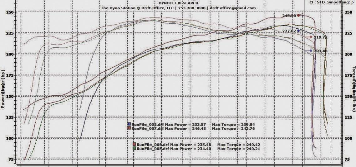

LOL... Got tired of waiting for the supercharger and traded in the 4Runner. Deleted all attachments out of respect for the new owner.
Will attach the Dyno here.
