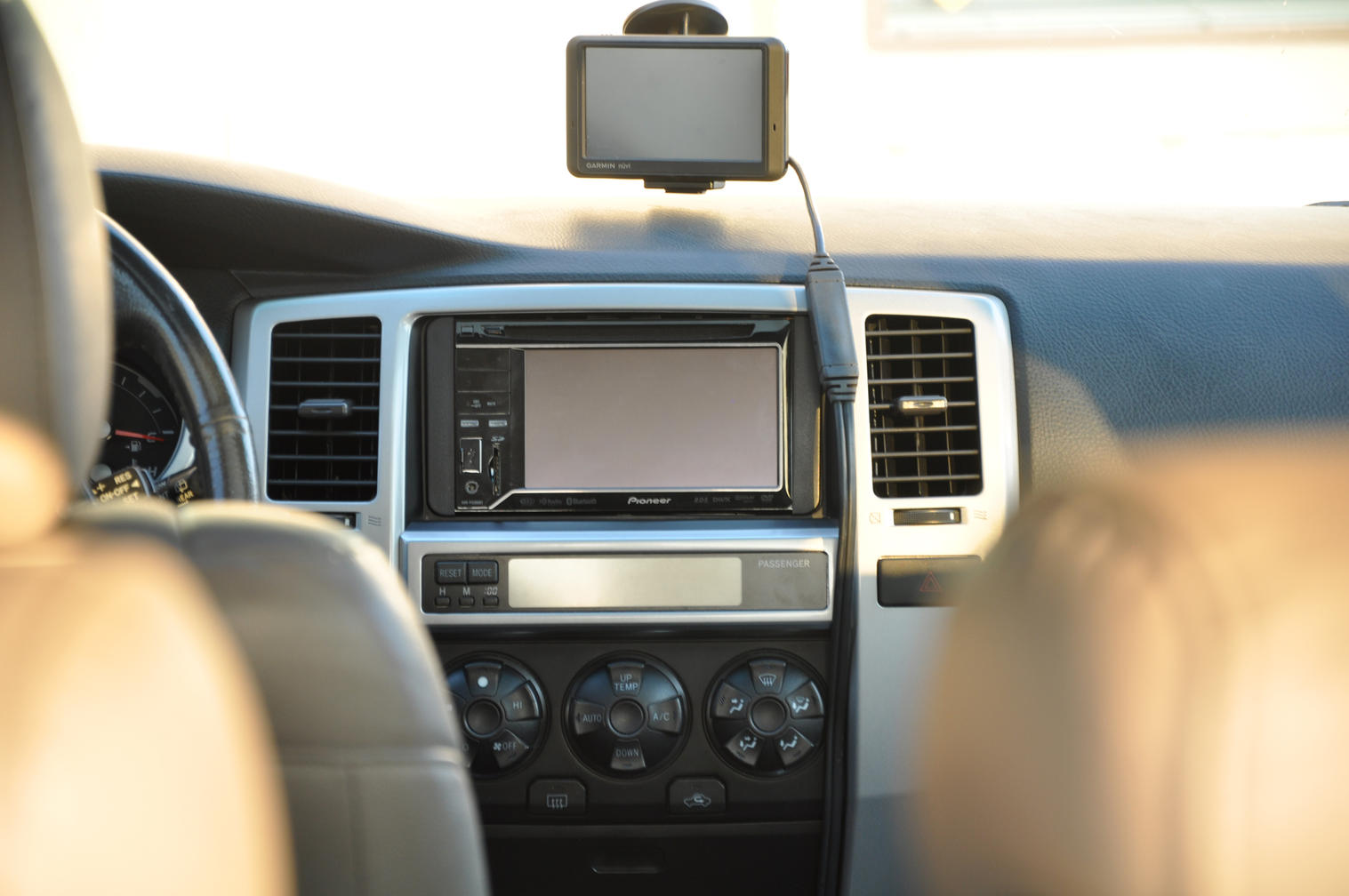

The sound is incredible compared to the stock unit (i had the non jbl system) I have my first gen ipod touch hooked up to the pioneer unit via the usb cord and all my songs are lossless audio (.flac) so they are around 1000 kbps compared to the standard 126-320 kbps you get with .mp3. You will definitely notice a difference! I'll post a pic of the unit later today when i get back from work.
(before installing this unit, i had my ipod hooked up to the tape deck using a cassette tape with a cord that went to my ipod. Never got the full audio experience with that so this pioneer unit blows my previous setup way out of the water!)
I'm also planning on getting two headrest with the screens in them and possibly hook up an xbox 360 to it, but i'm still trying to figure this one out. I have a thread i started on that topic here: http://www.toyota-4runner.org/4th-gen-t4rs/91473-headrests-screens-them.html I'm hoping that doing the bypass wont interfere with this kind of setup. I might not be able to bypass if im hooking up extra screens to it, but im not so sure.
Just a quick picture i took of the pioneer head unit 3300bt. I got two headrest with screens on the way that will hook up to this. Performs way better than the stock radio! Thanks for all the help guys!
By the way, if anyone wants to follow my quest to install the screen headrests that thread is here: http://www.toyota-4runner.org/4th-gen-t4rs/91473-headrests-screens-them.html

That's a nice setup, and you got the dvd button which is a nice touch! These units are very nice and i'm very happy with it. :bigok:
