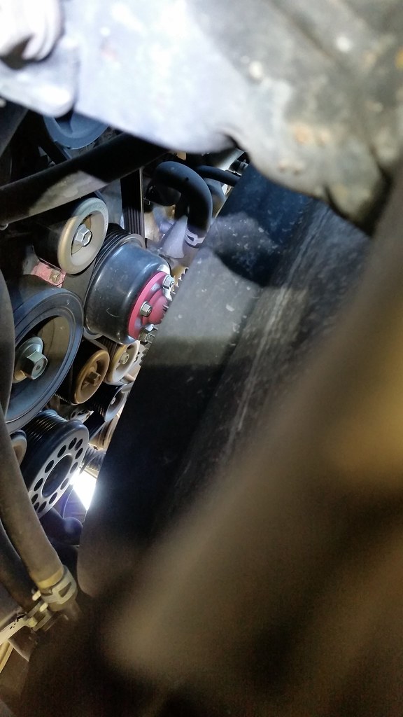

Got under the truck today and took some photos. The water pump leak doesn't look too bad, coolant level drop a bit in the reservoir very few months. Bought the ASIN pump, probably do it after Christmas

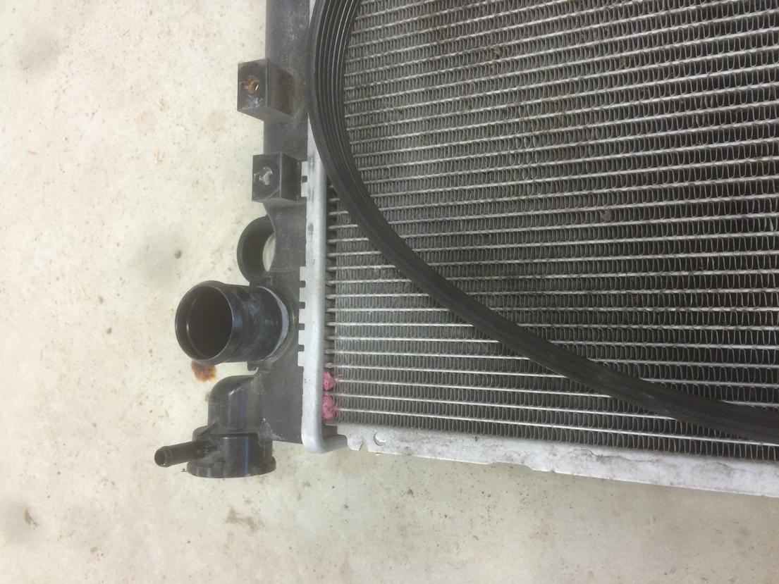

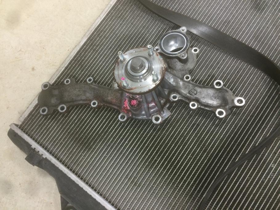

Just replaced mine on my 08 last weekend at just shy of 89,000 miles. The water pump was weeping slightly, and the radiator had a real mild leak to it as well. From what I read, it's not all that common -- but also not uncommon either at ~89k...
