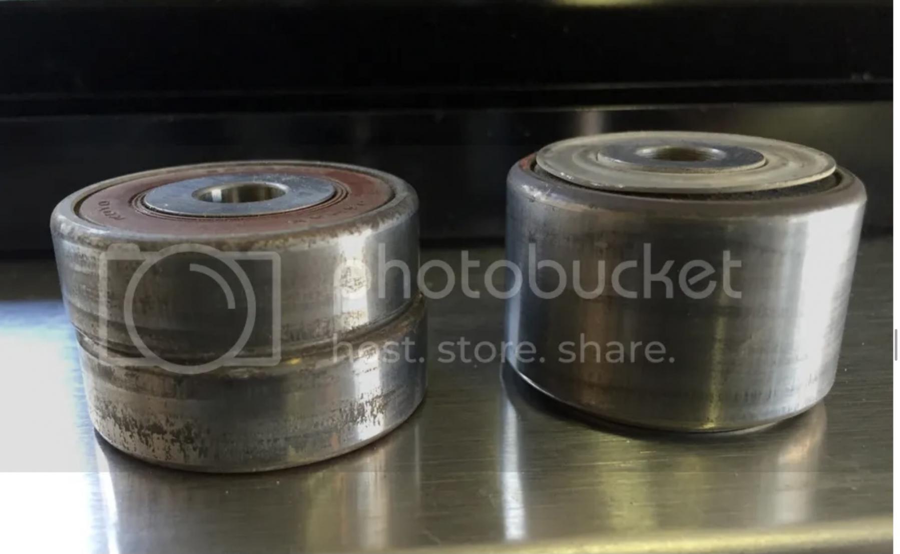

Many, me included, just change the pulley if there's nothing wrong with the tensioner itself. You can either press new bearings into your current pulley or do it the "accidental" way I did - I bought a kit with the tensioner and the other pulleys then figured out, the same way you did, how much of a PITA it is to replace the whole part. Fortunately, the pulley and bolt off the new tensioner went on with no issue. I considered returning the kit and buying individual pulleys but no one sells one for the tensioner (that I could find at least) and the cost would have been about the same anyway. In fact, I'll send you my old tensioner pulley if you want to press new bearings into it. There are some threads where people talk about what bearings they used and so on. I didn't want to mess with it.
I did the same thing, took the new pulley wheel off and installed on my tensioner.

The tensioner itself rarely fails. You can just replace the pulley. Febest 0187-GRJ200 pulley appears to be a direct replacement for the tensioner pulley. I just doubled up the 6203 bearings in the original pulley after cleaning and painting it.
4runner and FJC share the same engine, pulley replacement
