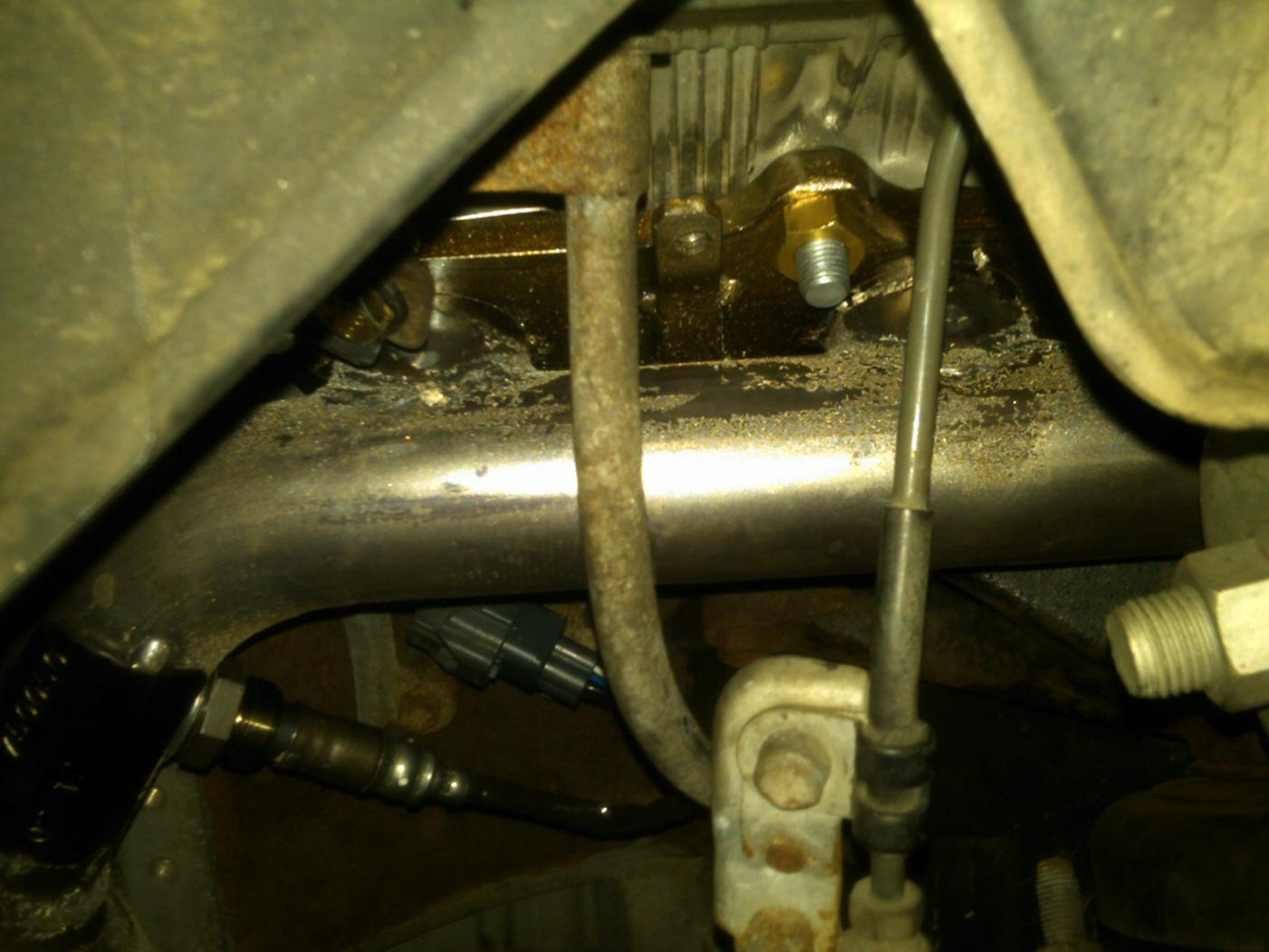

Here is a pic of the new installed manifold.
Note the heat shield was destroyed in the process. The guys at the exhaust shop said it fell apart when they took it off. I'm debating whether to get a new one or not.

I ordered the Toyota heat shield and it arrived today. What a PITA to install that thing! I got it on and it fit like a glove over the PaceSetter aftermarket manifold. The part was $50. All else is good in case anyone is looking to do this mod.
