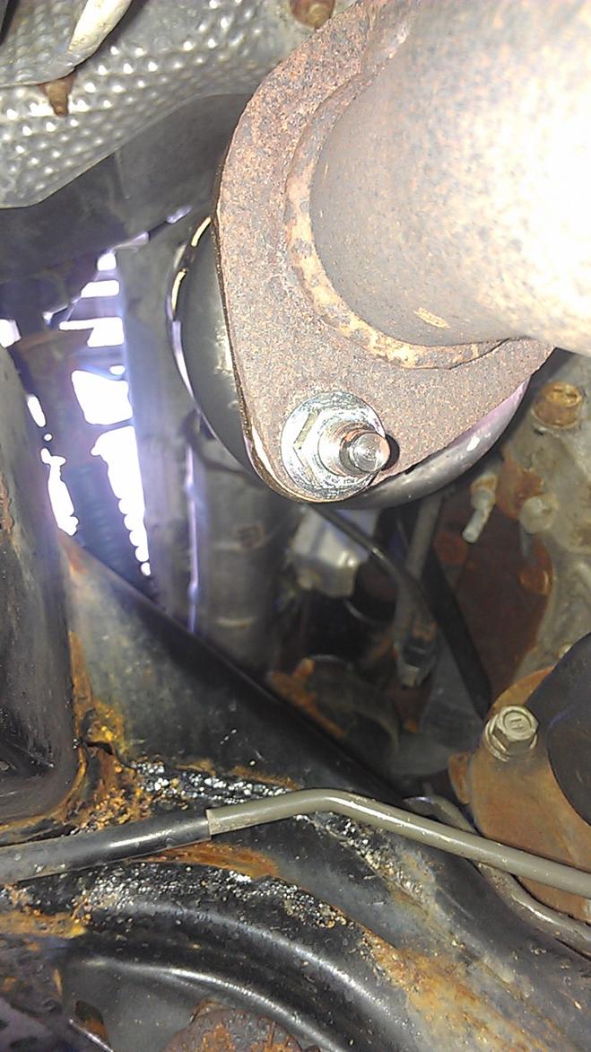

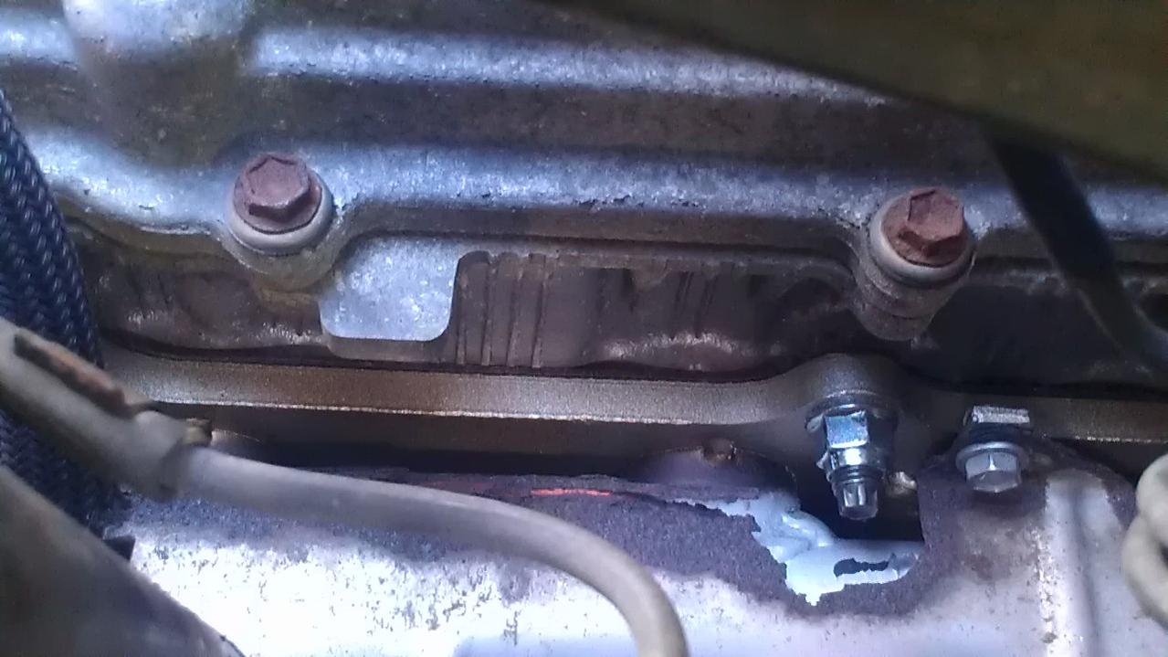

Dealer spent about 3.5 hours on the drivers side. The Pacesetter manifold is much higher quality than OEM. 4R is quiet again at the engine even when cold and I'm happy as can be. I hope the passenger side manifold doesn't crack next. :wacko: But if it does I know what to fix it with. $232 each from amazon.com you can't beat that with a stick.
