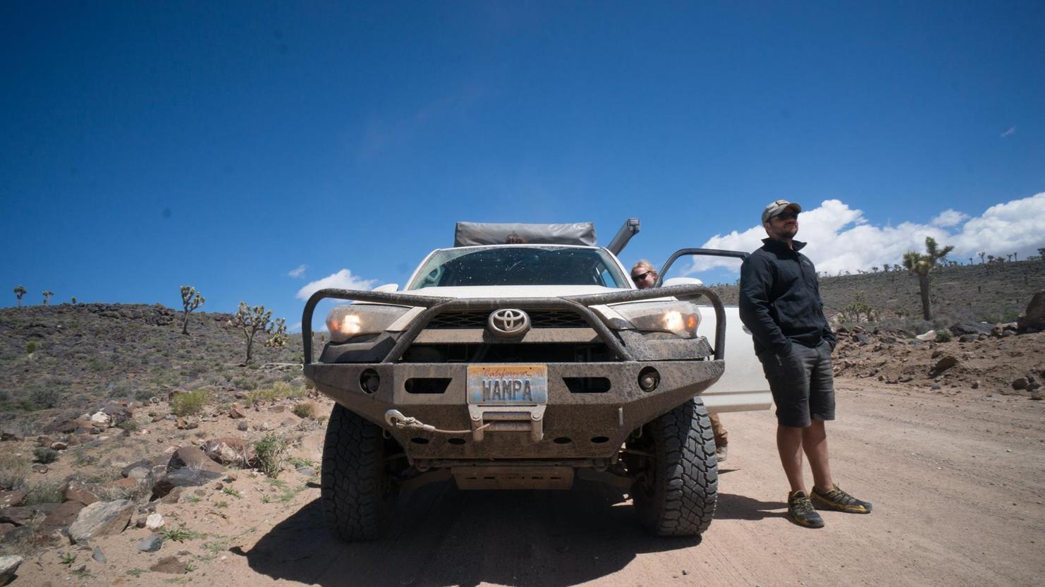

Suspension:
Radflo 2.5 Front, 700lb springs
ADS Rear, extended travel
Dobinsons C59-749V Rear Coils
Total Chaos UCA
Sonoran Steel Track Bar
Eimkeith PCK
CaliFab Offset Rear Links
All Pro Extended Brake Hoses
Toytec 2" rear bump stop extension
Armor:
4x4Labs Front Bumper
4x4Labs Rear Bumper
4x4Labs Sliders
RCI Full Skids, aluminum
FJ Toyman Rear Shock Skids
Other Installed Electronics / Hardware:
South Bay Driveline Double Cardan Rear Driveshaft
SCS Ray 10 Wheels
Bora 1.25" Wheel Spacers
315/70/R17 Mickey Thompson ATX P3

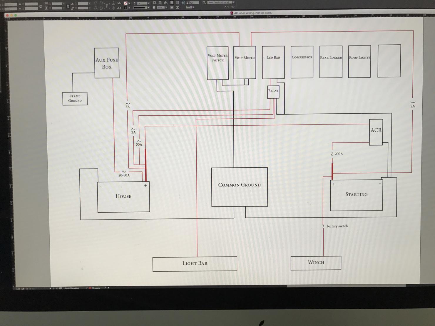

Shrockworks Dual Battery, Secondary Air Pump and Washer Reservoir Relocation
Blue Sea ACR Battery Relay
Batteries Plus X2 Power AGM Battery
ComeUp Seal 2.0 9.5k Winch
ARB Safari Snorkel
Baja Designs OnX6 30"
TRS Morimoto HID Headlight bulbs
Hella Micro DE Fog lights with TRS Morimoto Retrofit
Gobi Stealth Rack
Rear diff breather extension
Accessories:
ARB 2500 Awning
ARB Refrigerator
ARB Refrigerator Extended Slider
6 Button Switch Panel
Tepui Kukenam Sky

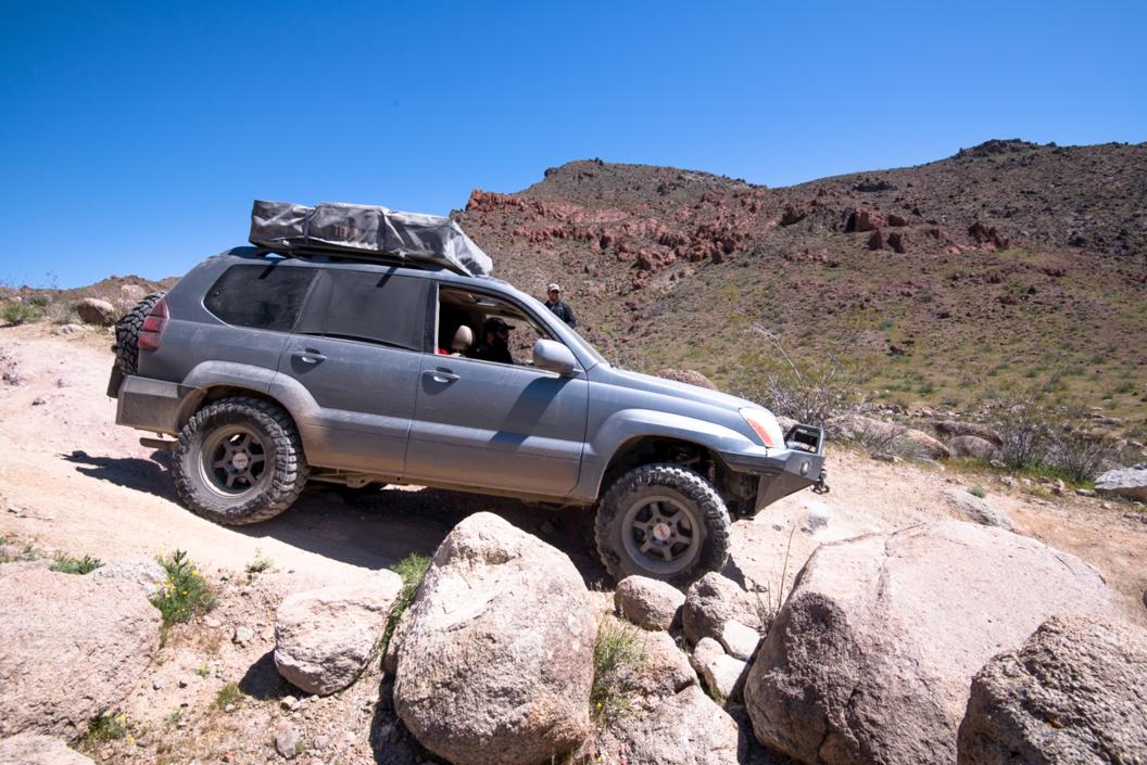

Here's my old 4Runner, keeping dogs cool in Todos Santos apparently.

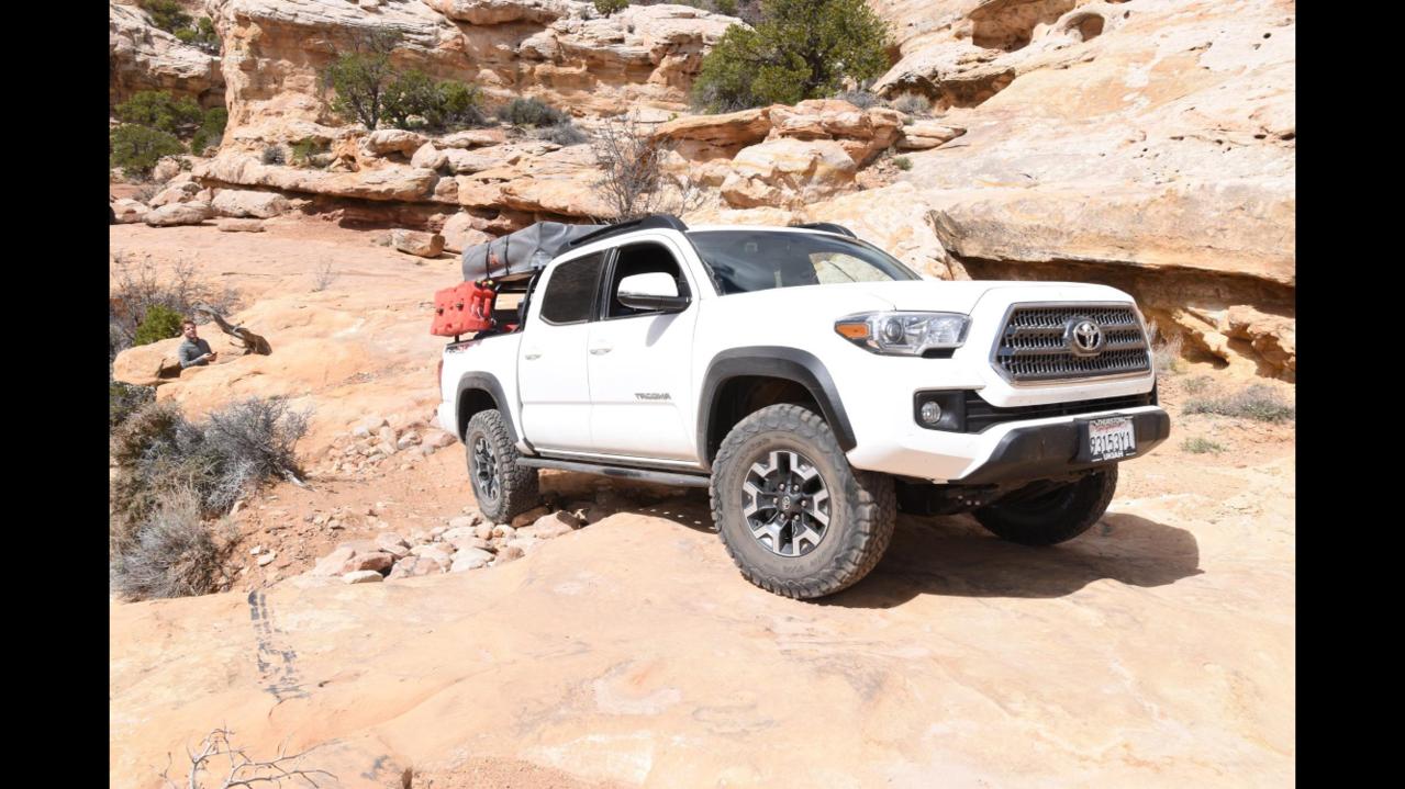

3rd gen Tacoma I owned for a few months, sold it back to the dealer for less than 1k than I paid for it. Great truck but didn't fit my needs. Some dudes on the Tacomaworld forum and craigslist got a great deal on the AllPro sliders, bedrack, and KO2 tires I had bought for it already.

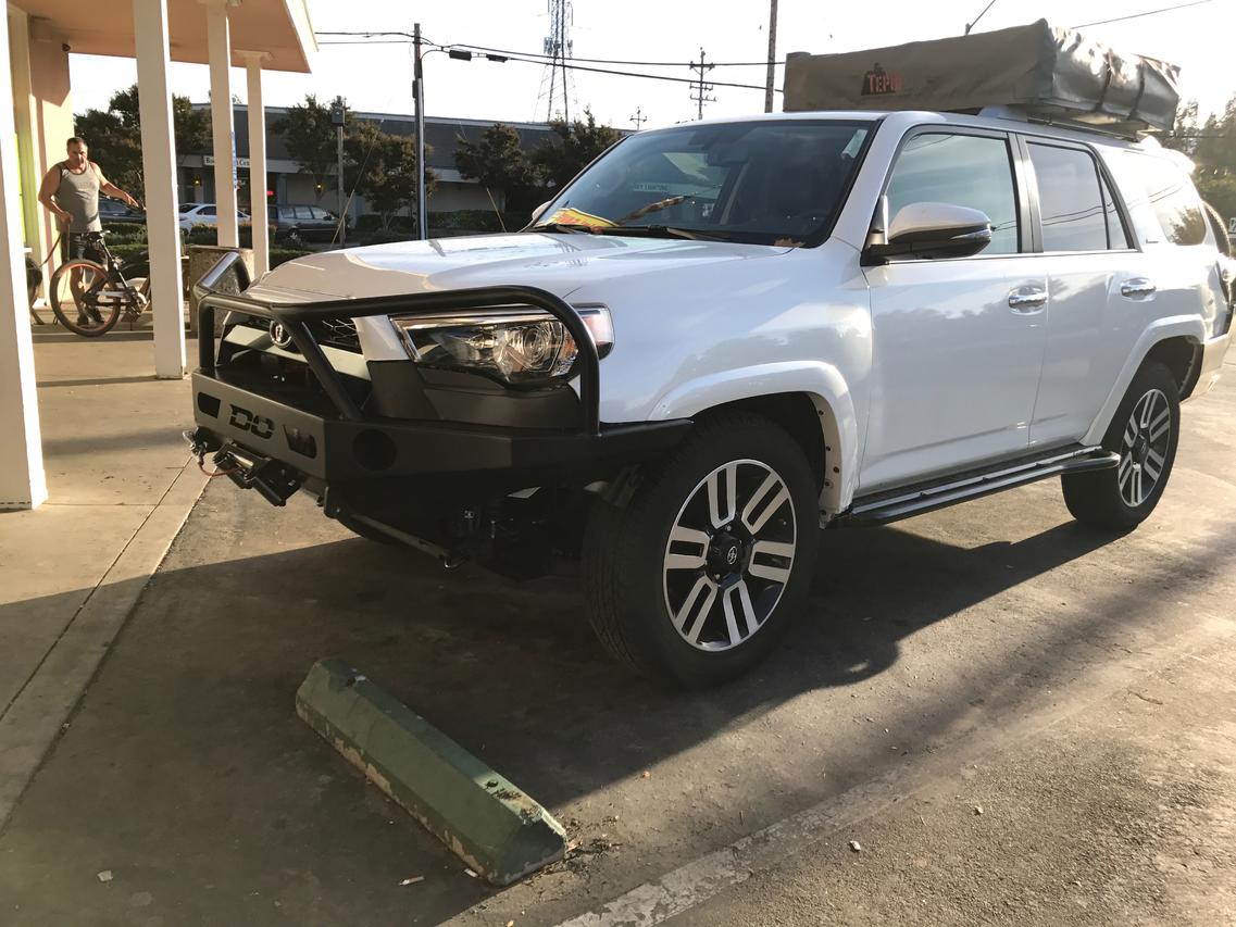

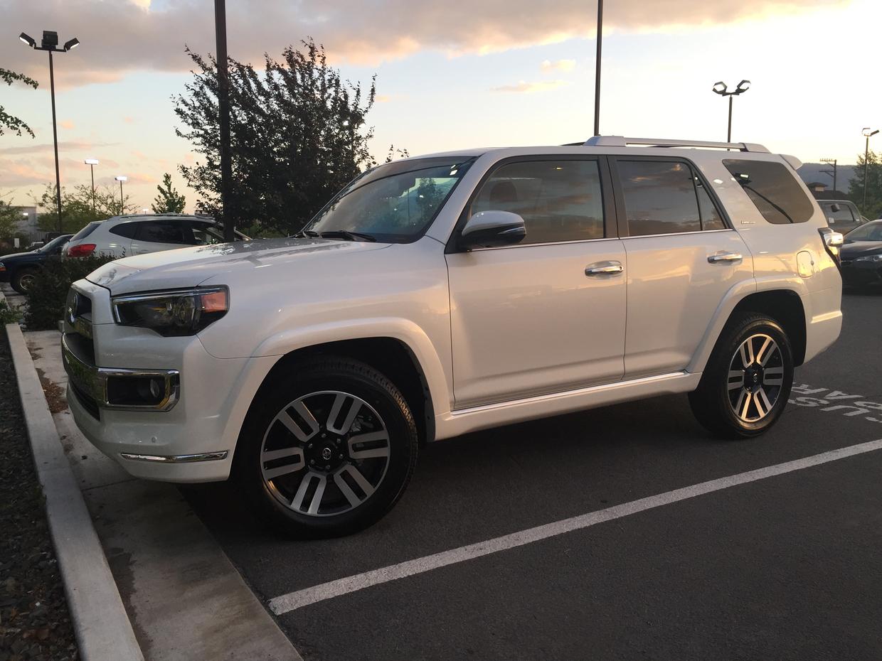

Current 4Runner when I took it home, plus a few shots after getting back from 4x4Labs for a rear bumper and sliders, maiden voyage out to Sequoia National Park, and my pup Jasper keeping guard while I do some work around the yard.

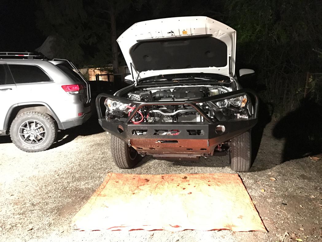

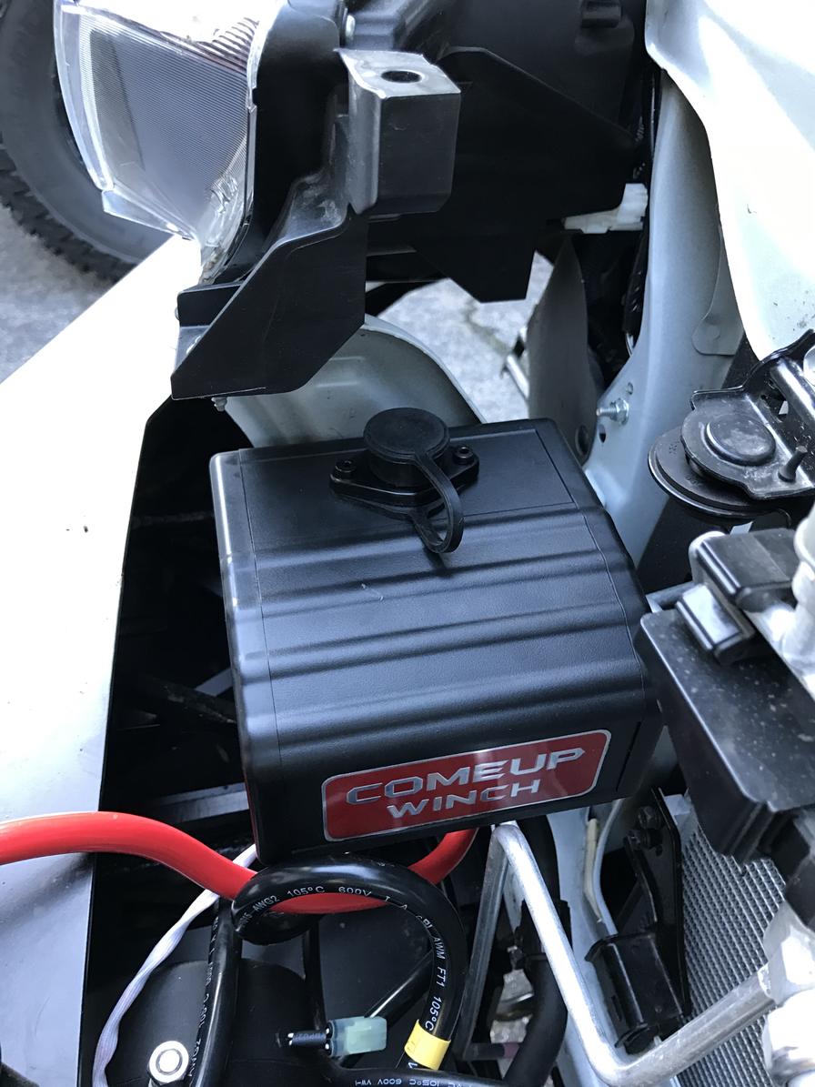

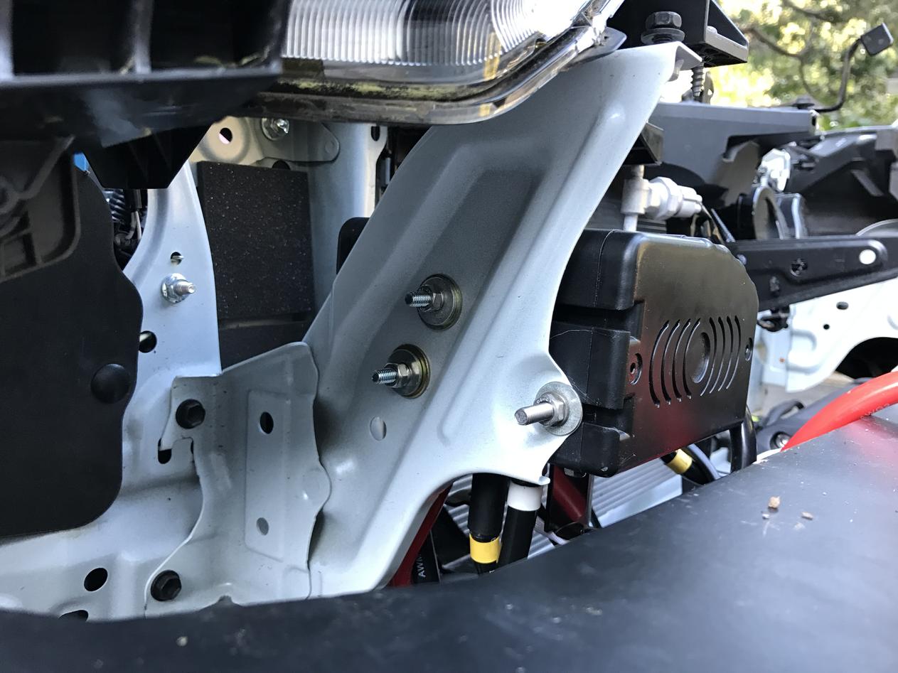

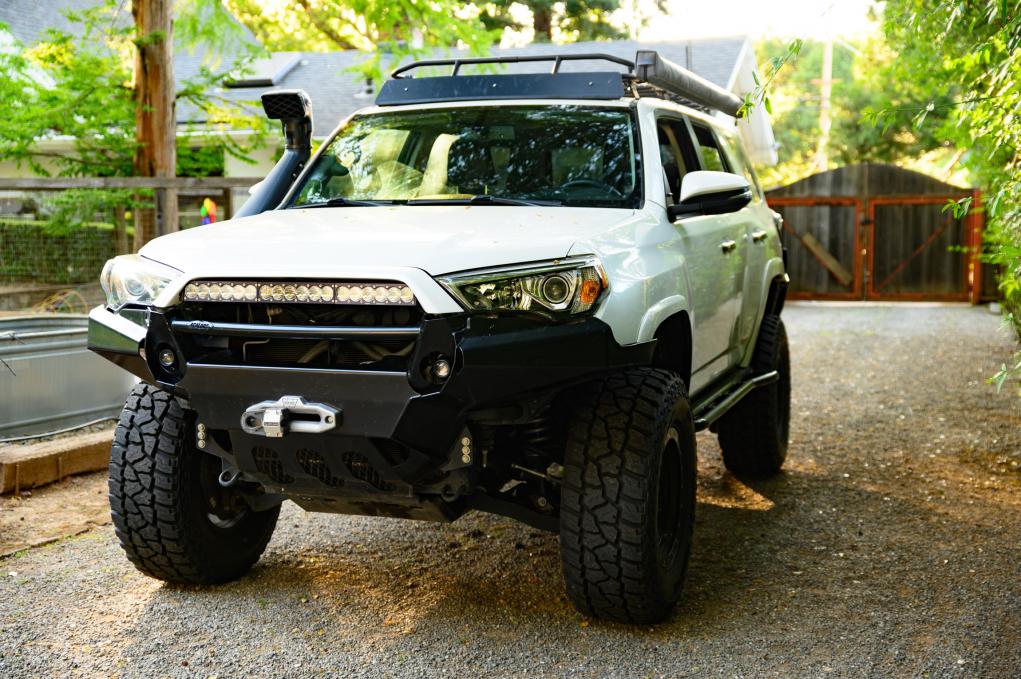

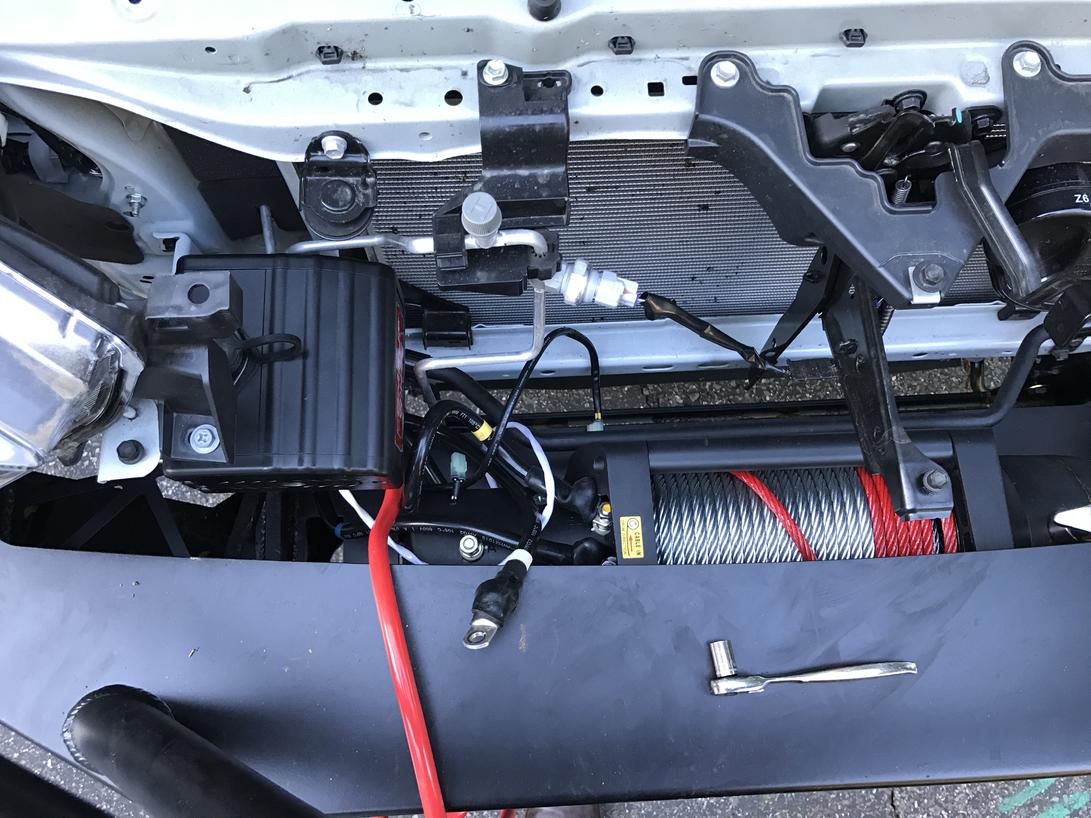

Demello front bumper and winch install. The control pack for the ComeUp Seal Gen2 9.5 winch has dovetails that line up really well with a factory inner-bumper support/upright as seen in the photos. No drilling required, just a trip to the hardware store to get the proper bits.

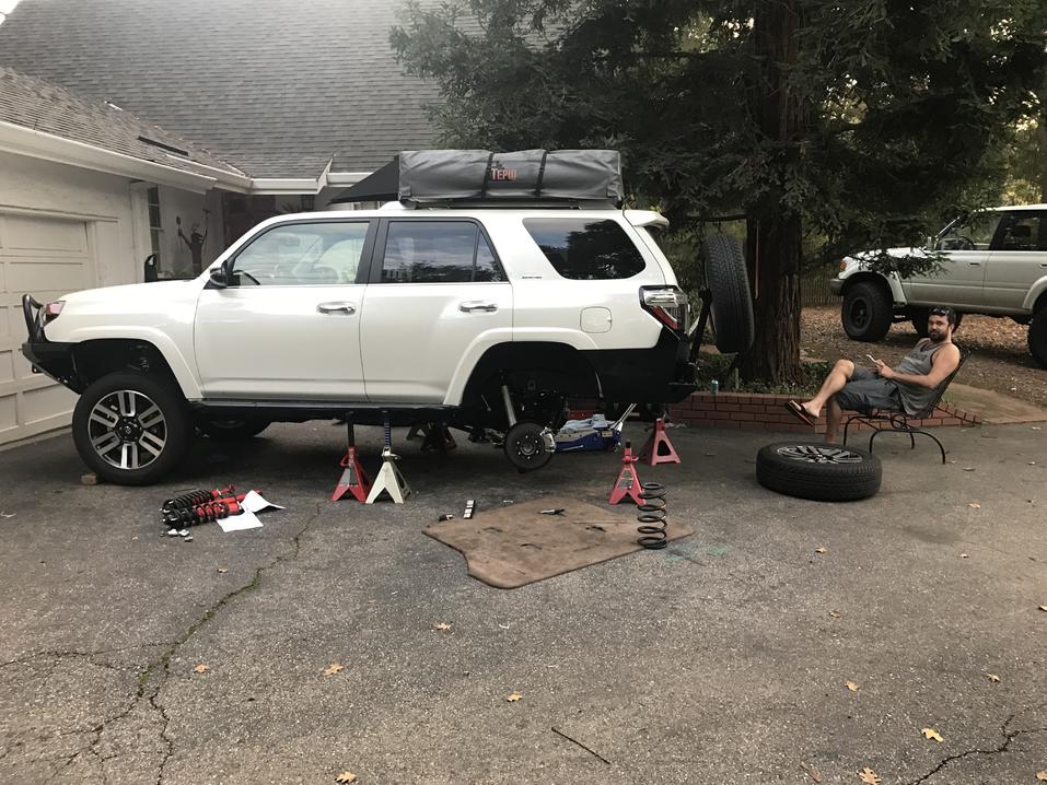

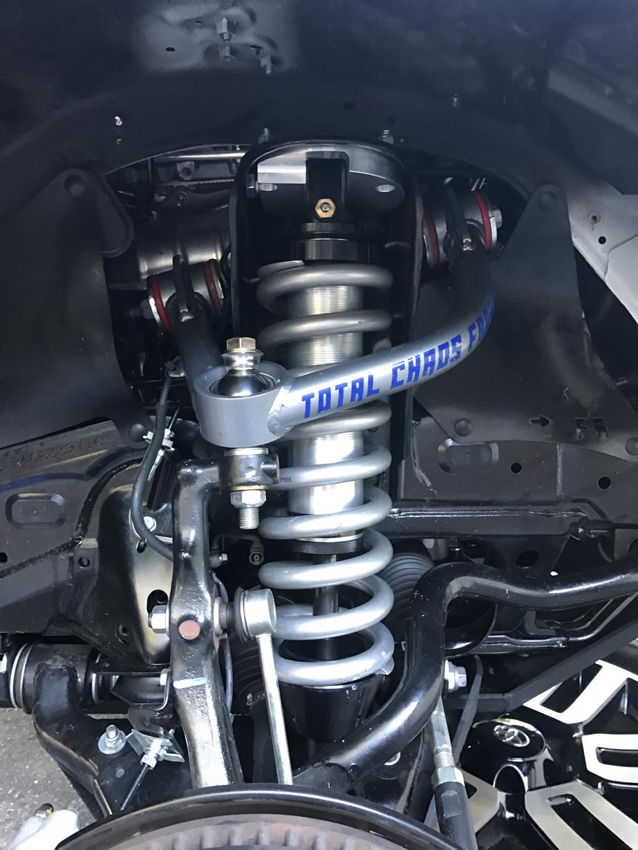

Suspension install. Radflo 2.5" coilovers with 700lbs springs, AllPro 3.5" rear coils which will be swapped out later for increased load capacity. Running Radflo 2.5" rear shocks as well. Also installed AllPro stainless steel braided extended hoses front and rear. Needed them in the rear for this lift height, front was optional but figured do it once and cry once and it sets me up for long travel later on.

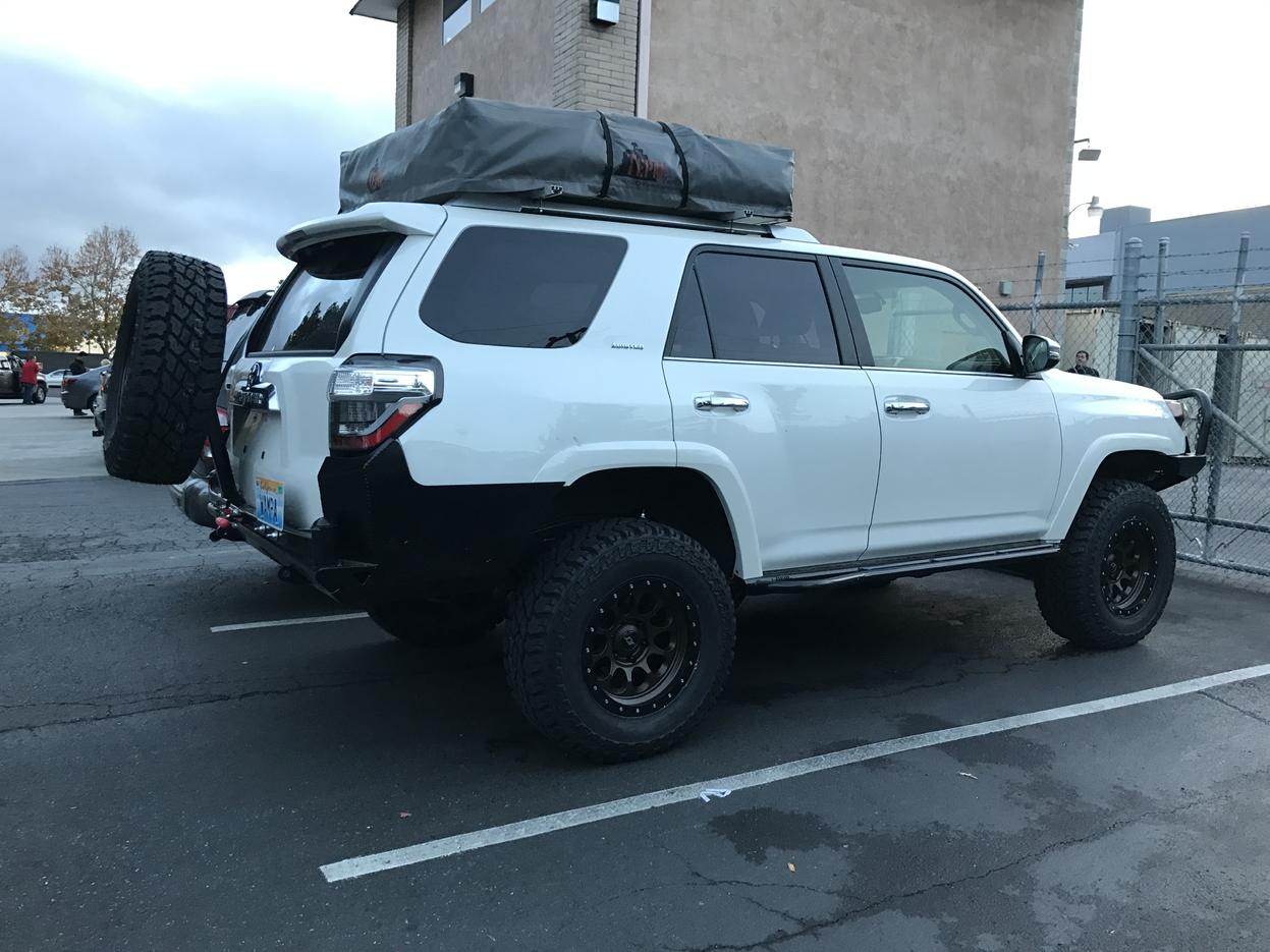

Mounted SCS Ray10 wheels and Cooper StMaxx 285/70R17 tires. Spare wheel is an FJ Cruiser take-off.

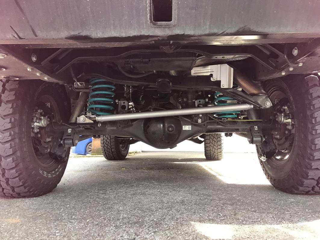

With all the added weight the AllPro 3.5" rear coils were having trouble keeping up. I knew this going into it but it was the best option at the time. My buddy with a GX470 runs OME medium rear coils and I was unsatisfied with the harshness of his ride when unloaded.. granted he doesn't sag when loaded down for trips. I'm currently on a quest for a goldilocks coil.
Installed Dobinsons progressive 400+lb rear coils to give them a shot, plus a Sonoran Steel track bar while I was at it.

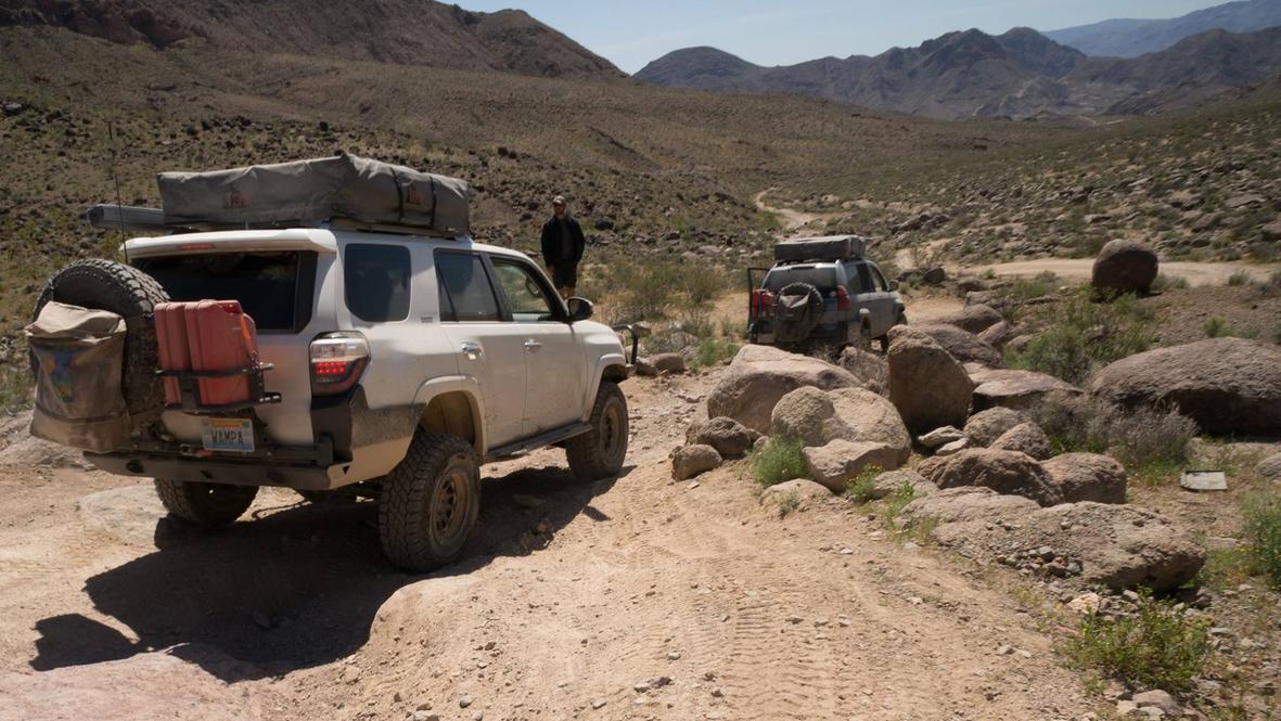

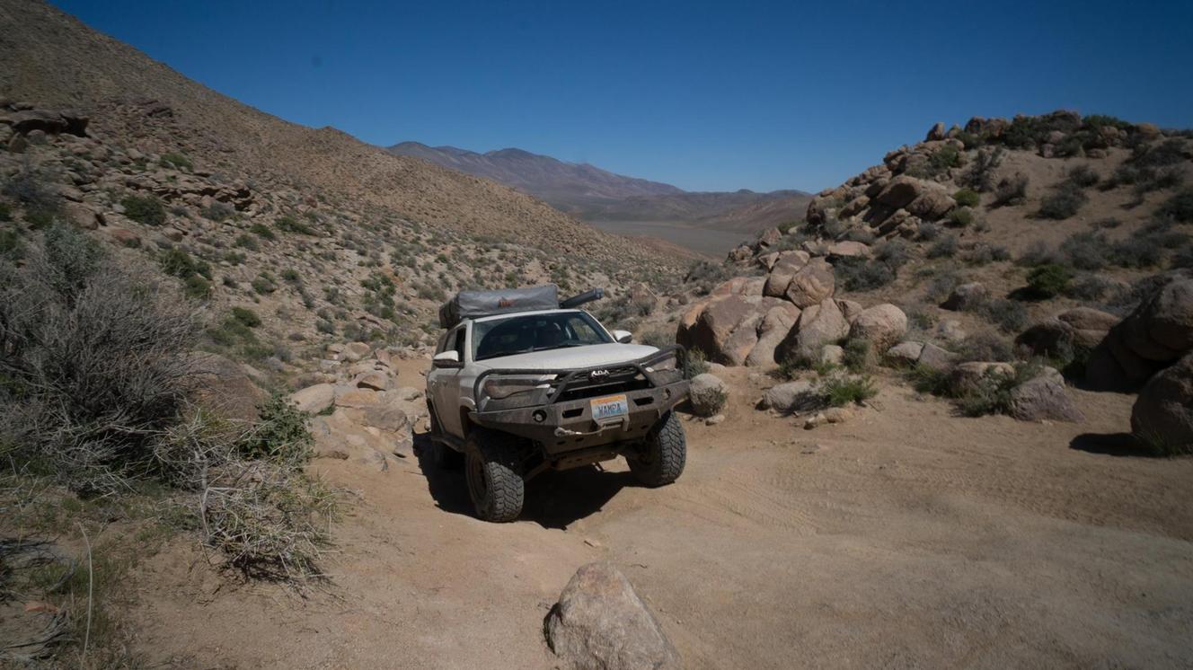

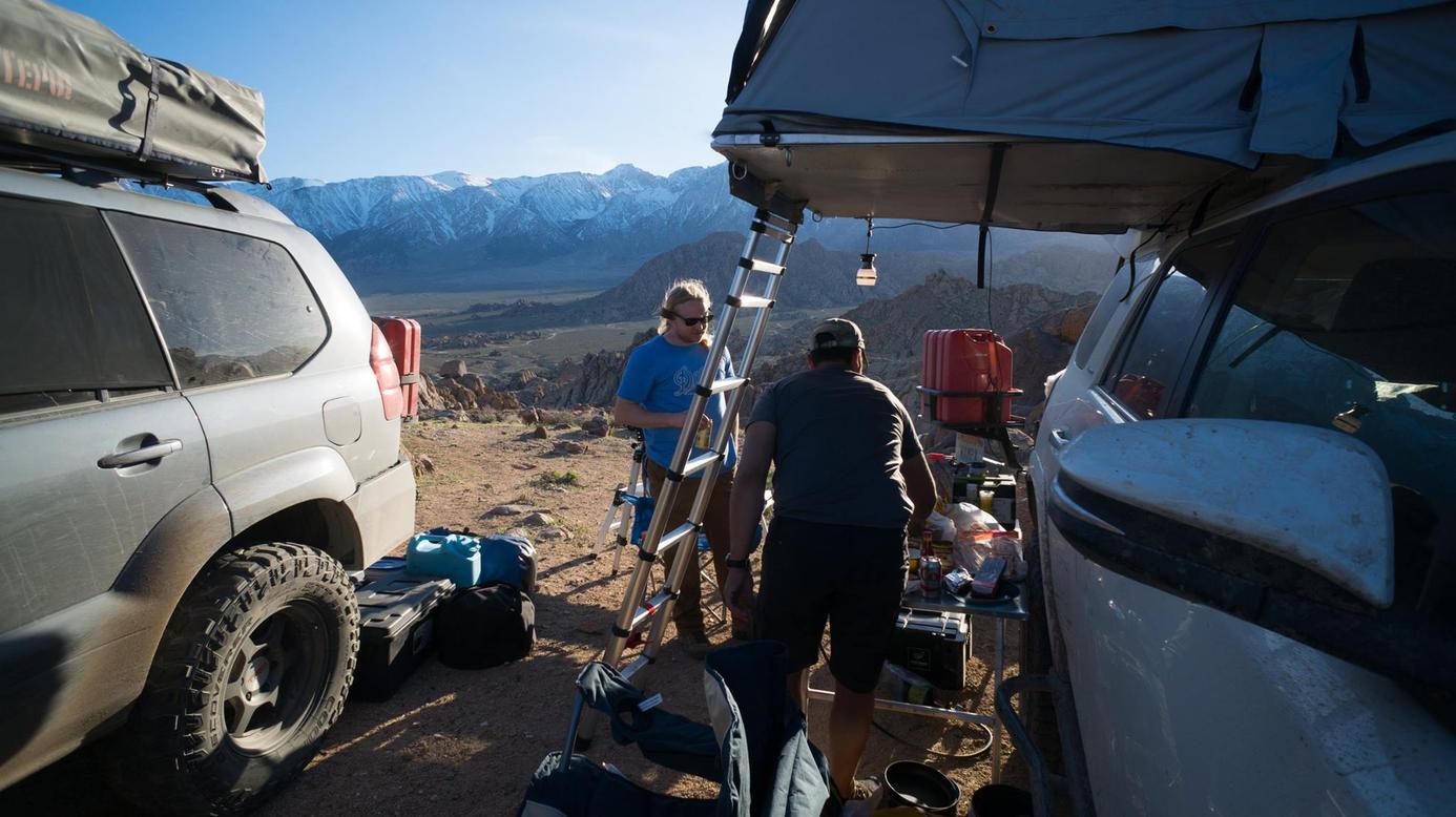

Some shots from our most recent trip, Death Valley for a few nights. Started at Eureka Dunes, southeast through Dedeckera Canyon/Steel Pass out through Saline Valley for the night. We weren't too excited with what we saw at the warm springs so camped up on the eastern escarpment of the Inyo Mountains. Traveled up Lippencott Pass the next day to the Racetrack and east over to Hidden Valley for the night. Next day went up South Pass then down through Death Valley Proper to Goeler Canyon for the night. Sended Mengel pass the next day and punched out via Ballarat the next day. Topped it off with a night at Alabama hills. Buddy in the Lexus had a funky winch issue which we had to sort out before heading up Lippencott. My brother's Grand Cherokee also suffered a swaybar link failure, nothing major and in fact we were all super impressed with how well it did. He left halfway through though, getting him up Mengel pass would have been another story.

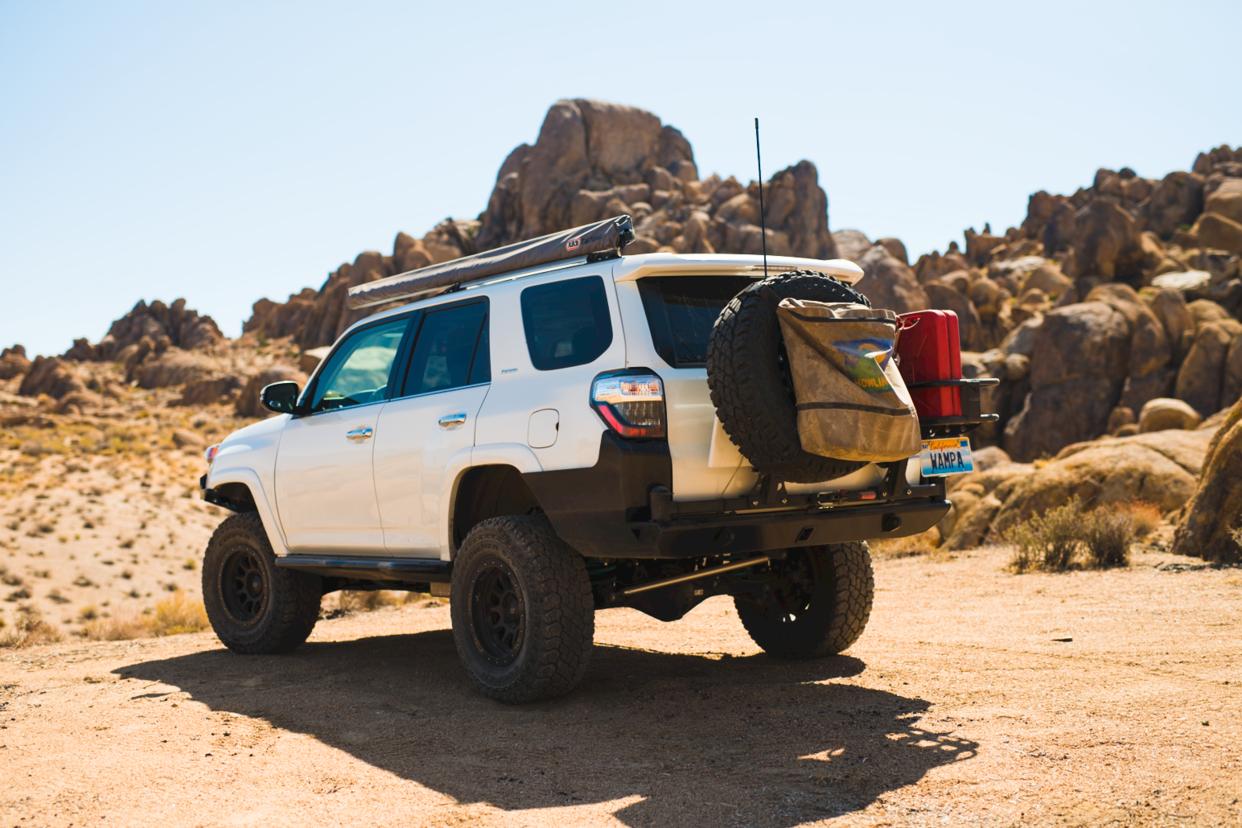

Alabama Hills.
