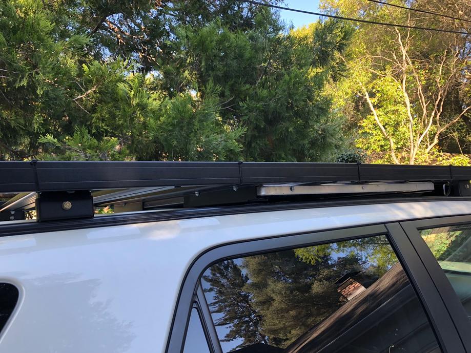

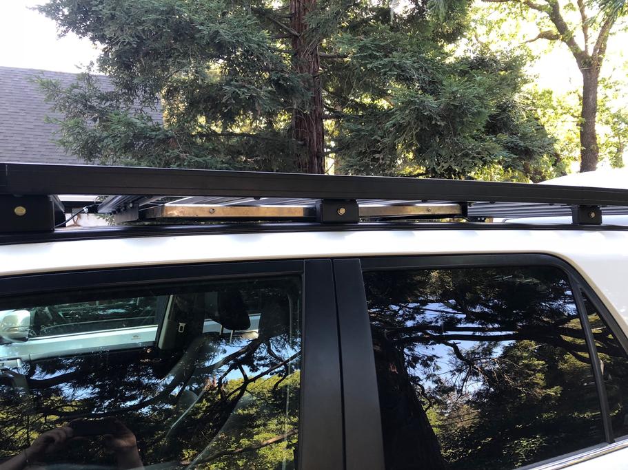

Added a rack this week, Front Runner with universal track and 40/50mm feet to keep things low profile.
Very interested in this rack... not sure if I need the full length or if the 3/4 would suffice. Plus, would really prefer not to drill. Did you install yourself? If so, how was the drilling?
And I believe you had a Gobi Rack on your previous truck? Why did you go with FR this time over the Gobi? Thanks!
I went with FrontRunner this time for two reasons, it’s made out of aluminum (no rust) and has a sliding table tray. The Gobi was great, didn’t make much noise with their fairing, and can be installed in an hour or two, so there’s something to be said for that.
I’m sure the sides FrontRunner makes install easily too, I just wanted to keep things as low as possible hence going with the universal tracks.
Drilling was easy, torquing the bolts is probably the hardest part. I installed the track where the factory mounting locations are, then placed the front towers on and marked where to drill such that I could get the bolts as far forward as possible. I measured everything multiple times but it really wasn’t that hard, just time consuming. To put it this way, I wouldn’t hesitate to do it again.
I’m still fiddling with the table slide. I don’t want to bump up to 50/60mm feet cause I like how low it sits. Over the next week or two I’m going to rearrange the feet and see if I can fit the table over the passenger side front seat, it looks like there’s clearance there.
Any case, it’s a great rack and I love the mounting system. The Gobi did make less noise though, their fairing design is great. The flat rack is just so damn functional though!
Hope that helps! FrontRunner has been great for support on the phone, I wouldn’t hesitate to give them a call. The 3/4 rack probably doesn’t need drilling either.

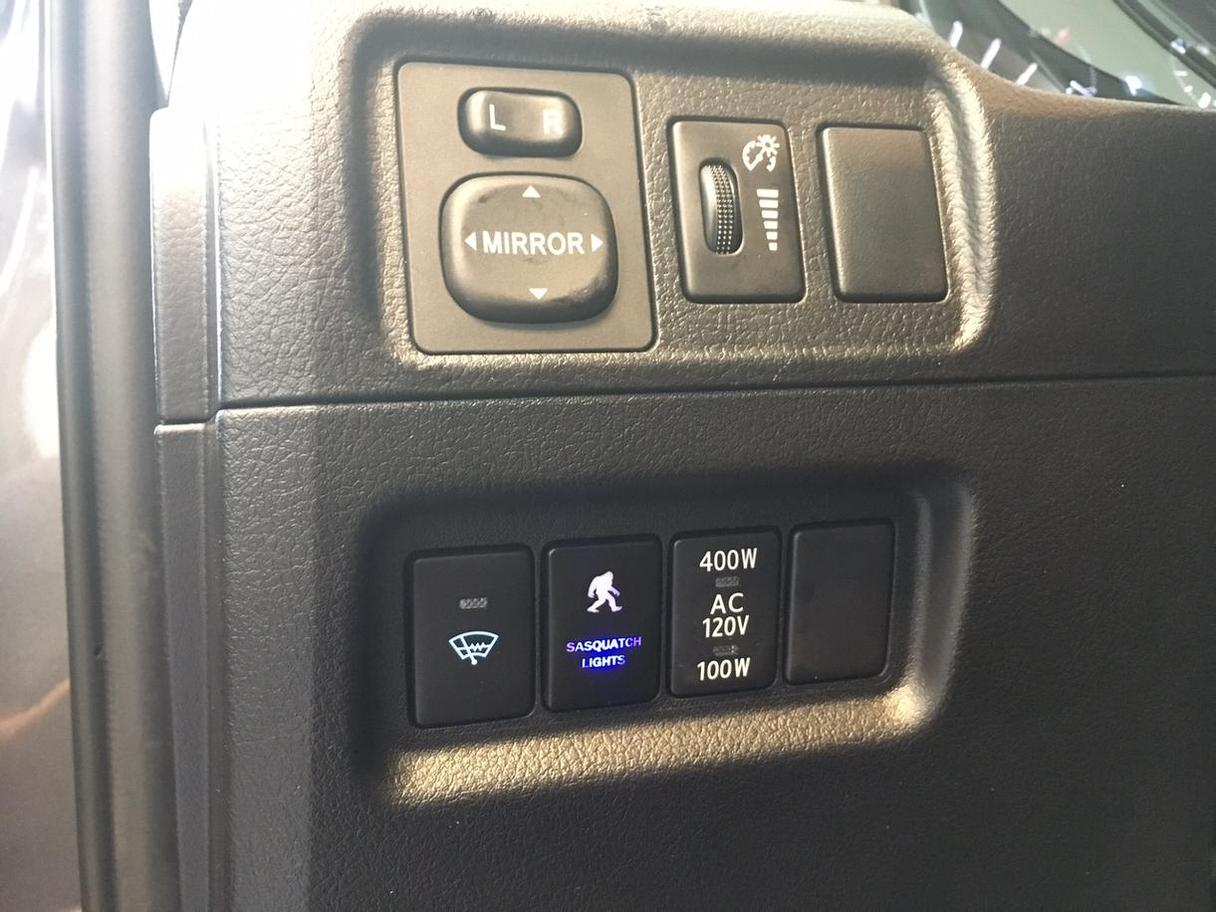

Completed some wiring work the last two days. Thanks to [MENTION=112177]4RnR Grl[/MENTION] for her Youtube video detailing how to pull the dash apart, it was a big help.
I mounted a 6-switch panel in the lower dash and hooked up an LED bar on the roof. Also pre-wired all the switches with labeled leads so I don't have to pull the whole dash apart as I add things. I'm loving how the 6-swtich panel fits in the factory location, somebody at Toyota must have been paying attention.
If I add any more electrical other than the one light bar i’ll Go this route, looks great!
Love the Wampa light switch...I just have a Squatch!
Nice! Yea, OTRATTW can customize the text for a modest price so I went for it. I like those factory style switches though too but I’ve already got them used up so the switch panel seemed like the next cleanest route.

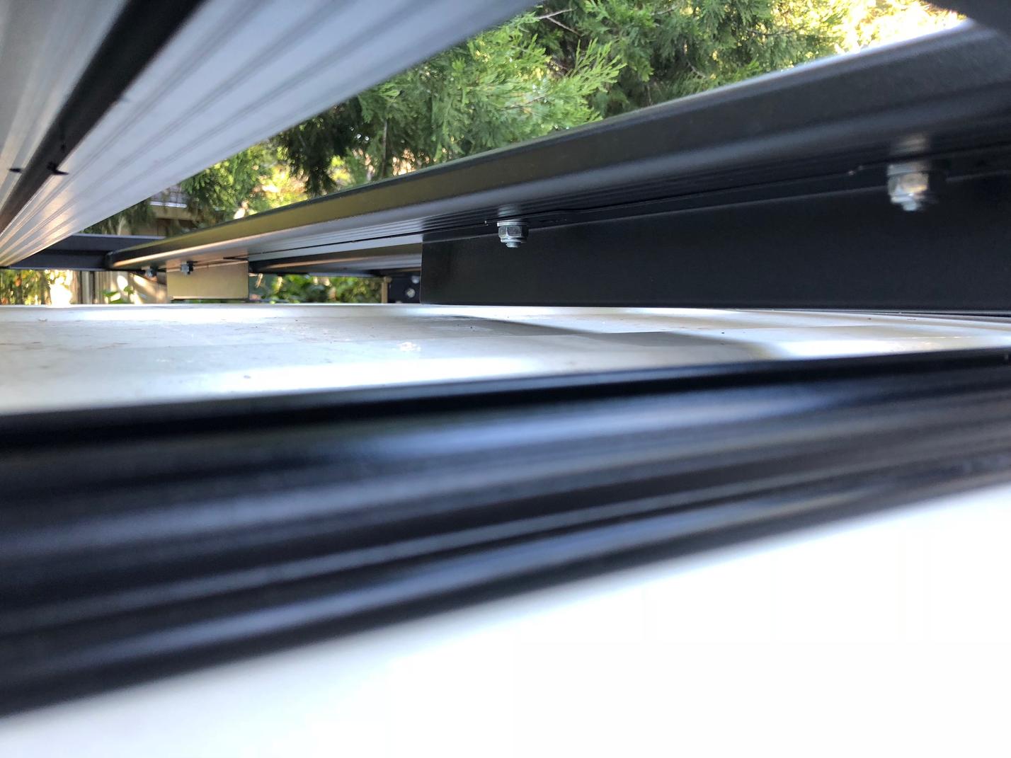

Rack Update: Table Slide
I got the under-rack table slide fitted today. The table is mounted up front, passenger side exit. I could not clear the antenna without stepping up to larger towers, which I did not want to do.
Note that I did have to cut one of the table tray's in order to clear the crown in the roof. How I did it retained two bolts per side, which I feel is adequately strong to support the table. I will be installing some thicker felt along the table trays to help clearance the table from the roof even more.
Overall it's tight but is exactly what I was looking for, so I'm happy.

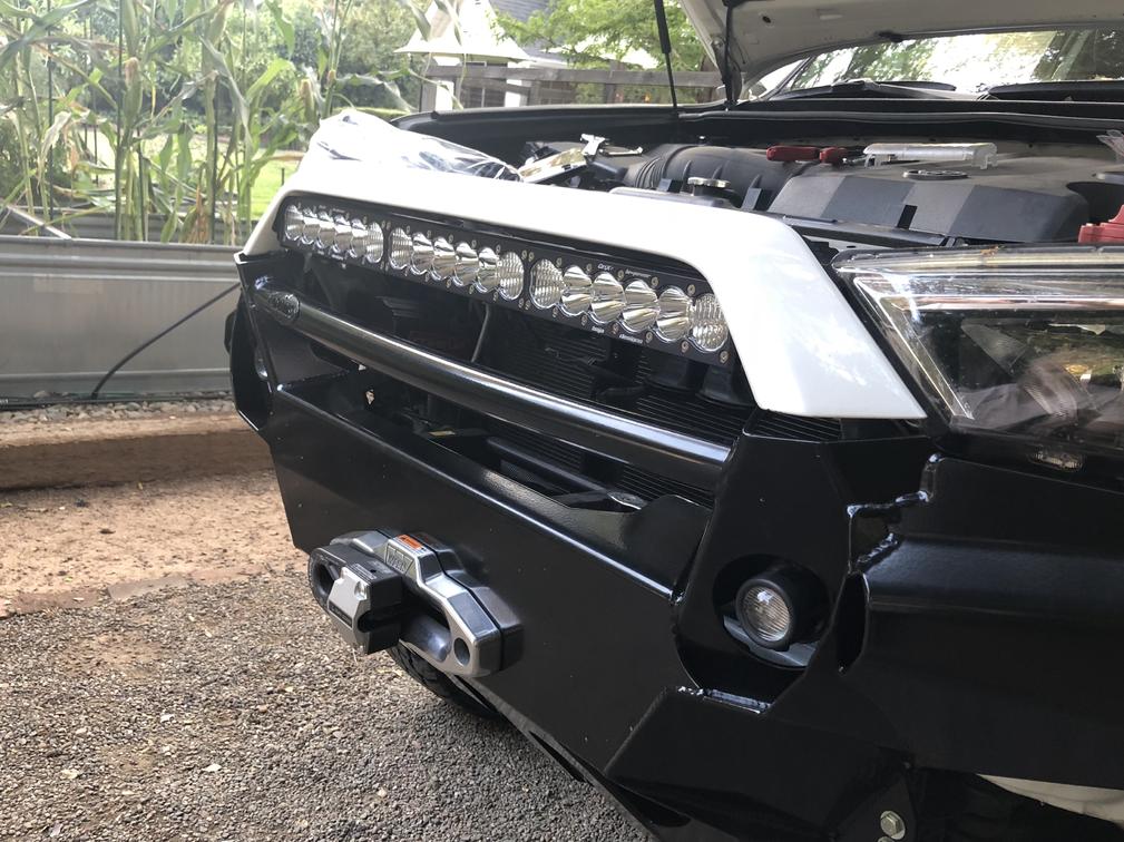

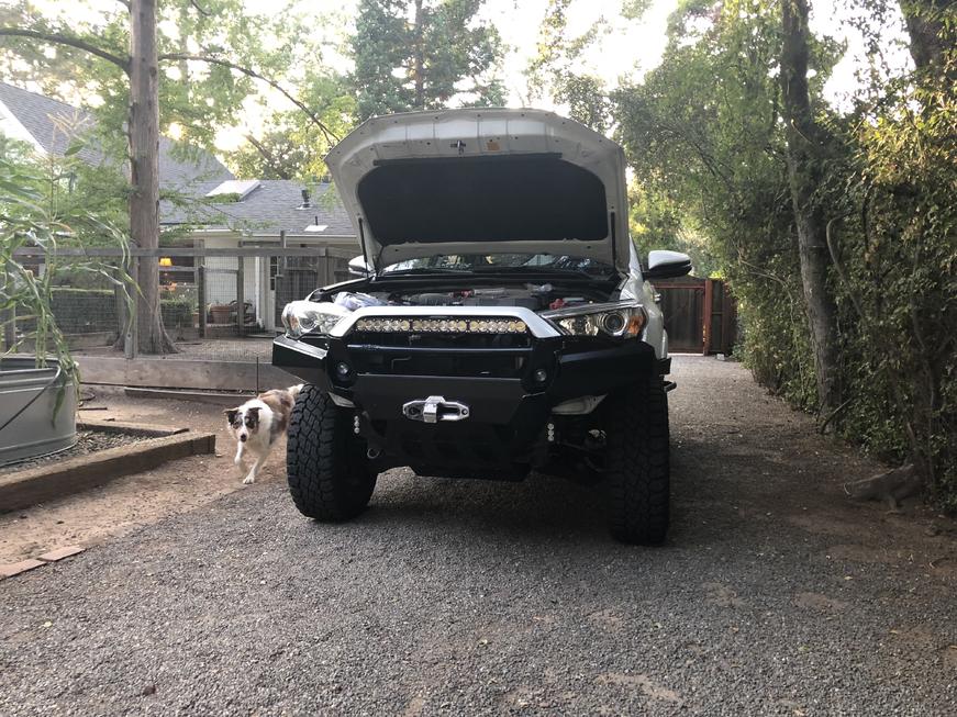

Changed some things around. Had a 4x4Labs front bumper installed, 30” LED bar, swapped wire rope for synthetic, and replaced the winch hook with a Flatlink.
My old Demello bumper is for sale, open to offers. Nothing wrong with it and comes with the metal filler plate, just wanted to take a different route.

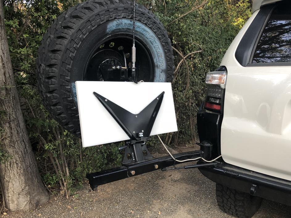

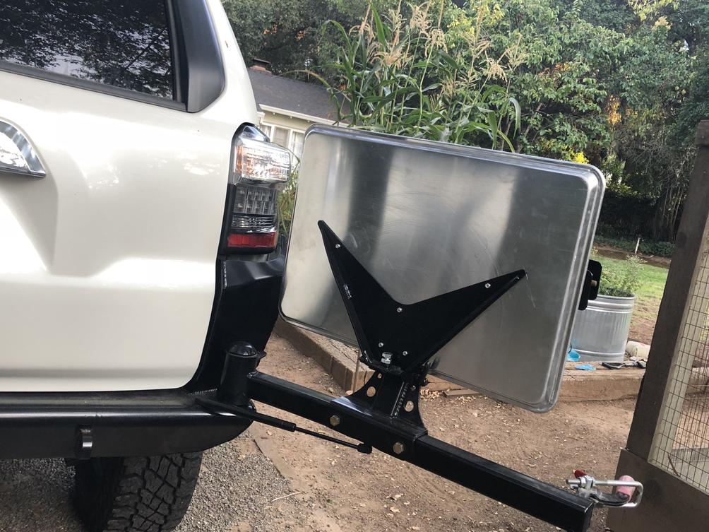

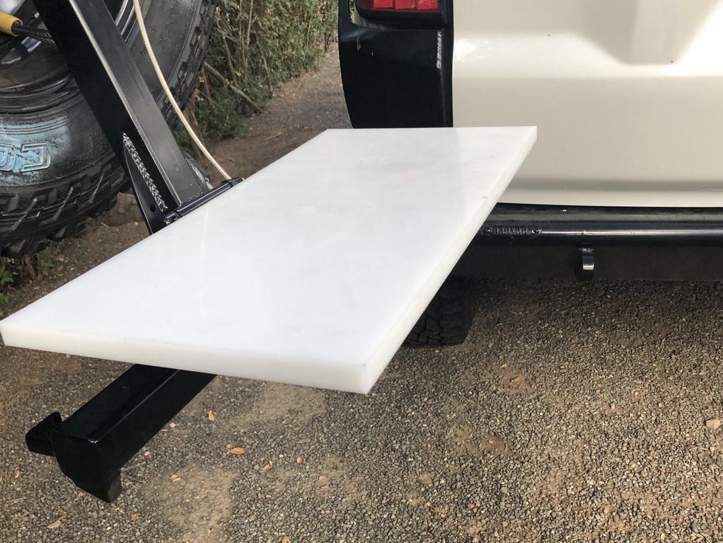

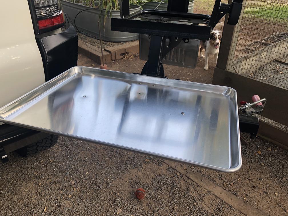

Had new carriers put on as well, these with fold out tabs. They put a cutting board on one and a commercial baking sheet on the other. Thinking I may add some hooks for tongs and a spatula.
Damn, you making me want to give more money to Luke. Like I said I long time ago, he should give out shirts that say I went broke at 4x4Labs

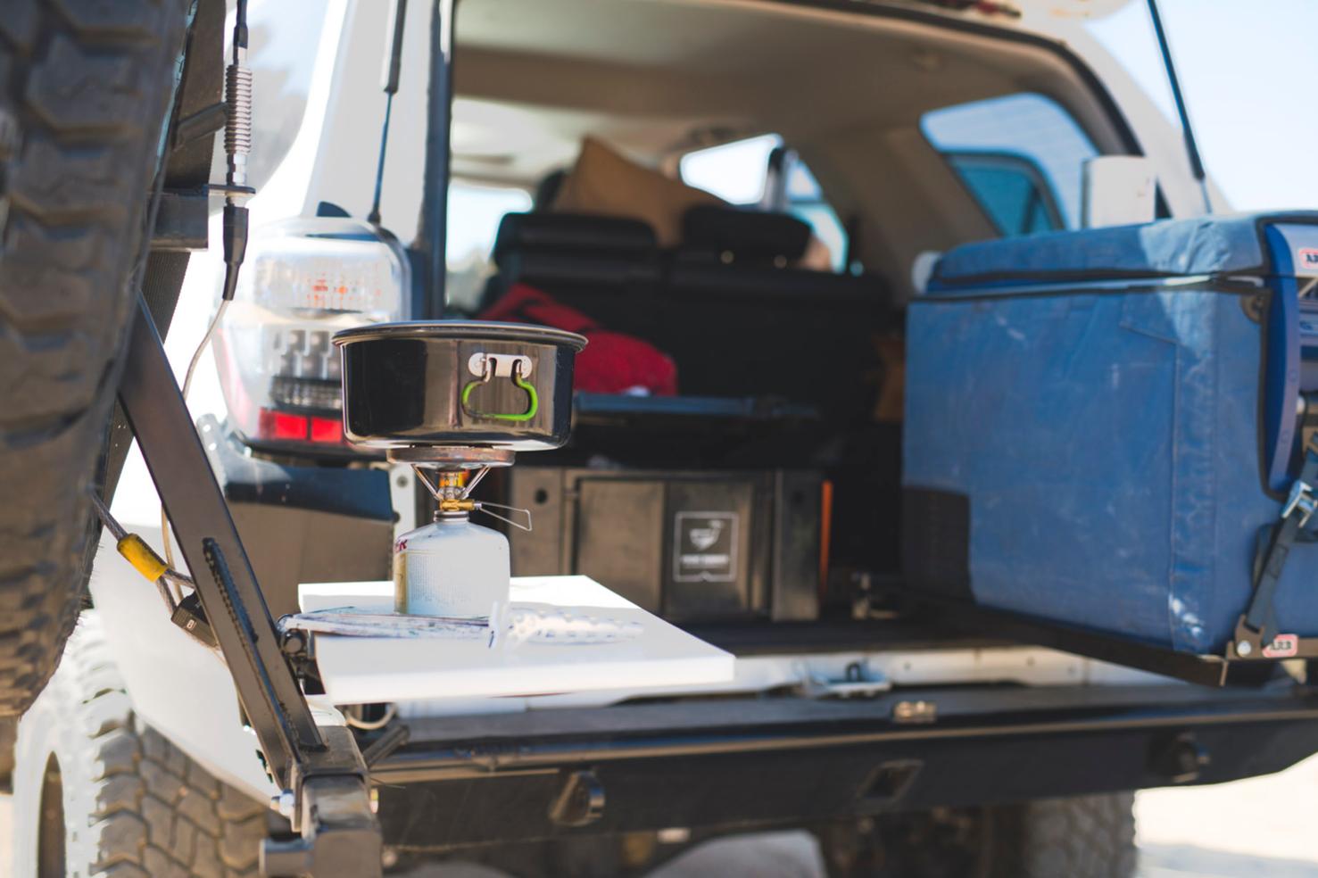

Messing around with the tables, for shorter trips I don't think I 'll have to pack a full size table anymore which is really convenient for me.
