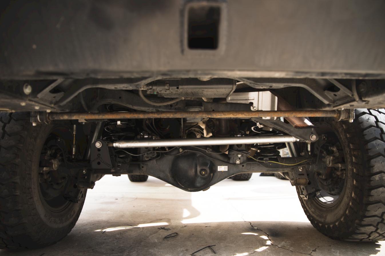

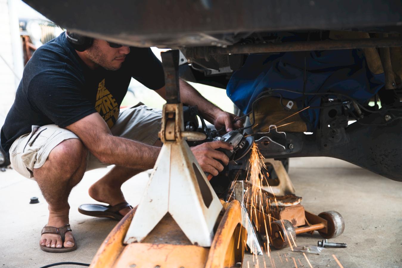

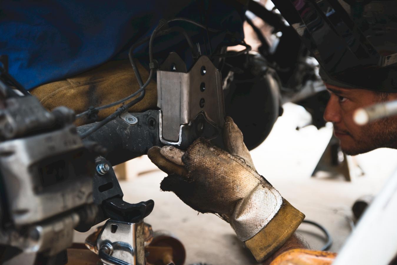

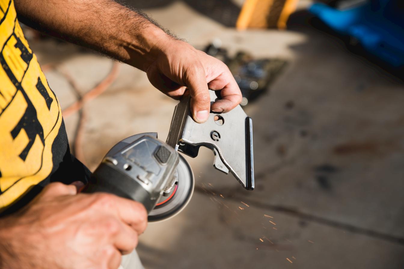

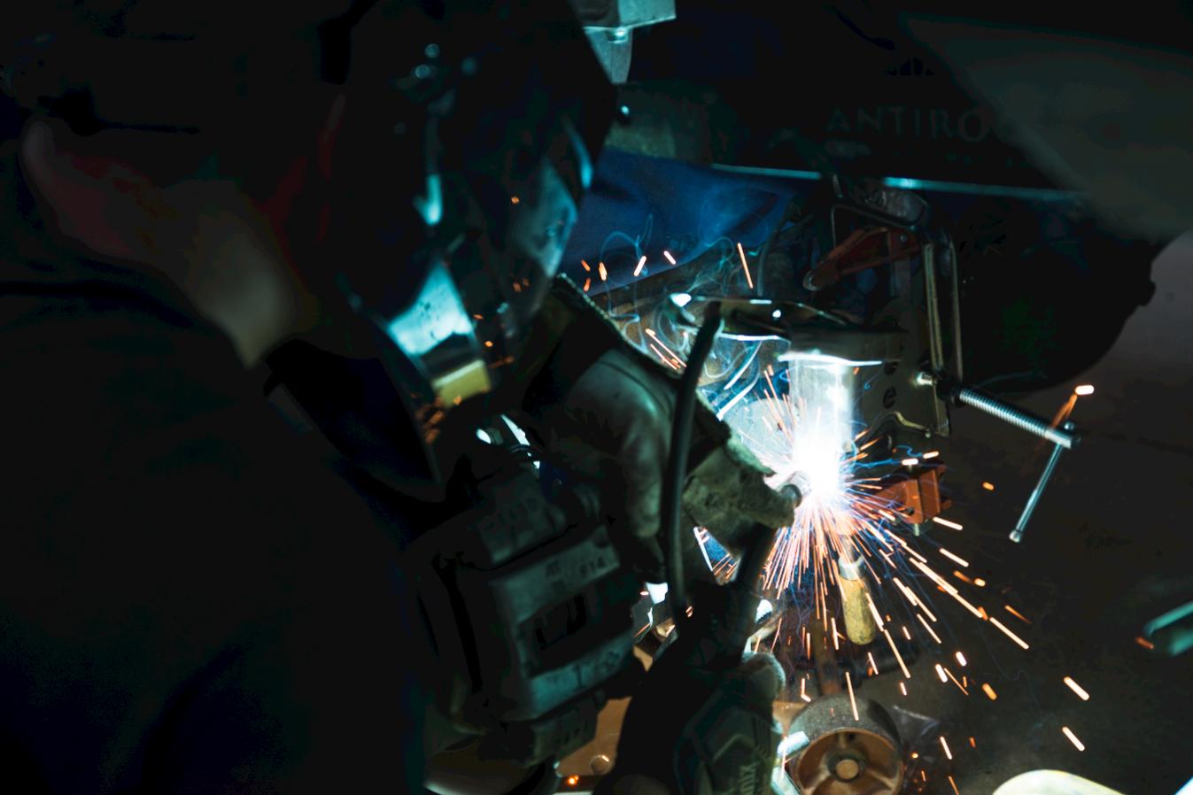

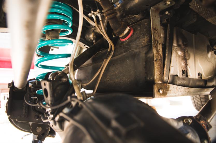

Did some work earlier this week, installed one of [MENTION=28464]eimkeith[/MENTION] panhard correction kit's, aka a rear track bar bracket. I wasn't sure how much a need there was for this on these trucks but it made huge difference, much less bobbing around turns.
Install was relatively easy. You need to unclip the abs lines and unscrew the hard brake lines in several spots. You'll also want to shield the fuel tank due to proximity.
We ended up adding a couple extra gussets, not so much that we felt the design needed it, but because we were in there already and figured why not (this isn't something you want failing.) Track bar is nearly flat now, it's really impressive.
Overall, thanks for the great product Keith, sorry if I ever doubted the need before, you were right!

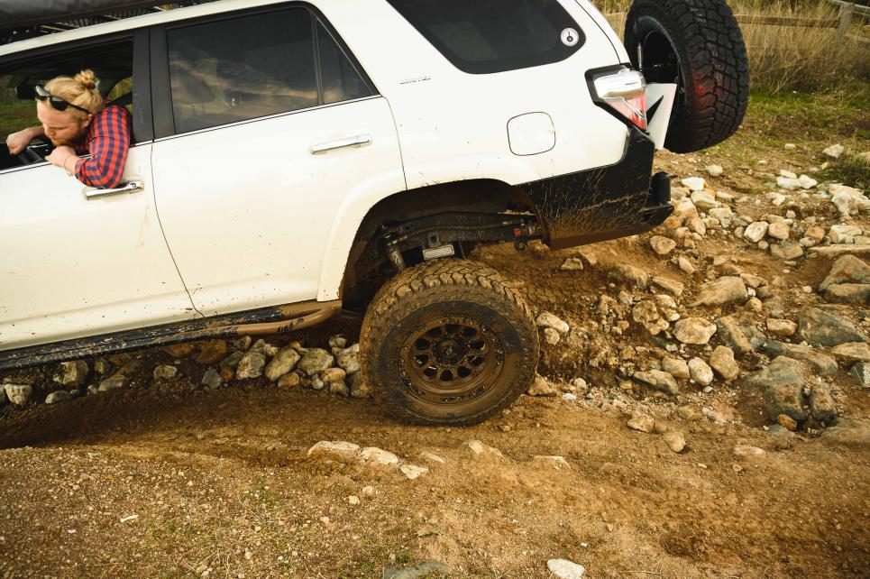

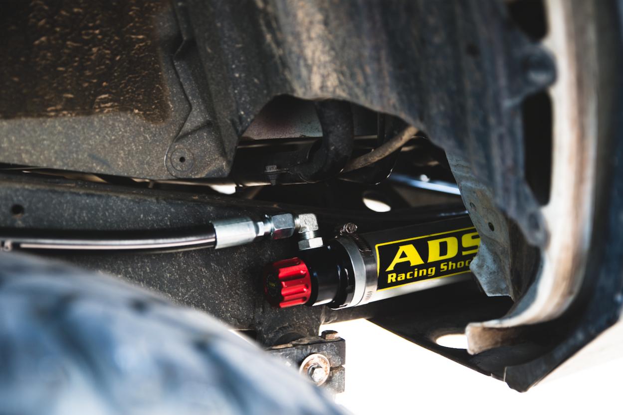

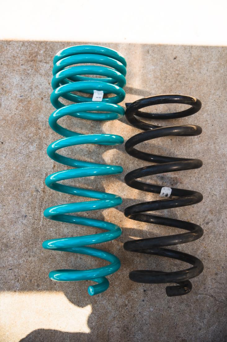

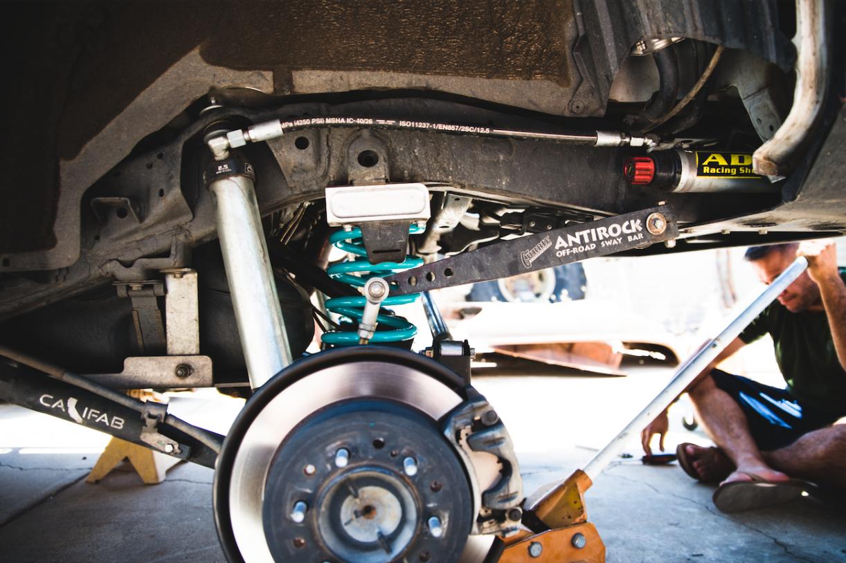

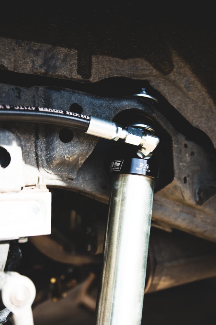

Played around with some OME linear rear coils (899's). Ride was good with my weight, but I wanted more height. Eventually came back to Dobinsons, put their new super duper heavies in, really happy with them. I had previously installed some 2" bump stop extensions, paired with 26.5" long ADS 2.5" shocks. I'll do a write-up on those at some point, but it meets my needs perfectly... extended down travel while maintaining usable up-travel so I'm not riding on my bumpstops. Tried to show how having offset rear upper controls helps clear the fuel tank as well, for those running extended down travel setups.
I know why people do it, but 3" bump stop extensions are just too much for my taste on these vehicles, and this setup still flexes like a machine.

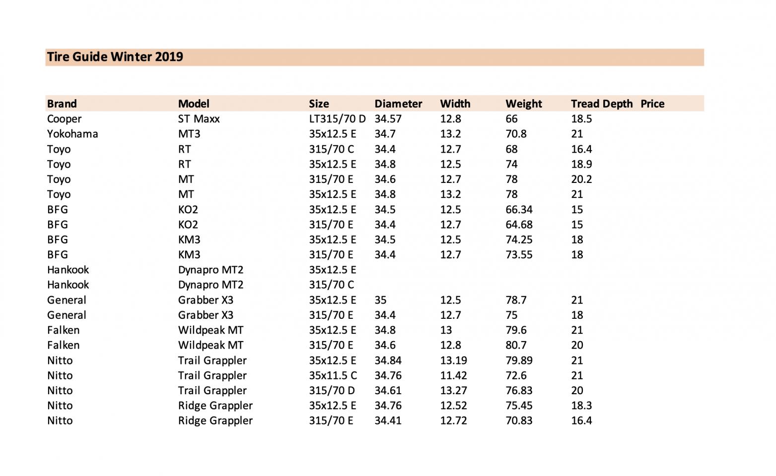

Thought I'd throw this up for anyone else.. I'm shopping 35's and compiled some tire stats. I'll update it with prices once I have them.
I was surprised to see Nitto offering their Trail Grappler in a 35x11.5, those just may be the ticket.

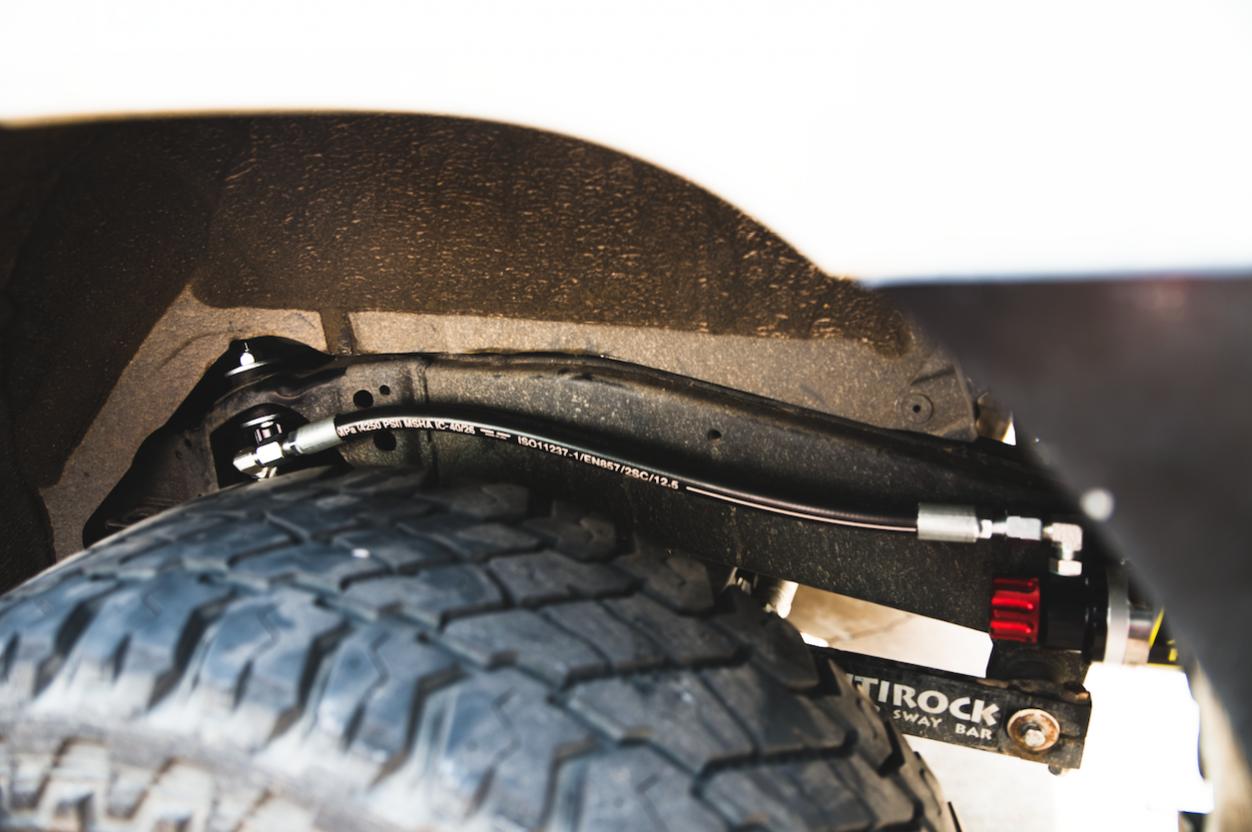

Also, an Antirock update. I had clearance issues a couple months back between the sway bar links and the new bump stop extensions I put on.. working on a solution currently. I'll update that once it's confirmed to work.

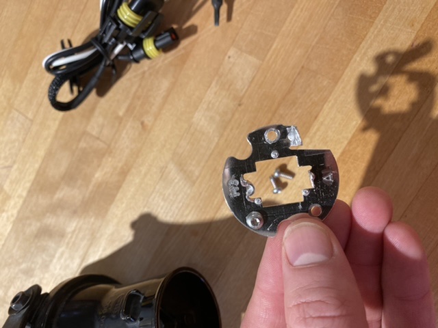

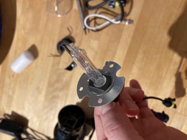

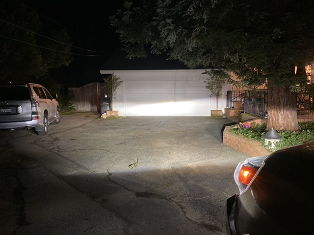

Hella Micro DE Fog Light HID Conversion

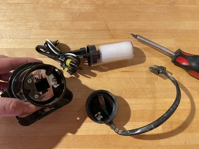

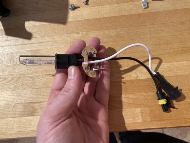

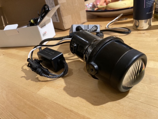

Got around to installing an HID conversion into a pair of Hella Micro DE fog lights, thought I’d post this for any interested parties.
Context: I first purchased these lights several years ago when I was running a Demello front bumper. They were recommended to me by Susquehanna Motorsports as one of the best performing street-legal fogs on the market, and they weren’t wrong. I’ve worked with them numerous times and have always been happy. Great spread and output from an H3 halogen bulb placed in a magnesium-housed projector.
Fast forward a few years and I swapped the Demello out for a 4x4Labs front bumper. Super happy with it, except their fog light pockets are more of an aux-light pocket, as the mounting tabs are positioned on an angle. This is fine for a spot or flood light, but not anything that requires a horizontal cutoff (ie street legal).
I shelved the Hella’s for awhile but found some time recently to get around to them. Picked up a DDM HID kit during Black Friday and welded some angled l-brackets together last weekend, to rotate the mounting surface horizontal from the bumper’s angled tabs.

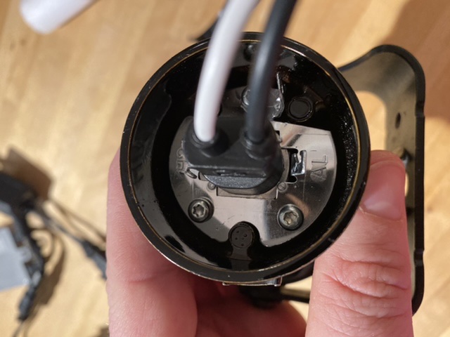

The bulb swap was easy. I wasn’t sure how smoothly it was going to go at first because H3 bulbs use the mounting plate as a grounding interface. What I ended up doing was simply removing the H3 bulb catch, unscrewed the mounting plate, and fed the HID bulb through the plate (wires first). This functionally created a mounting plate that sandwiched the HID into the back of the housing via the factory 3 screws. I was pretty happy with how this turned out.
I mention the above because I read on several 4wd and enduro bike forums of people doing an HID swap into these housings, but using bailing wire, zip ties, washers, etc to secure the HID bulb to the housing. I think the method I used above is likely both easier and more robust, time will tell.
The rest of the install was more or leas the same as any other HID install. I re-used the factory Hella relay and wiring harness, simply swapped the power connectors over to the HID harness for a plug n’ play solution.

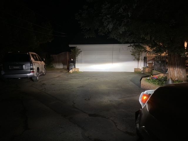

I included two iPhone shots, one with and one without the fogs on. Note the exposure wasn’t standardized, I’ll have to pull my dslr out for that and wanted to get a side by side with someone with factory fogs, for comparison. I’ve aimed the cutoff of the fogs to be slightly below the low-beam cutoff, and the increase in near and wide field lighting appears substantial. Hope that helps!

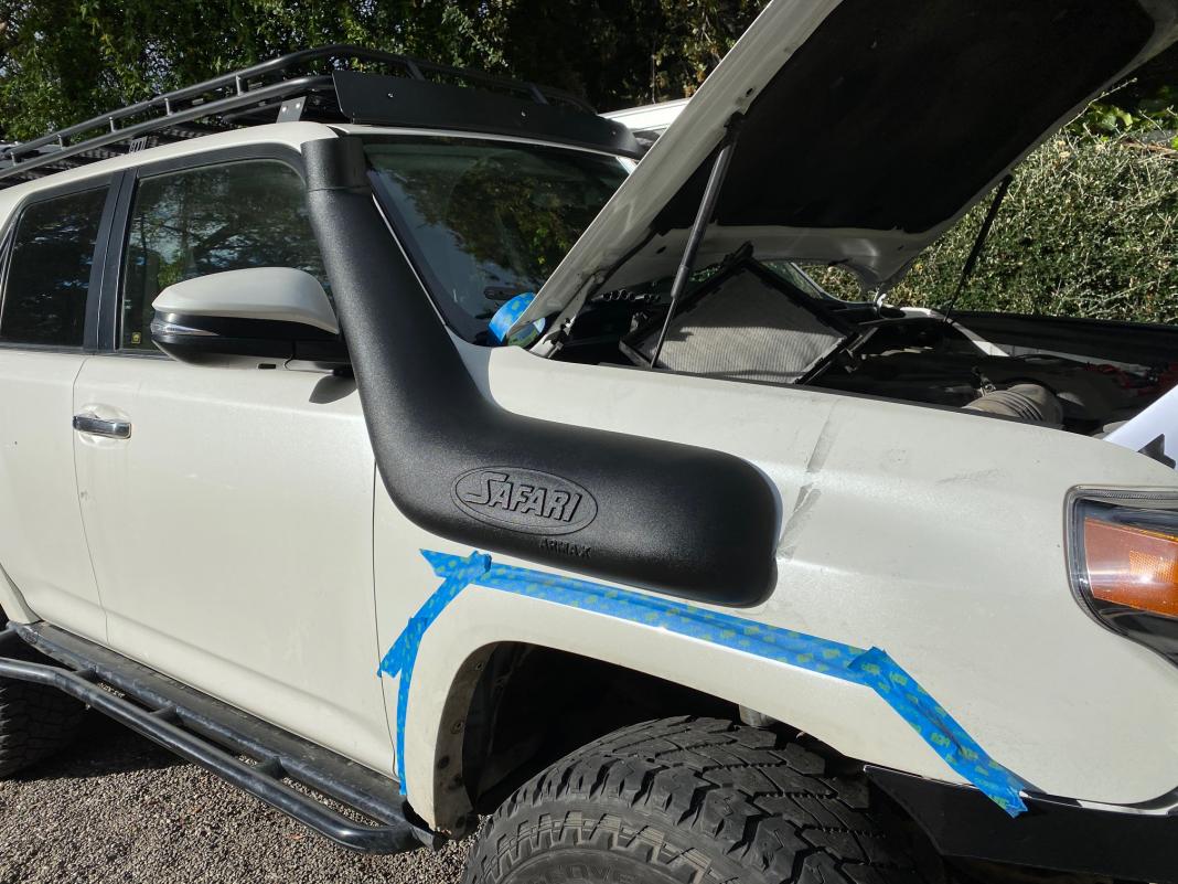

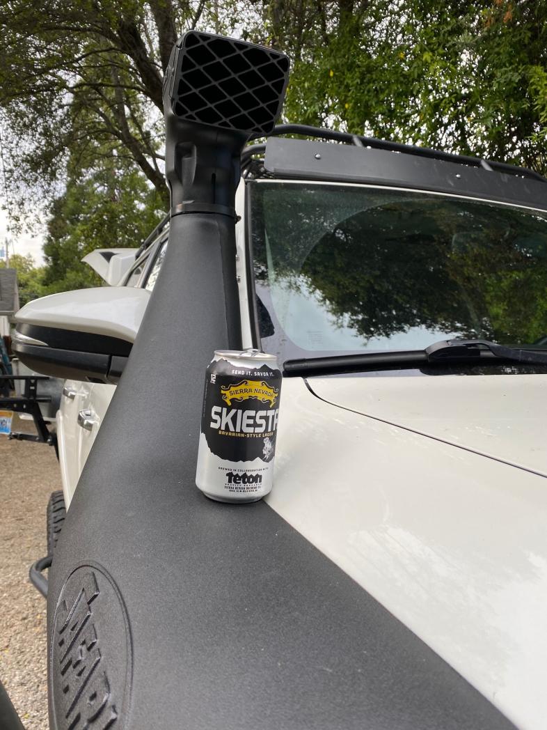

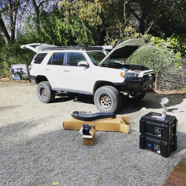

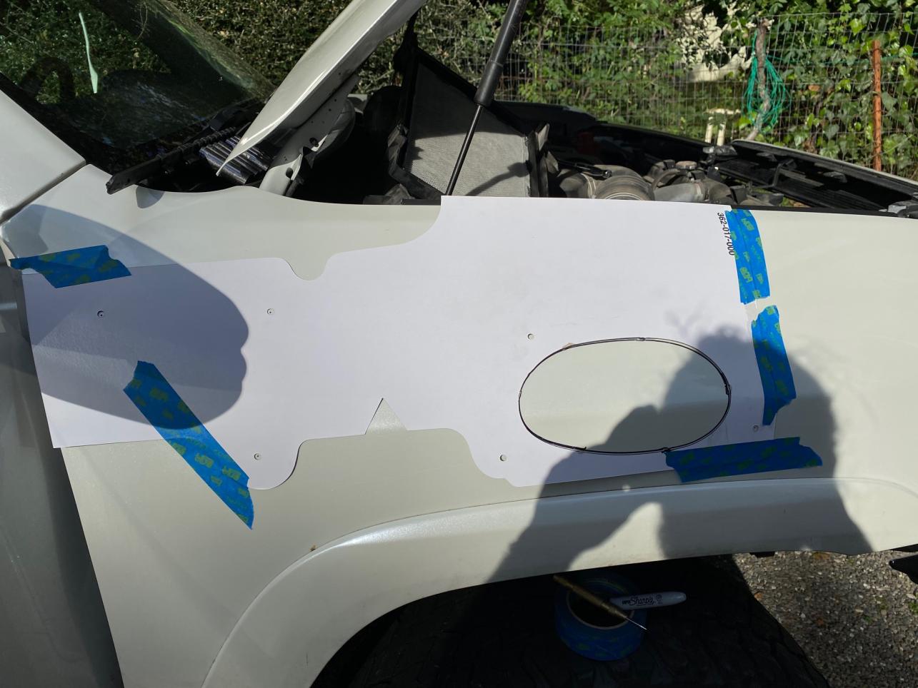

Got around to installing the snorkel, went pretty smooth overall. Only notes are that I disagree with the amount of trimming that is indicated to the factory airbox, I trimmed less than recommended and still feel like there's barely enough material to create a good seal with the snorkel's rubber hose. I'll be checking it after a few hundred miles to make sure it's still seated properly.

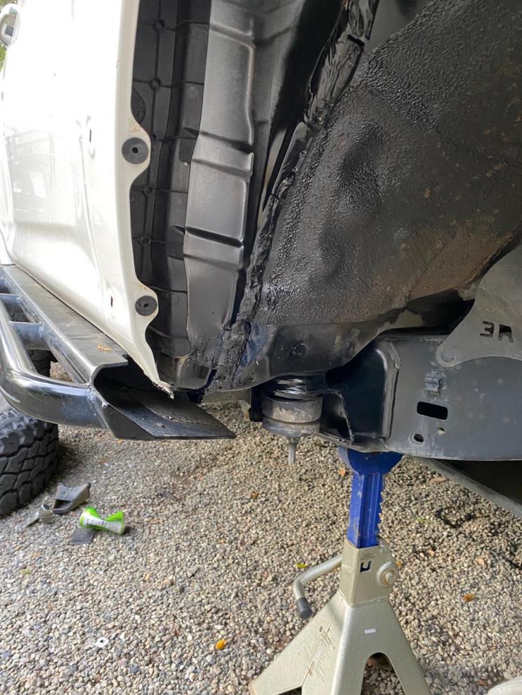

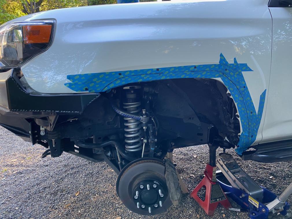

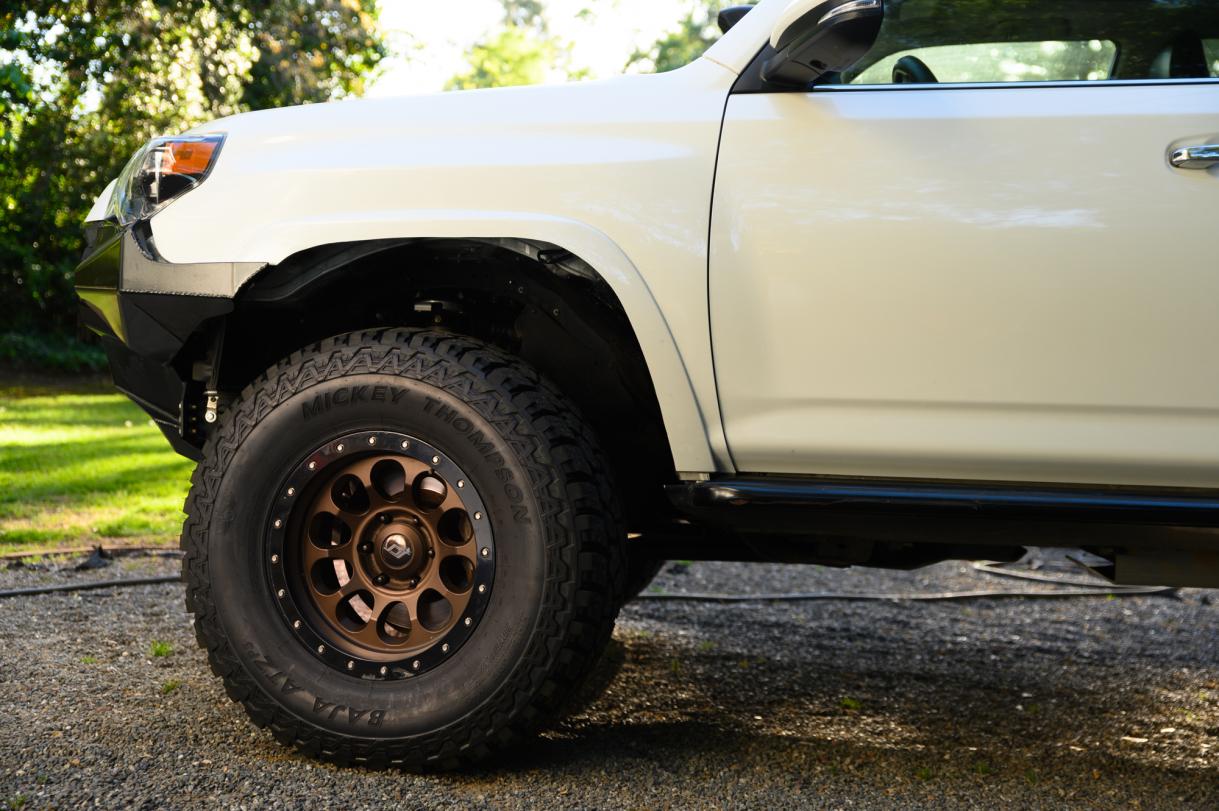

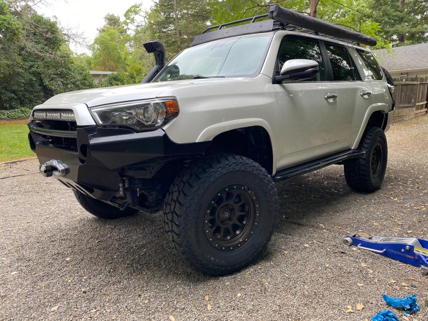

Another update, just finished initial trimming for 35's. I plan on making a youtube for this since there's a number of variables involved, but long story short I trimmed the body mount back, folded the pinch weld over, and clearance the fender flares. Once I confirm clearance the body mount will be either boxed in or relocated completely with one of the numerous aftermarket brackets.
Overall I'm loving the increase in size, didn't have to lift the truck any more and it feels like I've finally optimized the ground clearance/center of gravity ratio. Opted for Mickey Thompson ATZ P3. I've owned 3x sets of Cooper ST Maxx and love them, but with the rebate Mickey was running I couldn't turn them down, and being made by Cooper I trust they'll be quality. Almost went with Nitto Ridge Grapplers but couldn't justify the increased weight, at least not on this platform.
Also replaced an inner tie rod end while we were at it. Shout out to Custom Alignment in Mountain View, one of the best shops in the bay, bar-none.
