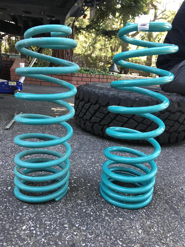

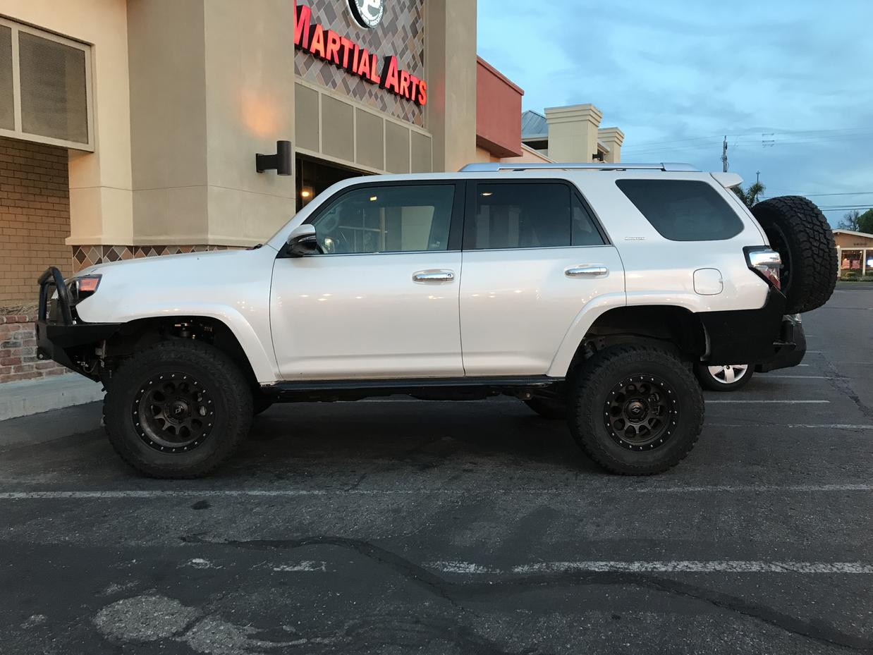

Installed new rear coils today. I had been running Dobinsons progressive heavies but found them not heavy enough. Between the bumper, armor, and gear, I'm carrying upwards of 750 pounds.
Worked with Mike at Dobinsons USA and they shipped me a custom set, call them superheavies progressive? Measuring from the center of the wheel hub to the bottom of the fender flare the heavies set me at 22 13/16" driver and 23 11/16 passenger (uneven driveway). These new ones lifted me to 26 driver 26 6/8 passsenger. Keep in mind these are brand new and I expect them to settle over the next month.
Ride is great unloaded, firm but soft bump compliant.
Note, I had to pull both upper and lower control arms to get these in, as well as unbolting two abs brackets. At this height the factory rear sway bar links will not work, I removed the sway bar till I decide which direction to go with that.
I'm loading it up tomorrow for a trip so I'll report back on how they handle weight.

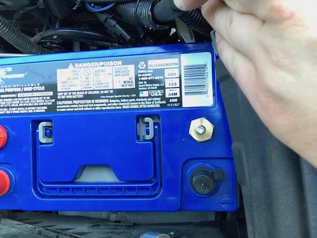

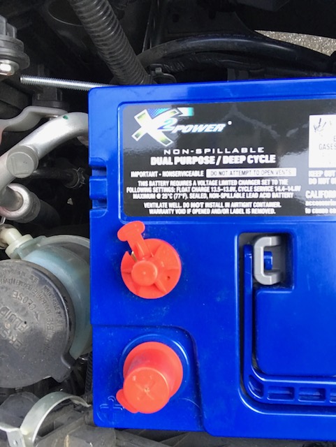

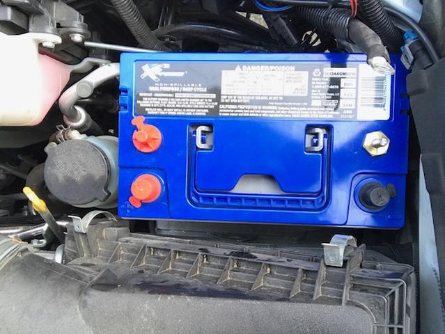

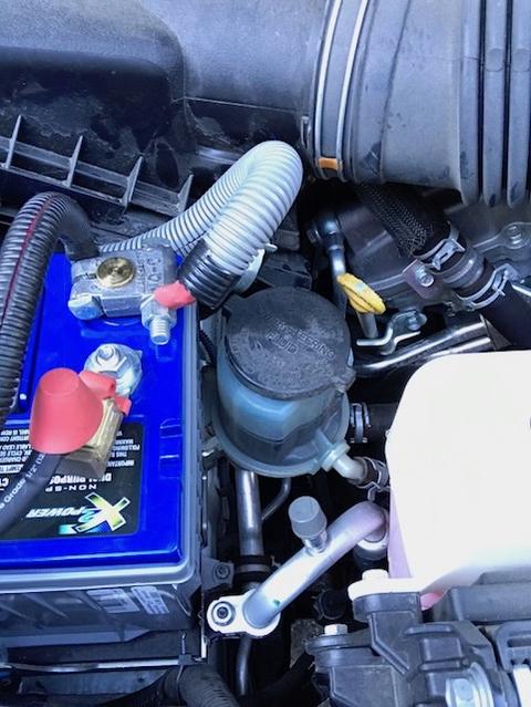

Updating some battery info for anyone running Shrockworks' dual battery kit. My Die HaRd Platinum Marine 34M finally bit the dust, it was my own fault.. left something plugged in for 6-8 weeks and completely killed it.
While shopping for a new battery I came across the X2 Power line from Batteries+. I'd never heard of it before but it appears to be a rebadged NorthStar, which from my knowledge is on-par with Odyssey. The X2 and Odyssey have the same CCA and capacity specs. It was $120 less and has the same warranty so figured why not. Both made in the US.
This update is more-or less so folks know that the X2 Power 34M is confirmed to fit the Shrockworks second battery cage (battery fitment questions seem to come up a lot with this kit). Dimensionally it appears identical to my outgoing Die Hard Platinum/Odyssey. The terminals are in the same location as well which was a big deal for me because I have everything wired up specific to the layout of the Die Hard/Odyssey.
Hope that helps anyone looking at batteries.

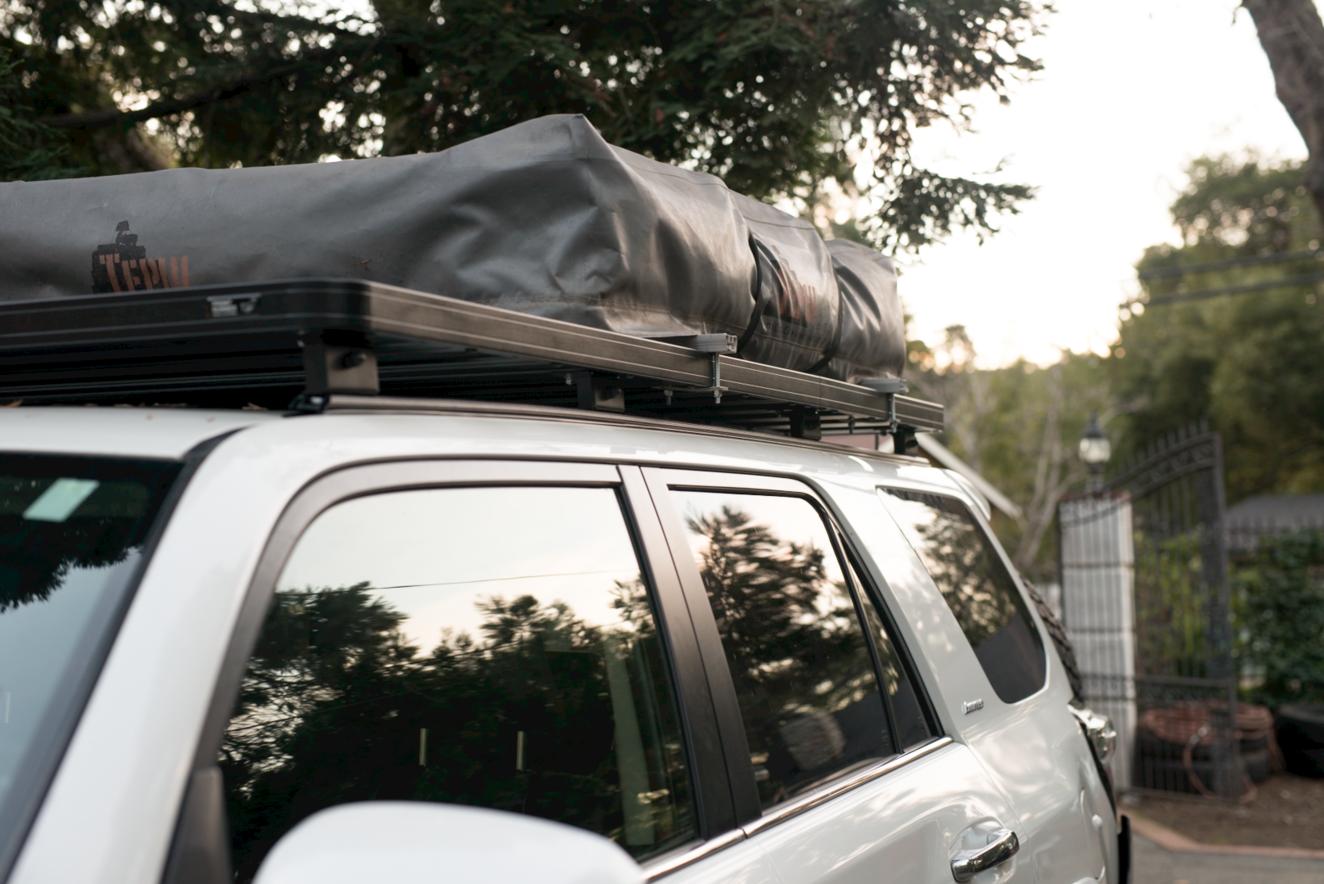

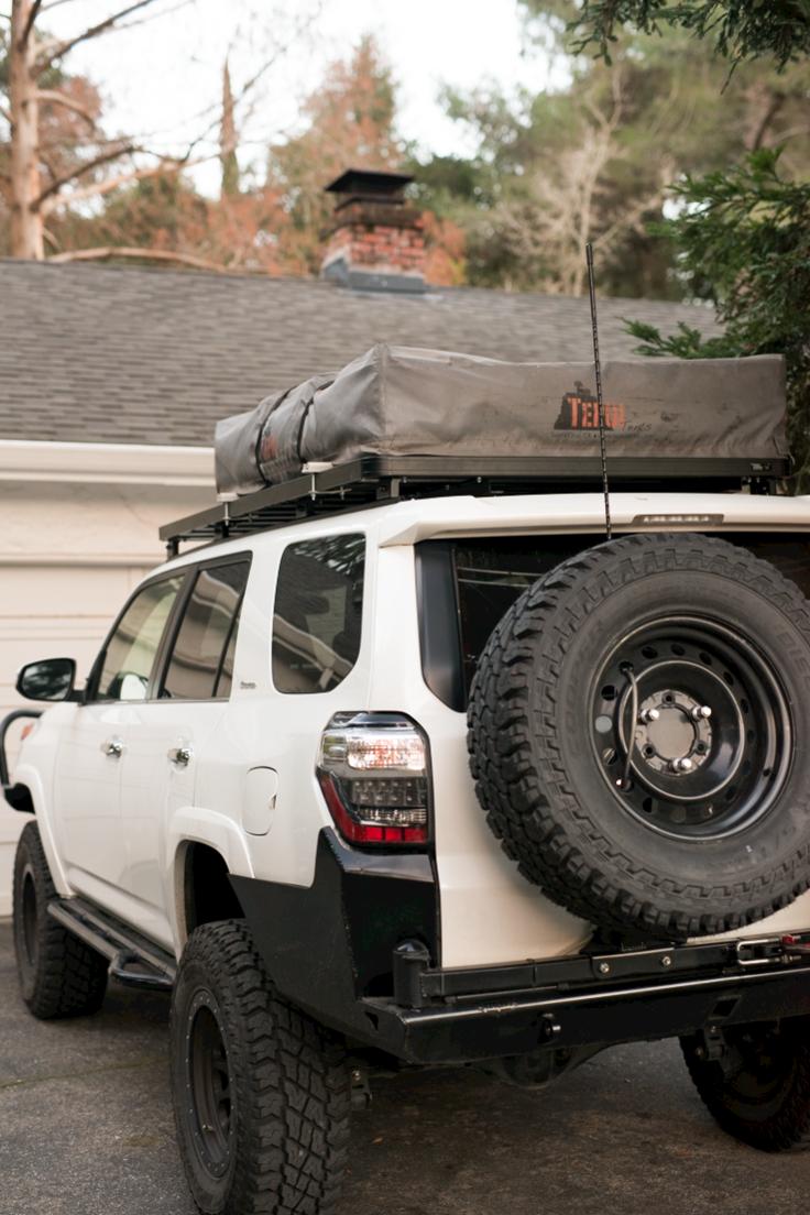

Added a rack this week, Front Runner with universal track and 40/50mm feet to keep things low profile.

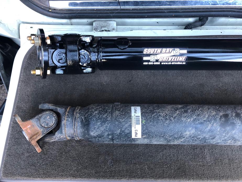

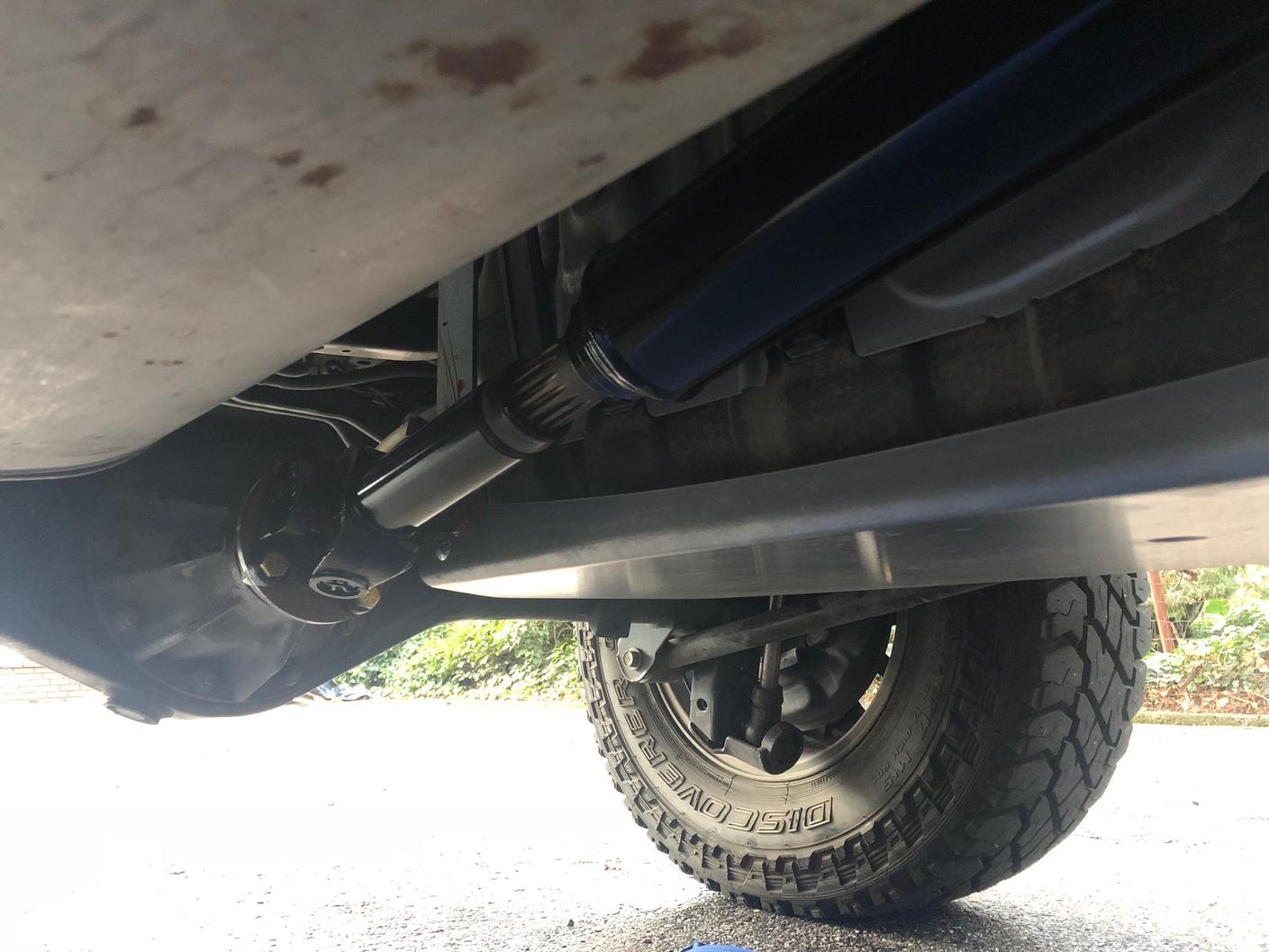

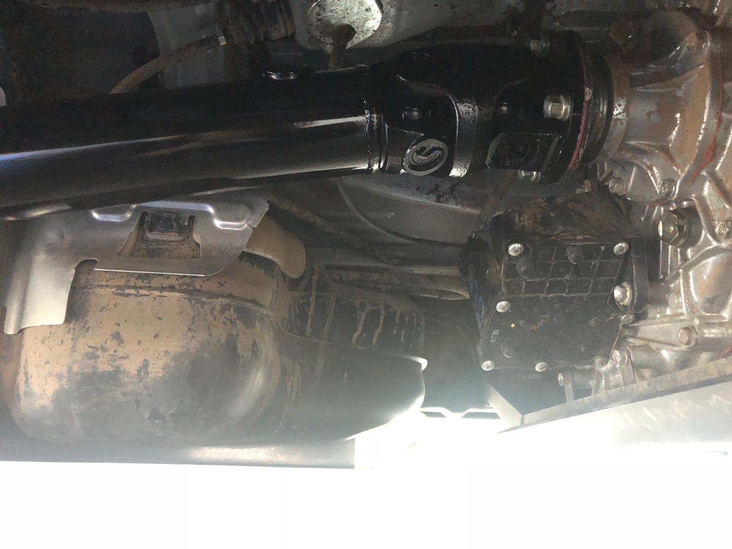

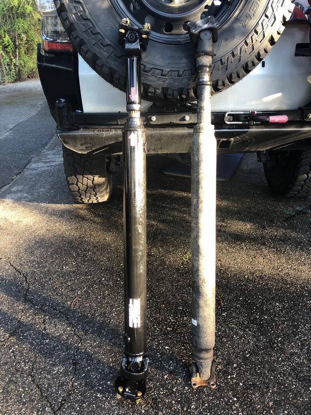

Some of you may know that I'm running Dobinsons C59-701V rear coils. These are a super heavy weight capacity progressive coil which works well for what I'm doing, but it does tend to ride high when unloaded. Small price to pay for having a decent ride unloaded while not bottoming out on the trail. When running light I'm a full 2.5'' taller than my buddy's truck on OME mediums.
Anyways, I've had a slight rumble grumble when coasting and after inspecting everything noted the transfer case side u-joint on my rear driveshaft was not super happy, weeping quite a bit of grease. I've been down this road numerous times and went ahead and had a rear double cardan shaft made. 1310 Spicer non-greasable joints have held up well for me on two other vehicles so went with them, my driveline shop wouldn't recommend anything else either and I've had nothing but good experiences with them so I trust their call.
Quick trip around the block and things are smoothed out, waiting on CaliFab to get me some rear links so I can tweak my pinion angle. Not too many discussions on here regarding double cardan shafts for the taller trucks so thought I'd throw this out there for anyone else in a similar boat.

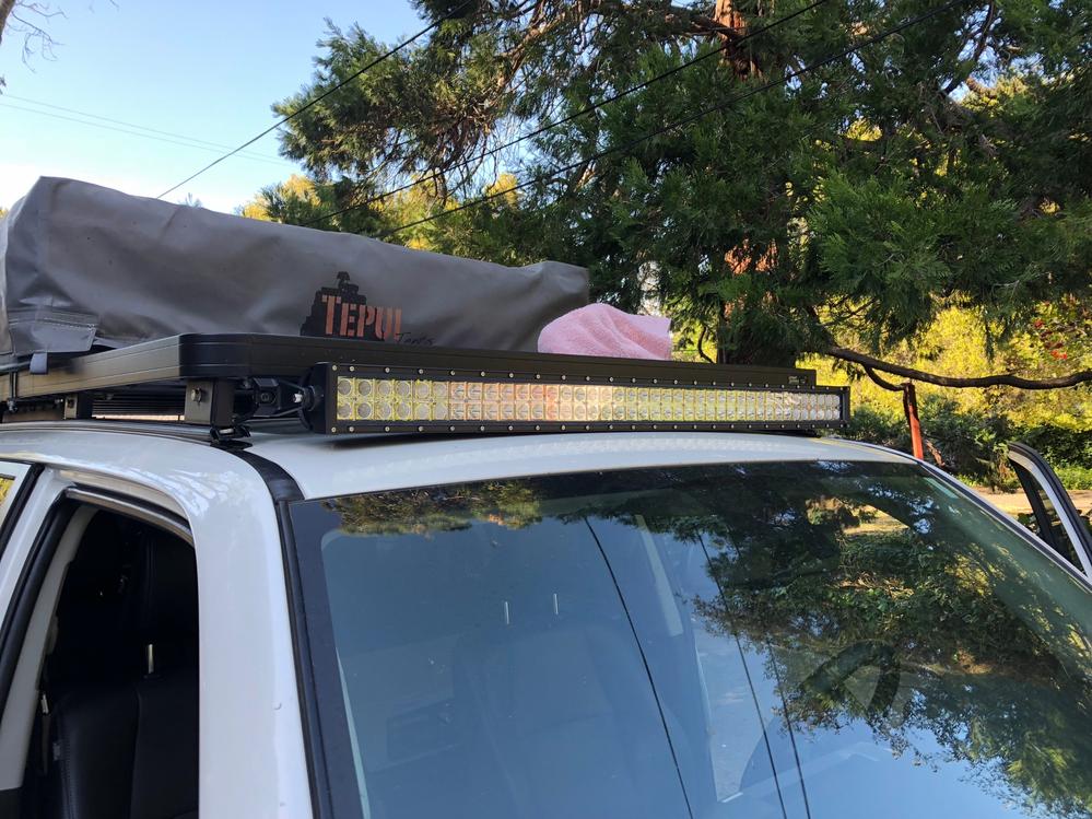

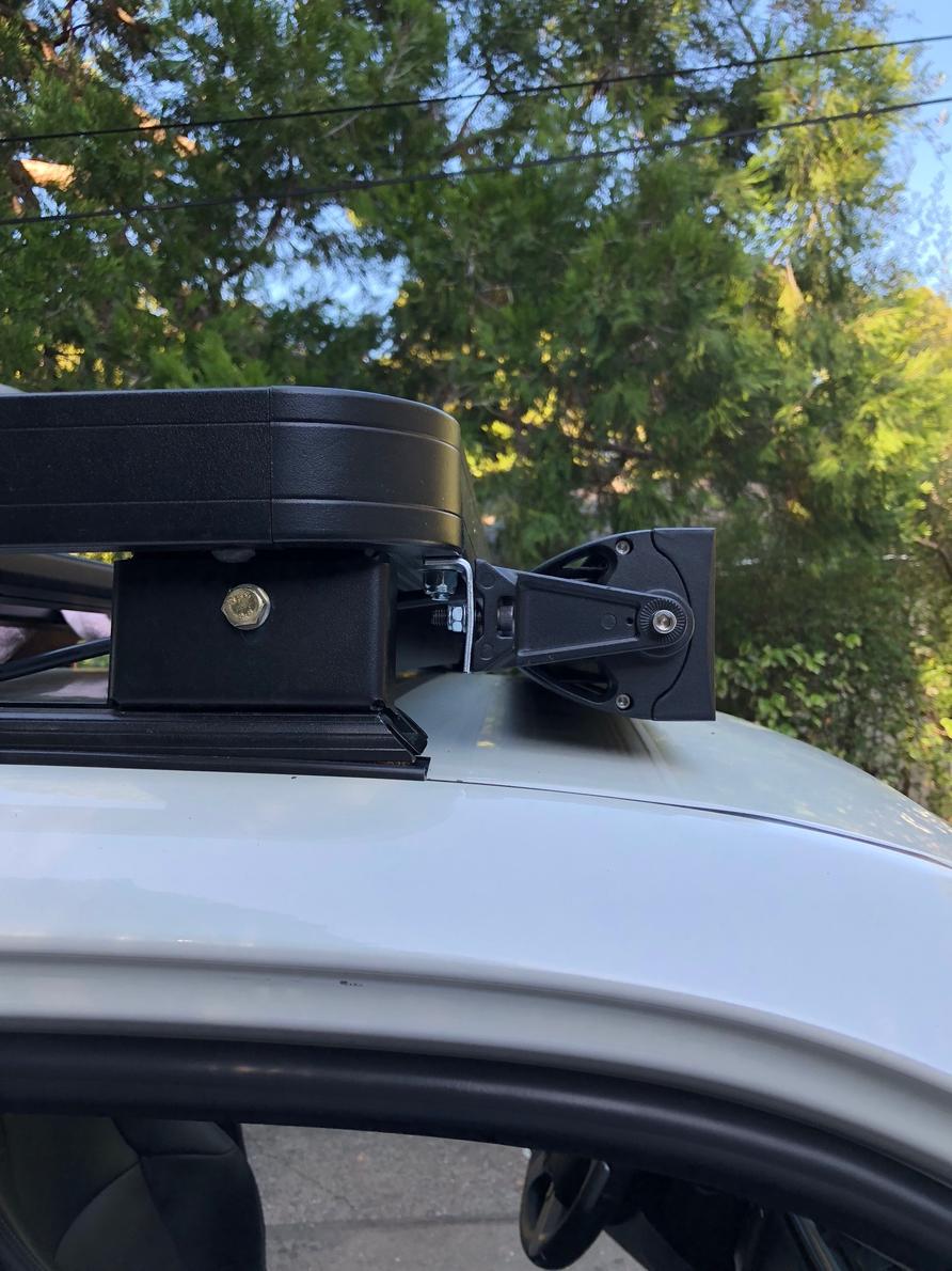

Got a $90 Amazon bar up. My primary motivation was to reduce wind noise, so it was this or a trip to the plastic shop to have a custom fairing made. It dramatically reduced noise at high speeds so I'm happy.
I'm a big fan of the T-slots on this rack, mounting the bar was effortless.. made some custom brackets to get the bar as low to the roof as possible.
We compared it to my brother's Rigid bar, obviously not as bright but surprisingly not bad either. Works for now, maybe I'll throw a BD or KC light source up later on.

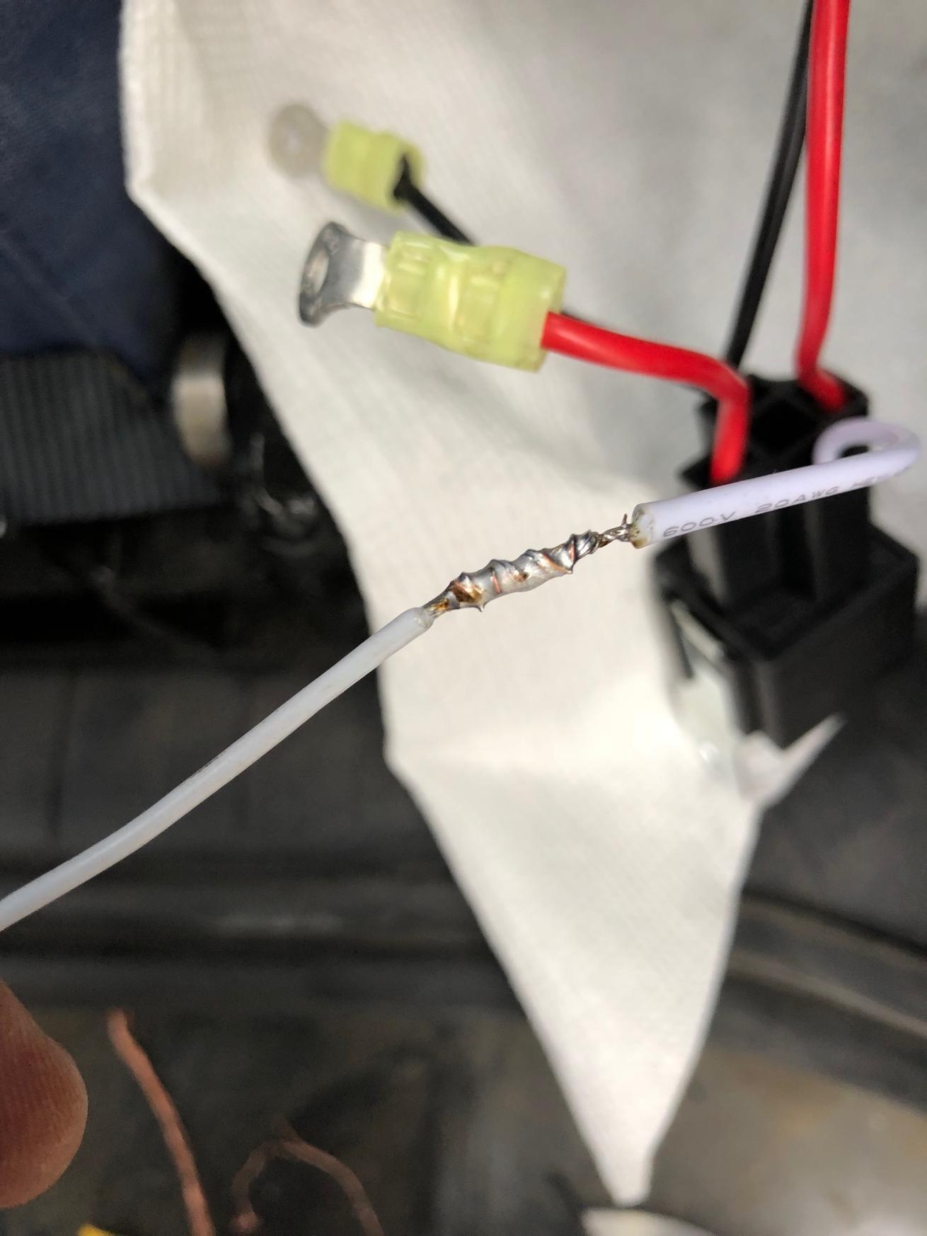

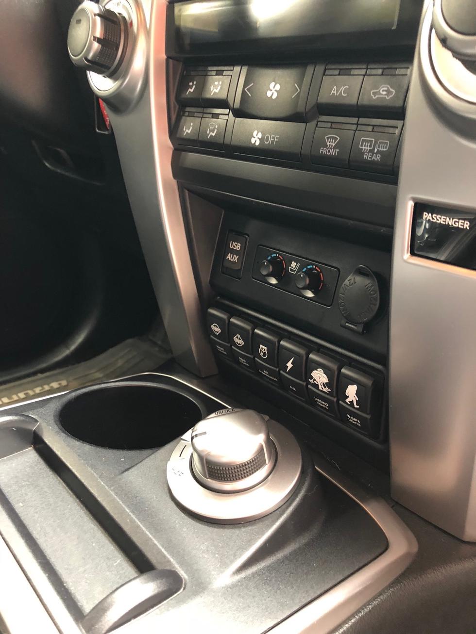

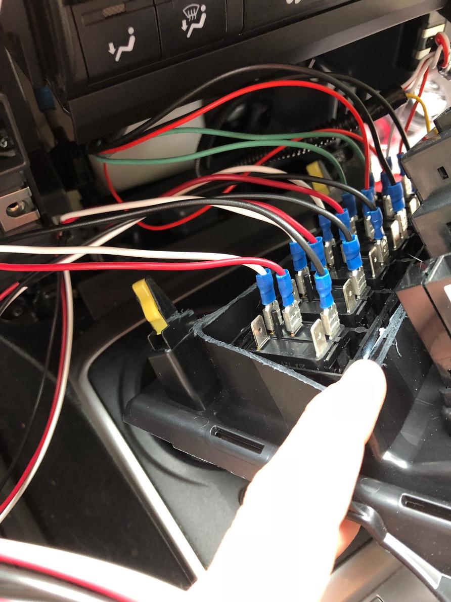

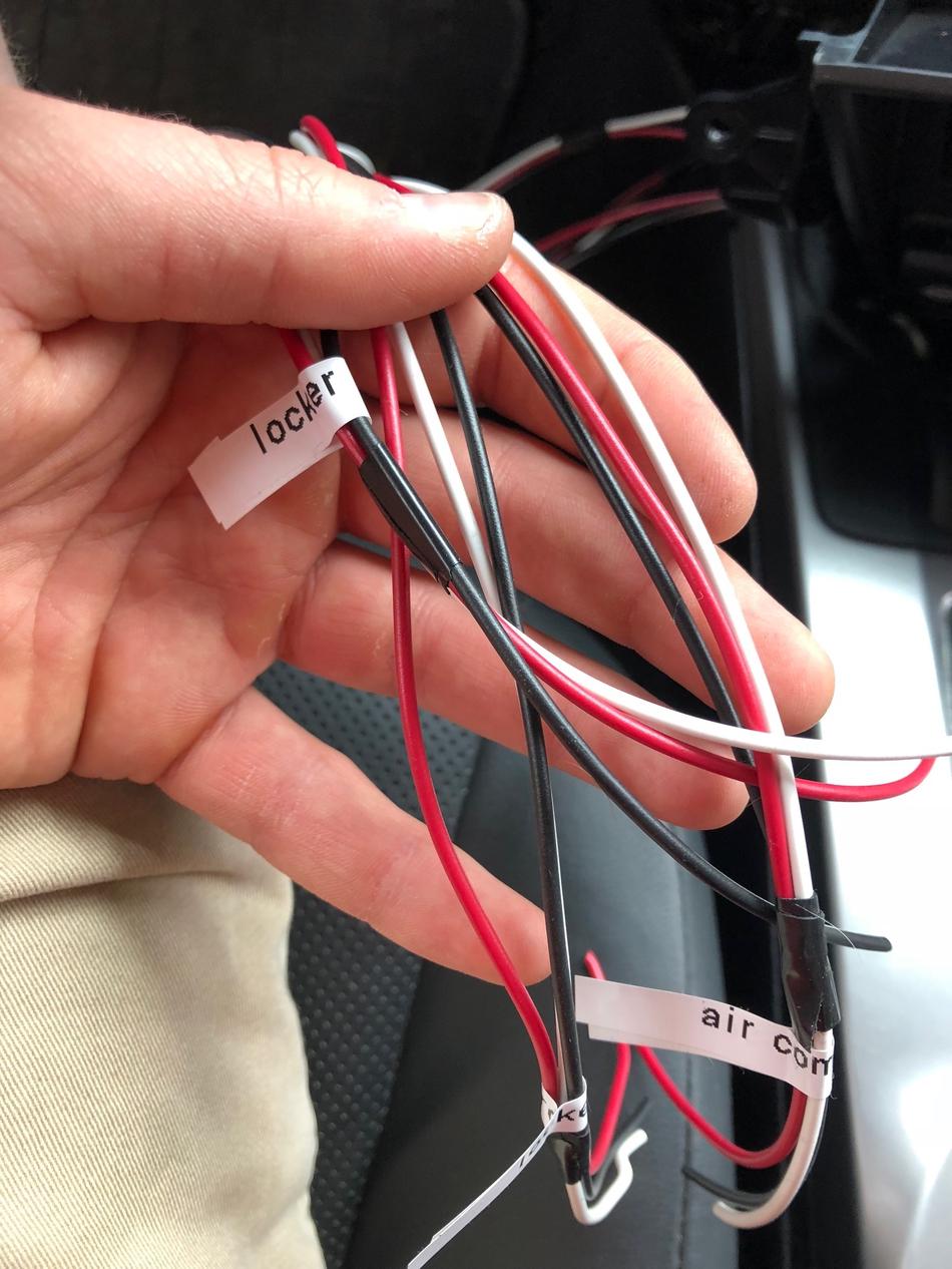

Completed some wiring work the last two days. Thanks to [MENTION=112177]4RnR Grl[/MENTION] for her Youtube video detailing how to pull the dash apart, it was a big help.
I mounted a 6-switch panel in the lower dash and hooked up an LED bar on the roof. Also pre-wired all the switches with labeled leads so I don't have to pull the whole dash apart as I add things. I'm loving how the 6-swtich panel fits in the factory location, somebody at Toyota must have been paying attention.
