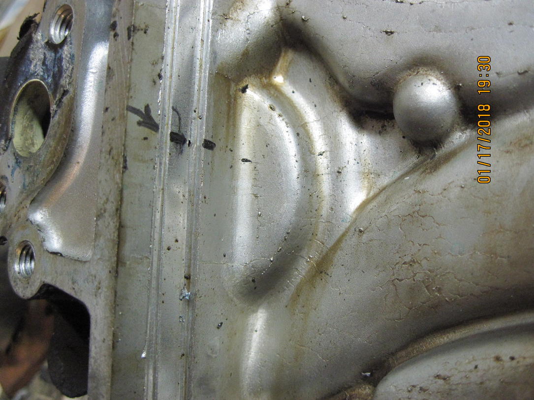

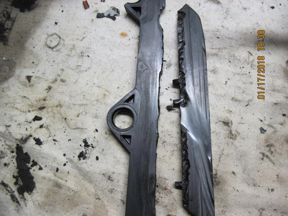

Me too: Coolant in oil
My truck didn't heat at all! And it was 45 degrees here in Seattle! I checked the radiator and there was no coolant! For 224000 miles my truck has always run! Put in water, lots of it and expected it to run onto the pavement, but noo, it ran into the oilpan. Boy! was my oil level up there. Drove home, pulled head, expected gasket, but noo! Took engine apart, found timing chain guide broken and timing chain had eaten grooves into timing chain aluminum cover. coolant pipe is just on the other side. Pic. attached
Sh*t!
How many miles are on the clock?

224000 miles on the clock and the mileage s genuine because I got the truck from a friend who bought it new. The good news is that the new chain guides are steel backed and have a plastic surface for the chain to run on. It should last the rest of my life. I tried to do a real good job and used Permatex aircraft sealant on gaskets and hoses. Pressure tested the cooling system and it was tight. No oil leaks so far. Knock-on-wood!
