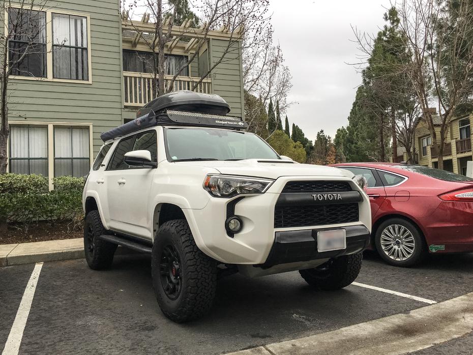

Prepping for a weekend trip to Lake Tahoe and put the Skybox on. Pretty sure I'll get about 10MPG on the way there.
:lmao:
I might just have a heavy foot because with just a lift, rack, and 34s I'm barely getting 16 freeway
