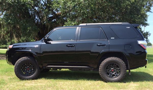

I'm riding on the 4th notch also.
They aligned ok. Caster was a little off because I tried to push it as high as possible (OEM is zero, I was shooting for roughly 2 degrees), but my toe and camber were spot on OEM specs. I think if I played with it a little more (or had caster set to 0) it would've been fine.
With a lift at 2.5", I'd recommend getting UCAs if you want to get better steering feedback because the increased caster will give you better straight line tracking and stability especially at highway speeds. I'm planning on getting UCAs soon.

I just received my Light Racing UCA's and am getting ready to install my lift. I'm debating between the 4th or 5th clip in the front.
I'll be running Bilstein 6112 in front with the 5160's in the rear along with the Toytec superflex springs. I've got the TRD wheels with the BFG KO2's 275/70/17 sizing. I'd like about a 1/2 to 3/4 inch rake in the rear but not quite sure where it will end up running in the 5th notch.
Have you thought about going to the 5th notch up front?

You should be fine with either one. Honestly if you're sticking with 275 I'd keep it on the 3rd or 4th notch- just my personal preference because of the wheel gap. I think [MENTION=103267]Saker[/MENTION] is running this setup and it looks awesome.
I haven't thought about cranking it all the way up yet. I get pretty good clearance with my 34s and the CV angles are pretty good so I'll probably leave it alone.
I'll post up some side profile pics when I get a chance.

I am running my 6112's on the middle circlip groove 5160's rear with stock springs and 265-70-17 KO2's for shoes.
That leveled my T4R.
saker-albums-saker-s+midnight-picture35243-6112s-5160s-2-lift-bfg-ta-ko2s-%40-park.jpg
hope this helps!
