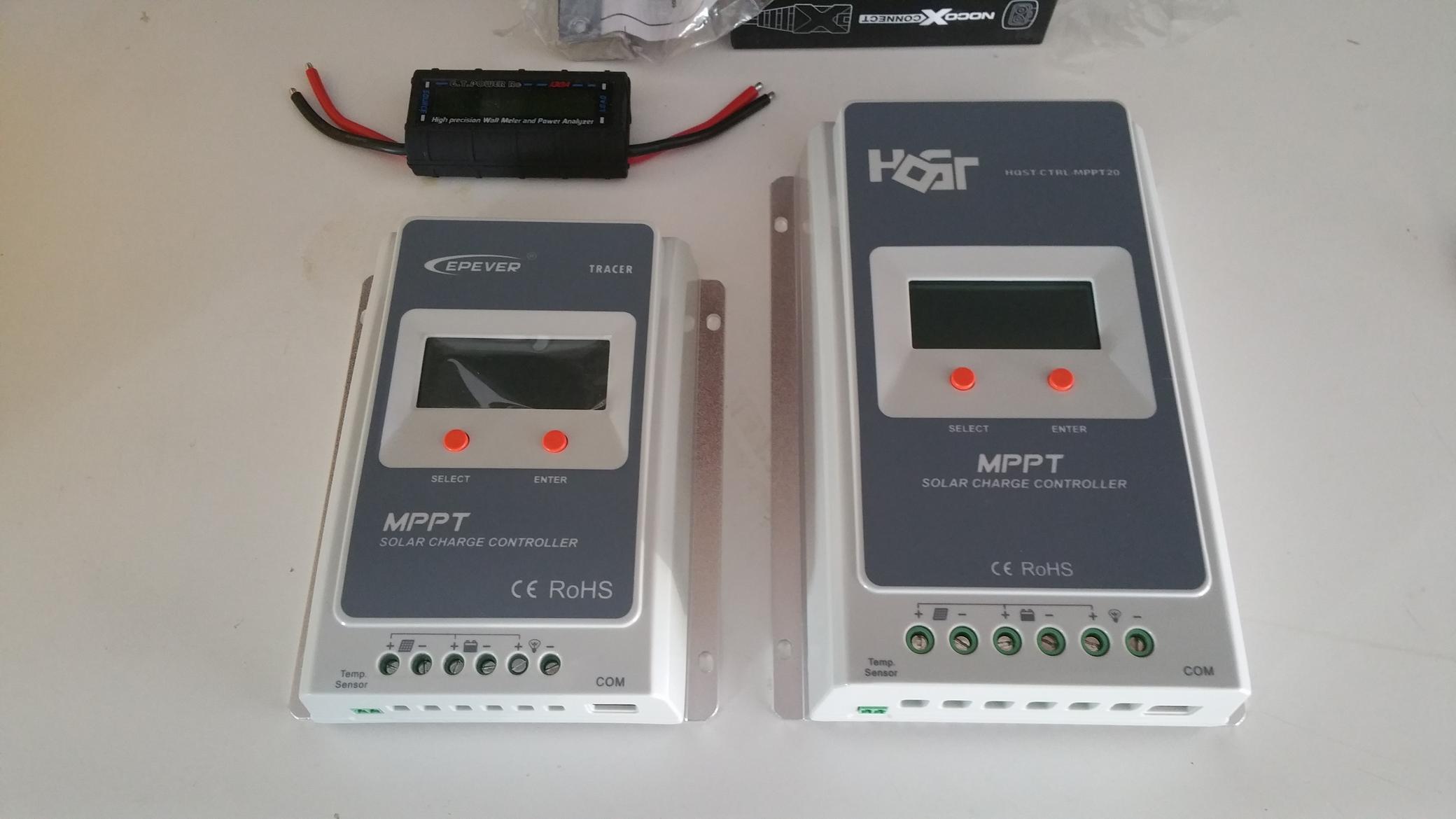

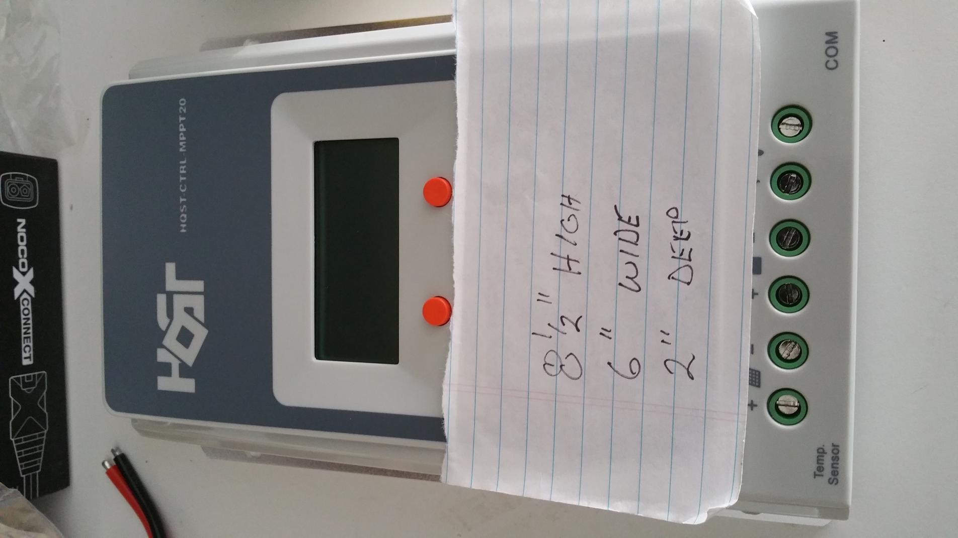

Found both controllers, ...one a 10 amp one a 20 amp. Will post the sizes for you, but the picture tells the story. I was originally planning to put the controller inside...will get a little more detailed once I start my solar build on the rack.

Ah- that makes sense. I might look into upgrading trays at some point in the future then. The controllers look great- pretty compact. I'll look forward to seeing more about them when you start the solar build underway.

The difference between a 10 amp and 20 amp MPPT controller
