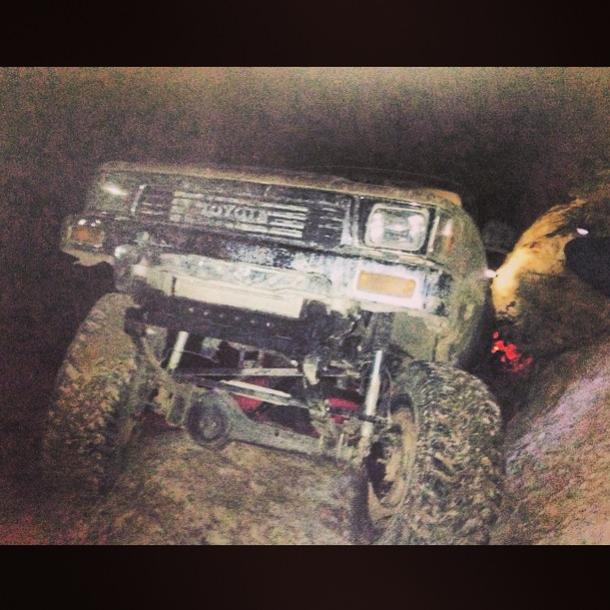

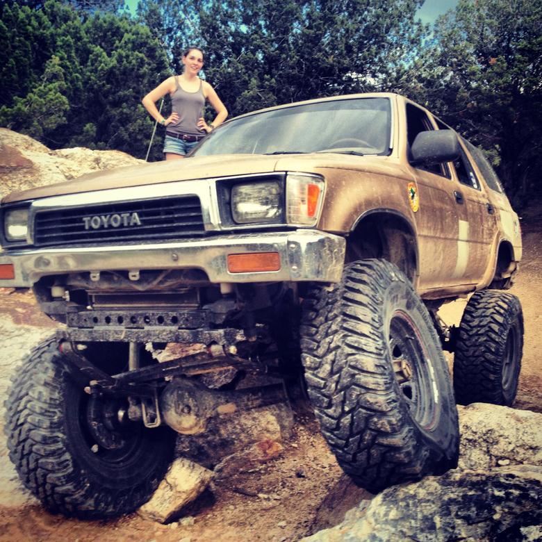

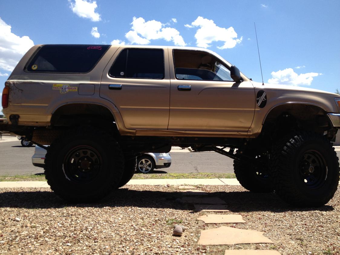

New to forum. Been on Pirate for years but never knew this forum existed. Here are some pictures of my rig. I still have alot of left over IFS stuff if anyone needs it - including a tru-trac IFS diff with 4.88s and a set of 33x10.50x15 KM2s with 90% tred left. I am in southern AZ
The rig is a 1990 with its third 22re. Chassis is about 300,000 miles. It has dual ultimate cases SAS. 5.29s and detroits front and rear. Hy steer and custom triple stick shifter. It sits on some 37x17s and has taco brakes up front. Used some creativity and 1.5" body lift/drive train lift to clear its new shoes.
Next on the list is lighting, dual batteries, armor and tire carrier.

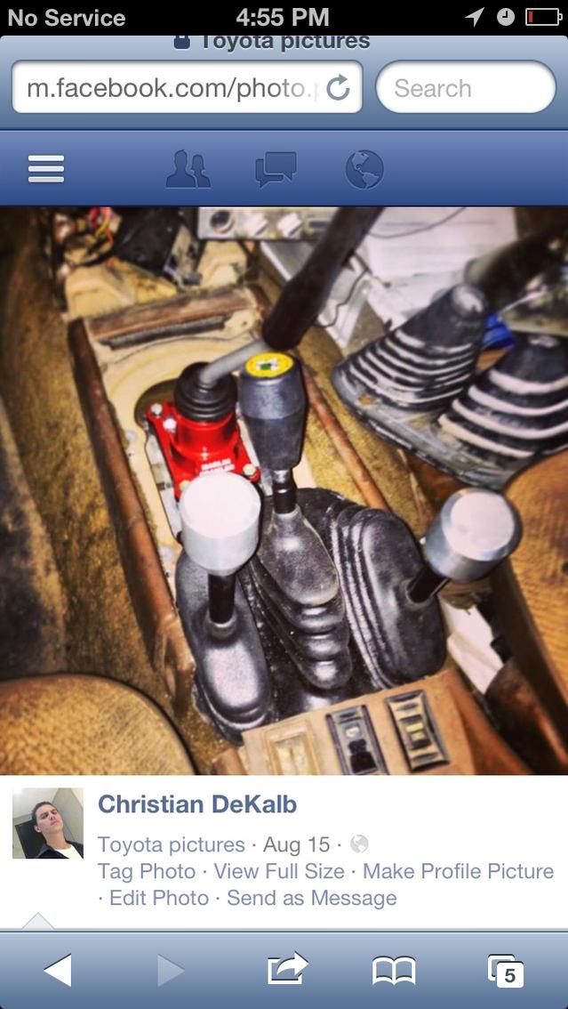

No adapter. I blew my third gear out of my stock Trans in downtown LA last year doing donuts like an idiot. Had to drive all the way back to tucson like that. Thing finally siezed 20 yards from my driveway in Tucson. Found a G54 with a tcase bolted to it on CL for 150. Was pretty gnarly looking so ripped it apart and rebuilt and sealed it. At the same time upgraded the case to 4.7s and converted to top shift. Put a built case from marlin in the middle because couldn't find a junker for decent price and the heart of my build was spawned. The hardest part was getting the triple shift to work. I'll post some pictures of the interior when I get back to my hotel. I think it's pretty slick.

My interior is almost finished. I don't have any pictures of it here. Here's a picture from FB when it was still being assembled
