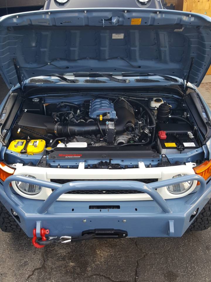

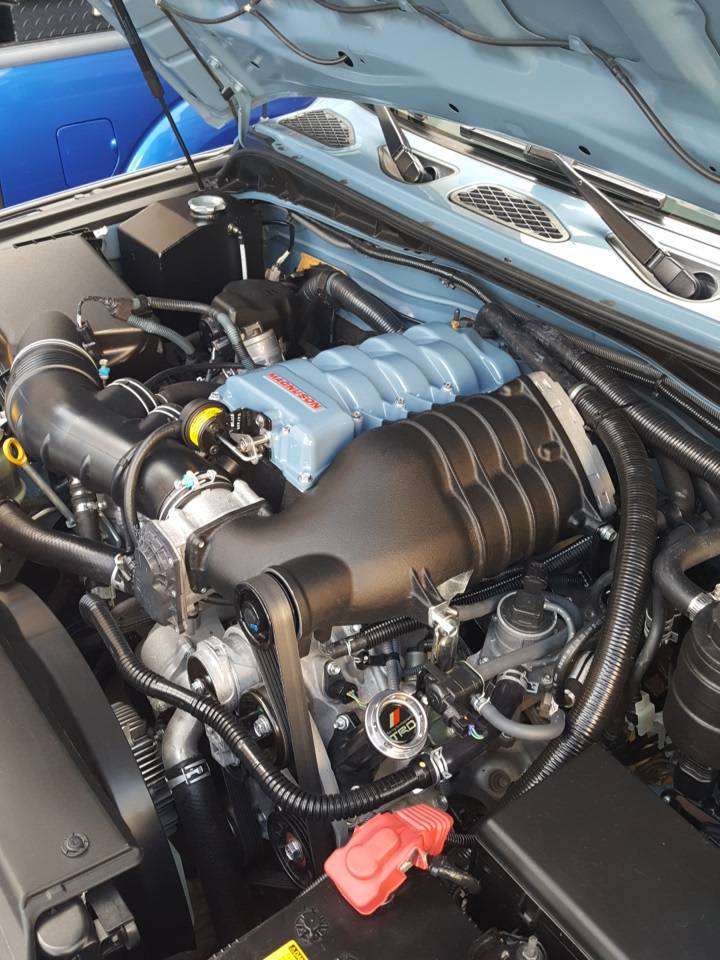

Since its the install and results thread. Here is my finished shop truck a 2014 TTUE fjc. The only one in the pilot program out of the 10 kits. Also body color matched. Its all smiles per gallon now.
