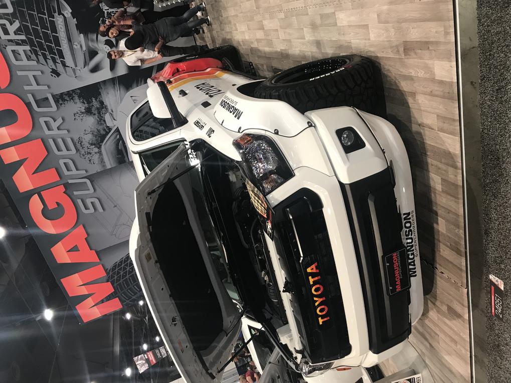

Had a chance to talk to Magnuson at the SEMA Auto Show this past week, the rep said a stock 4.0 was dynoed at 250, increased to 336 hp with the supercharger. Can’t remember the torque numbers. Pretty awesome group of guys.
Supercharger
Those are awesome numbers from the guys at sema, been following this thread and look forward to some real world data once they get it dialed in completely. This will be a future upgrade for sure.
