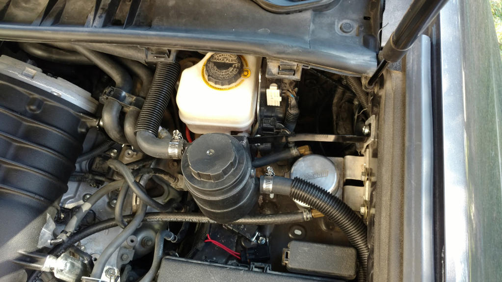

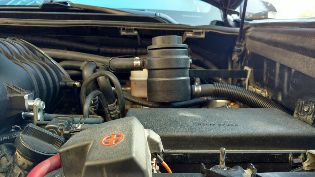

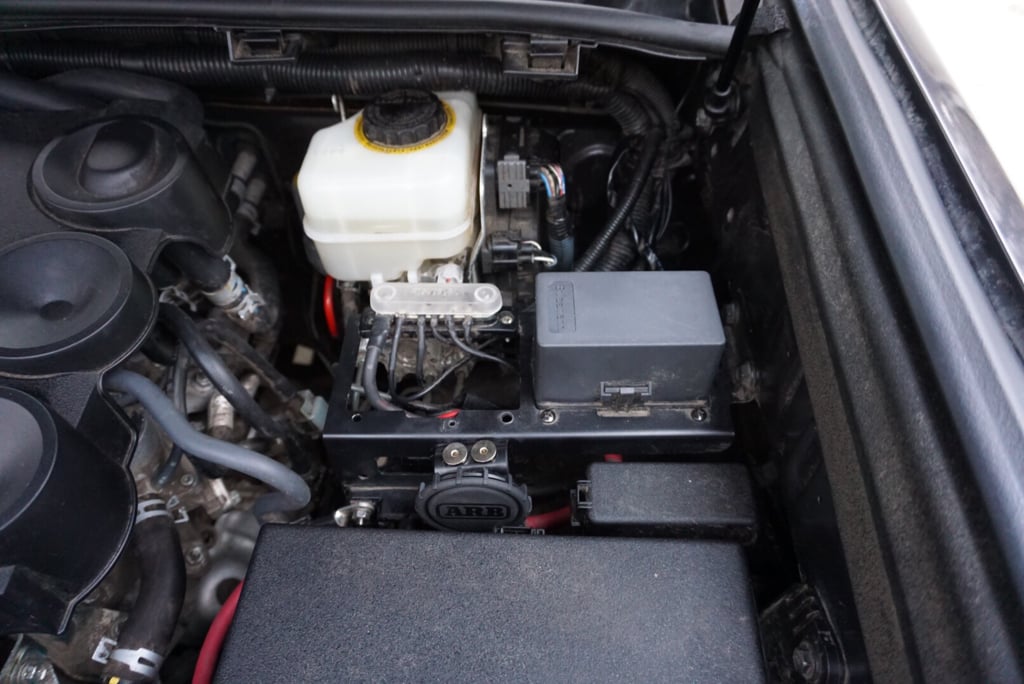

So quick question/favor. I have a shrockworks relay bracket and a bussman with all of the damn circuits already wired. It would take days to remove and reword. Can you post a picture of the coolant reservoir bracket that bolts into the fender behind the factory relay box. I am trying to figure out how creative I am going to have to be during the install.
Here’s what I have
Here ya go. It can really go anywhere... Just needs to be high enough... The bracket bolts to the fender and to the master cyl bracket...
