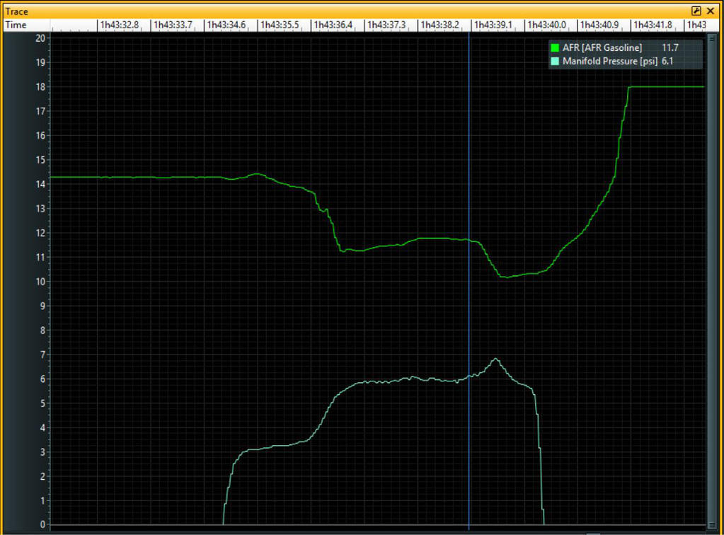

Here is a little bit of data from last night.
Interesting observation is that the truck seems to run at 14.3:1 in closed loop. I noticed a similar Lambda number when I checked the FJ via TIS.
My WB is reading right after the cat, but if anything it would read a tad leaner than actual.
If these things really run at 14.3:1.. it explains a lot. Strange for sure in terms of fuel economy. All my others vehicles with WBs stuck it at 14.7 or even drifted the boundary more often lean. I will say this truck seems to lock it in with almost no movement... Makes sense.. not having a narrow band to deal with for feedback.
Anyway, I will be verifying all this with the factory readings soon and hopefully finding the RPM signal.. and see what type of data rates I can get off the CAN bus.
Any chance of explaining this in child mode?
it's nothing more than a small timeline of Air fuel ratio on top, and boost on the bottom.
It's not that useful overall, but you can see as boost got to about 4psi AFR dropped close to ~11. Then rose closer to high 11s as boost hung around 6psi. Toward the end boost approached 7psi and AFR dropped even more, but I'm guessing this is right when I let off. You will see AFR go very lean at then end when boost goes to 0, but that is because the ECU switched to decel with the foot off the gas completely. It proves nothing more than that the tune is very safe and there is plenty of fuel.
I hope to at least get RPM logging over the weekend which will make the graph much more useful. End goal I would like to see If I can get speed, timing and other samples in it, but this could be challenging.
You mention lambda but show AFR. Are you using ethanol free gas?
I don't understand your question as it relates to ethanol..exactly. Of course I'm running 93 octane pump gas that has up to 10% ethanol in it..
The reason I said Lambda.. is that is what TIS reports with no conversion. My WB is displaying Lambda as gasoline AFR. So 14.7 is 1.0 Lambda... The fuel being run has no impact either way... it's all relative to the scale being displayed. All wide bands measure lambda.. I just like thinking in the gasoline scale since it is what I have always used.
That's really nice to see. I was wondering if it would have some of the lean issues associated with the BD tuner used on the Tacoma and Fj's. Looks like the they hit a home run on this one with the tuning. PS thanks for sharing all the extra info looks like I might be installing a charger on my Runner.
