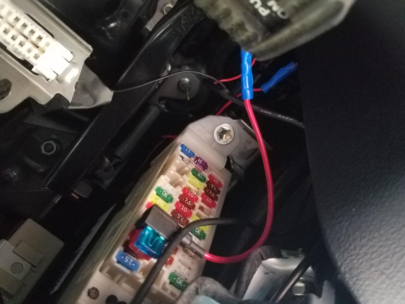

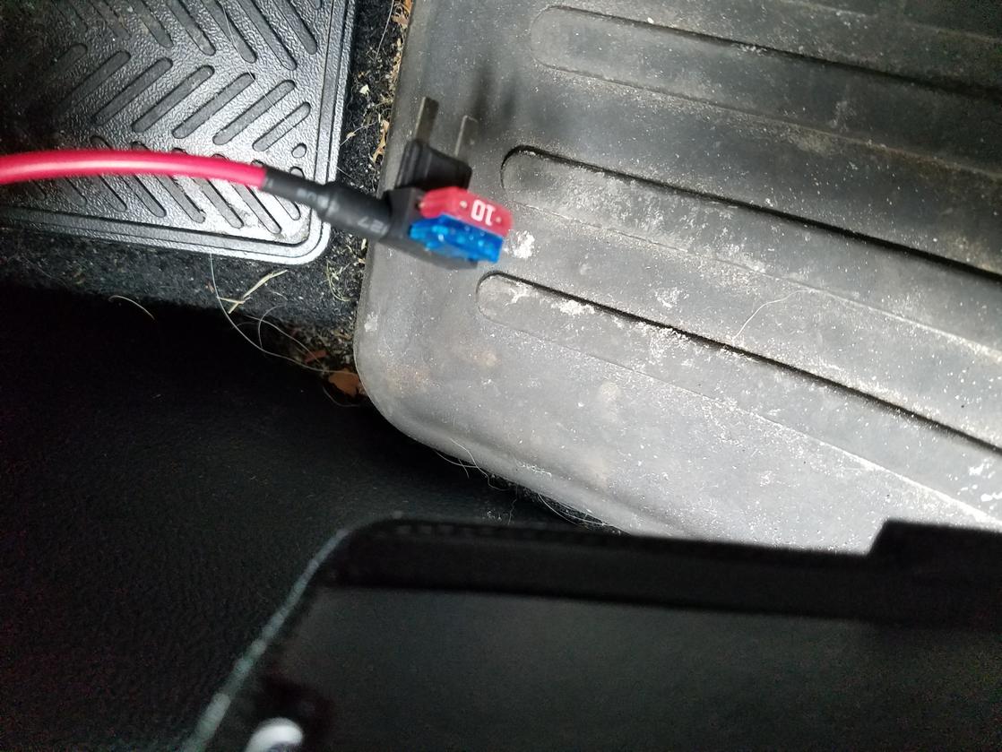

Trying to install a hardwire for a dash cam and can't get power to it. I have tried two different dash cams, two different hardwire kits, and two different add a tap fuses. On my current attempt, I am using an "E Support 12v Car Add-a-circuit Fuse TAP Adapter Mini ATM APM Blade Fuse Holder." I crimped the power line from the hardwire into it. It came with some fuses so I put one on the back of the holder, and then took a 10amp fuse out of the "TOWING BKUP" slot from my 2016 4runner. I then put that fuse in the empty slot on my tap a fuse and plugged it in. I grounded it by running the ground wire through a metal hole near the fuse box and then covered it with electrical tape. On my other install I ran the ground wire through one of the rear bolts. No power on either of them. Am I using the wrong fuse slot or doing something else incorrectly? Thanks for any help.

I'd suggest getting a multimeter and ringing out the wires. Check your ground and confirm you have 12v power at your fuse. It doesn't sound like you have a good ground if you just taped it in a hole.. look for something paint free, any mounting hardware or screw into the body work should suffice- again check it for continuity to ground.

The add-a-fuse in the picture looks like the wrong size to me - I tried those originally, and although they'll plug in the connection is bad and they fall out easily. I'm using these:
https://smile.amazon.com/gp/product/B00EO571Z4/ref=oh_aui_search_detailpage?ie=UTF8&psc=1
and one's been in for months now without issue. Make sure you buy the right mini fuses as well (pull one out to compare - they're conveniently the same as the truck's normal fuses).
For placement, I'm using the 15amp socket at the top left if you're looking up at the panel - it's marked ACC on the cover, and is one of the only ignition switched slots. Make sure you put the fuses in the right slots - I had a 7.5amp one in what I thought was going to the camera, and then popped it plugging a compressor into the cigarette lighter. Whoops.
The bolt at the top of the fuse block (visible in your picture) is grounded - I just used a crimp ring connector for my ground. The box is clipped in as well, so it won't fall out when you take that screw out.

I'm not sure what that blue fuse is on your add-a-fuse, but I noticed something I was doing wrong when hardwiring my Blackvue CH-100B. The red 10A fuse was in the wrong slot. On mine I just put two on it, and it works fine.
The add a fuse is a larger size than the mini profile that come in the 4runner. I can put the add a fuse in the 4runner fuse panel just fine, but the fuses that go in it I don't think will fit in the 4runner fuse panel. I didn't think that mattered. I'll try to order the one you recommended and see if that helps. I really appreciate the picture and help. I was wondering if I could use that screw you said you are using as well, but didn't know since it was touching plastic.
Since I'm going to plug it into that 15 amp slot, I put the original 15 amp into the add a fuse, and then do I need to buy a 3 amp low profile fuse for the other slot?

You must have a proper ground before you can start troubleshooting.
Go behind that bolt at the top of your first picture (the bottom bolt holding on the fuse block)

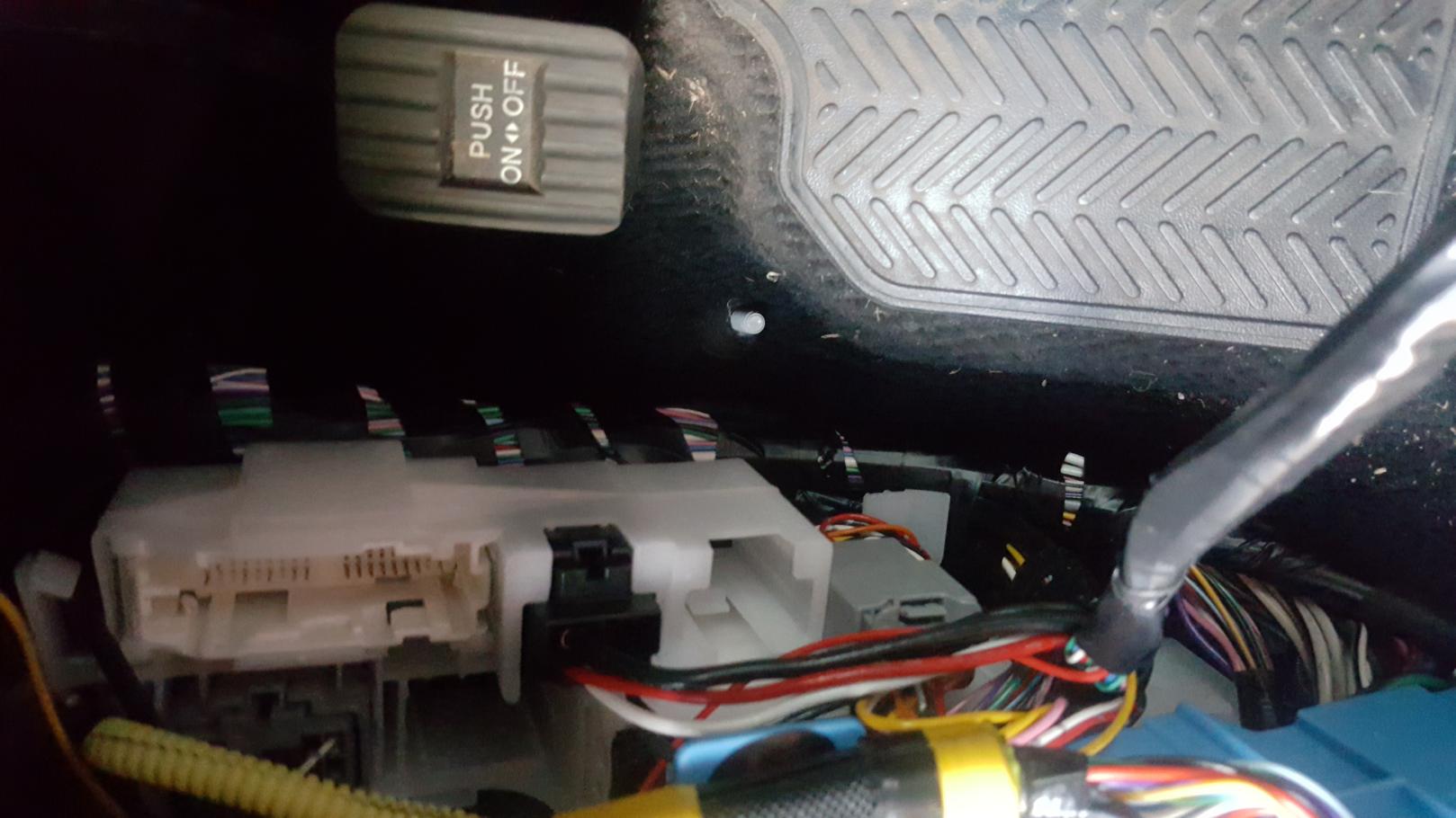

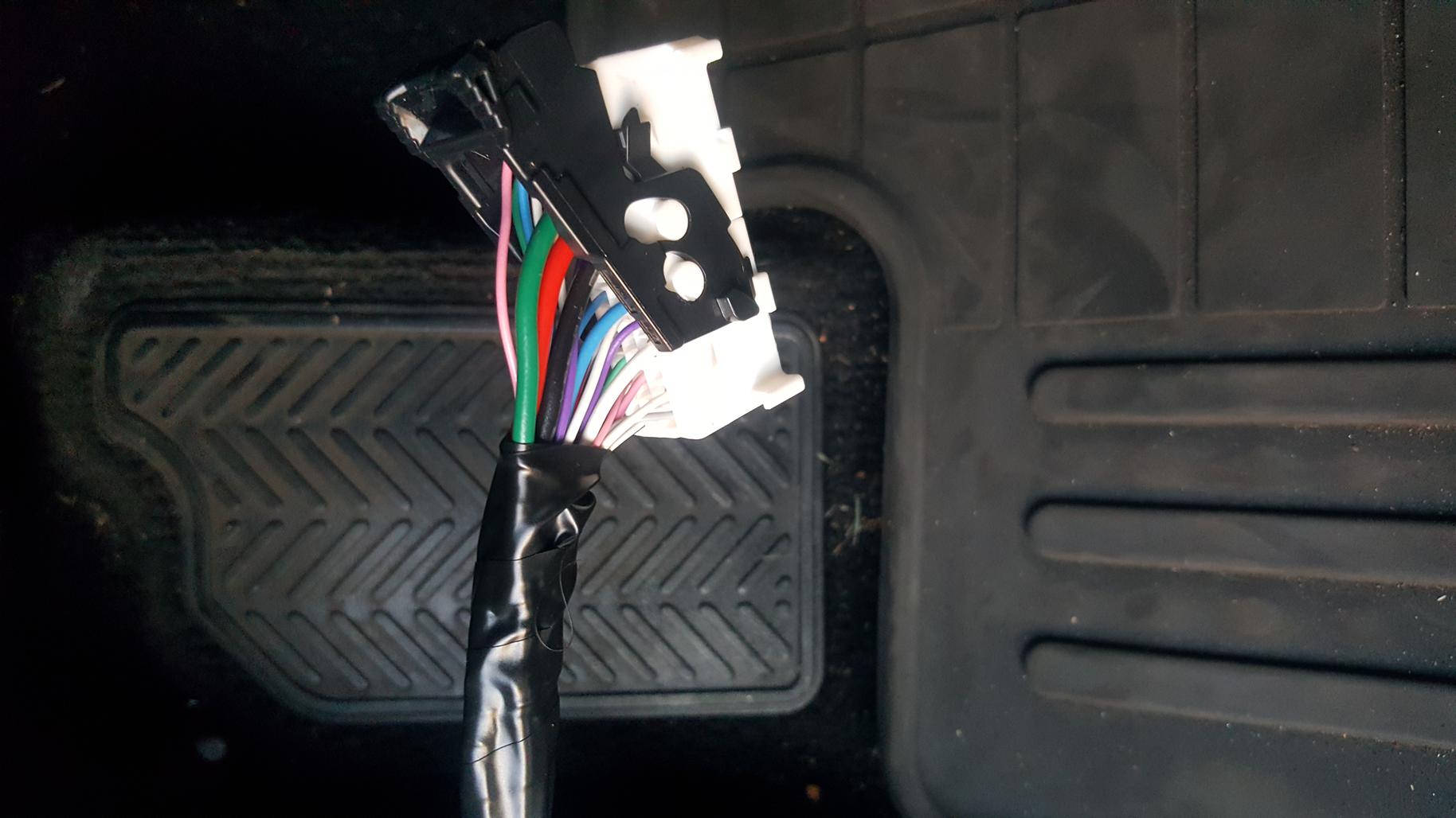

This is how mine is wired the line runs off the fuse box to this another connector under the driver side kick panel (the white box). Be careful removing the wire loom as there is a switch to remove the clip and pulling on it without pushing the tab down could cause it to break. Sorry I'm no electrician so I can give you all the technical names, again I got a bunch of help on the install from Pops. He tapped the power wire (hot wire) into the green wire and the ground wire into the black wire in the loom. These were soldered and shrink tubed and ready wrapped into the loom. These wires that are running to the loom are coming from my Power Magic Pro
Power Magic Pro BlackVue Vehicle Battery Discharge Prevention for Parking Mode for BlackVue DR500GW, DR550GW, DR650GW, DR650S https://www.amazon.com/dp/B008B8ERIO/ref=cm_sw_r_sms_apa_ynD6xbKXXMQHR
Then the camera is wired to the power magic pro. The power magic will turn off power if the battery gets too low on voltage. I have been running the camera for over a month now with no issues and no dead battery
