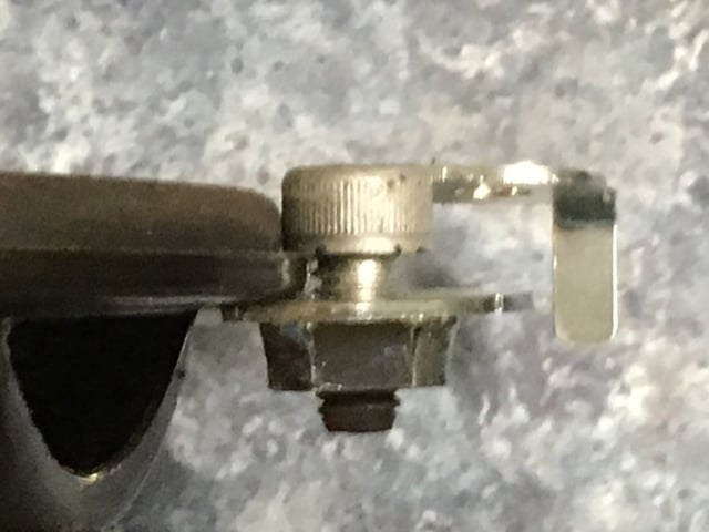

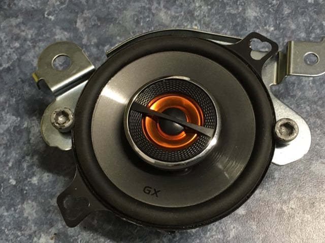

Am I gonna get thrown out of the 4Runner audiophile club if I do this? This Allen screw has the same pitch as the factory screws, but a small enough head that they just catch the frame of the speaker.

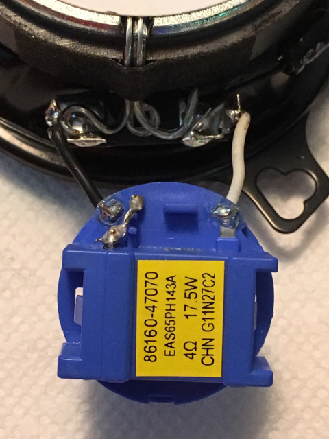

Got my connectors moved over to the new speakers (GX302). Black to (-) white to (+).
Label on the connector (just now noticing) says 4 ohm. Why is everyone so fixed on 2 ohm speakers?

I would be worried about them coming loose over time due to vibration and what not. Not very much surface area holding them in place like that. You know?
2 ohm is the total resistance on the front because the door and dash are 4 ohm wired in parallel.

Right, but that doesn't explain why people are fixating on these 2.3 Ohm speakers when replacing the dash, or "settling" on 3 Ohm alternatives. The 2.3 Ohm speakers drop the channel load to 1.46 Ohms.

Yeah that's a question. On one of them, I took a washer and bent the edge 90 degrees but with the hole still flat/intact and put that under the screw. The vertical edge of the washer is down on the inside edge of the speaker frame, so acts as a spring washer under the screw. I'll do that to the other screws as well. Unfortunately didn't take a pic.
They sound great, though!
