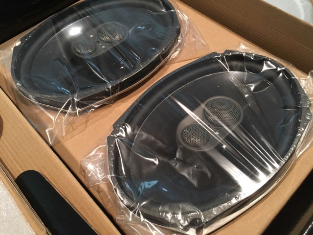

I just ordered the JBL GTO938's off Amazon Warehouse for $43/pair.
JBL GTO938 6 x 9-Inch 3-Way Loudspeaker
Sold by: Warehouse Deals, Inc
$43.00
Condition: Used - Good - Item is in original packaging, but packaging has damage. Medium (less than 1" x 1") cosmetic imperfection on top of item.
Not bad...

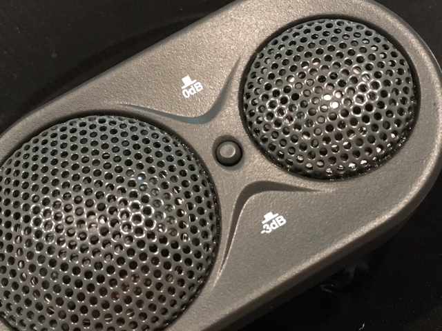

There's a -3dB switch in the tweeter so I'll probably enable this to get the highs in the dash speakers.
