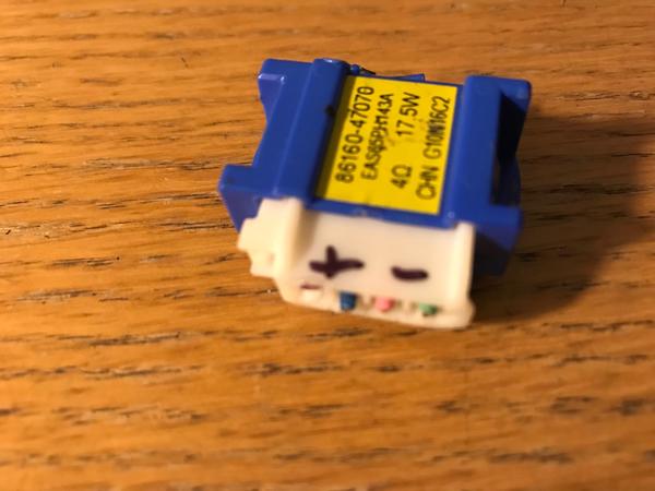

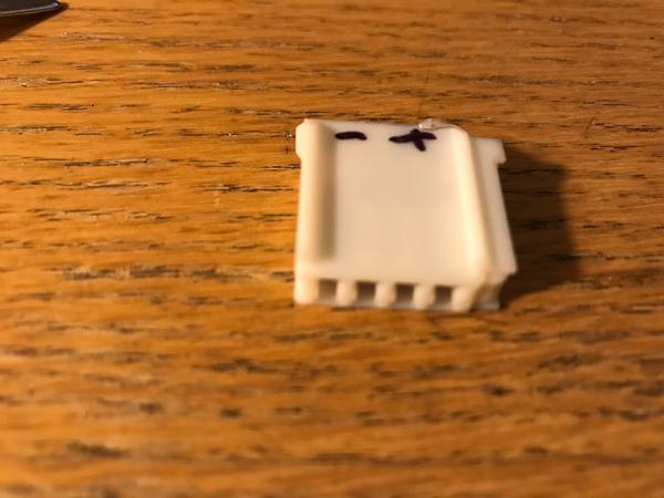

I did this infinity swap back in 2012, at the time there were no adaptors I ended up cutting off the connector, now years later I am trying to restore it back unfortunately, I had cut the connectors too short(see photo), I just thought I would post here to see if anyone knows where I could get a new connector and pins. toyota doesn't offer and all I find are the female versions. Anyhow, I figure if anyone knew it would be here.
This is why I cringe whenever I see people cutting stock wiring harnesses! I think a junkyard is probably your best bet. Just remember that the 4Runner is not the only vehicle to use that connector (I think Corolla and Sienna also?), so I'm pretty sure with enough searching you could find a couple.
[MENTION=73075]axxman[/MENTION] - Look for a number of some kind on the connector. If there is one, Google it, with the word “connector”. I did that with a switch on my wife’s Honda. That part wasn’t listed in the Honda parts list. Turned out, they were available on Amazon, eBay, etc, for just a dollar or two. Worth a try.

Thanks guys, but I am afraid there are no numbers on it, and I cut the wires off flush. I am in the middle of scrolling through the 30-40 pages of connectors on the mouser website, and I am going to see if the one from a sequoia can be modified to fit. I will post photos if it works.
*****update****** It does work but I forgot to take a photo. I did the passenger side.
note, I ordered another one, this one came from a camery I think, the wires were thinner, I put it in on the drivers side, it did not solder as well as the one from the sequoia, I found another one from a sequoia on fleabay and ordered it. I want this to be the last time I do this.
Note 2 Toyota wires up the dash speakers out of polarity compared to the rest of the speakers. if it matters to you, switch the wires from the tweeter.
well I got some good news,
I recieved the toyota sequoia off ebay and the connector turned out to be very close. not an exact fit but after a little trimming, it plugs right in there. now I just need to solder the wires back to the factory harness.
