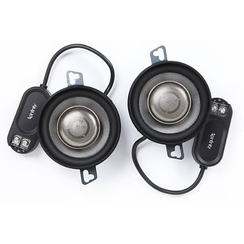

I ordered those speakers. Question, are these the same ones the OP installed. Also, I haven't installed speakers in a car in 15 years. What are the things attached by the wires to the speakers? Looks like the terminal but ive never seen speakers like that. Where do they go in the install?

[/QUOTE] What are the things attached by the wires to the speakers? Looks like the terminal but ive never seen speakers like that. Where do they go in the install?

The Youtube video posted by Toyko sells me further but it does not say what the thingies attached to the wire are. What are they? I'm thinking about getting them for an older 4Runner that uses a 4" speaker in the dash.
Those are crossovers. They basically protect the speaker from sound frequencies that it cannot play. You just tuck it into the dash under the speaker when you install them, or get fancy with some 3M tape so it doesn't rattle. :beer:

I’m thinking about using spade connectors for my speakers and was wondering what type of wire connectors, if any, have you guys used or recommend?
I was going to "do it correctly" and use spade connectors, however the terminals on the Inifnity crossover are just the set screw type, not really the type that work with spade connectors.
Really I should have used some ferrules (Panduit Corp. FSD80-12-D Single Wire Ferrule), but I didnt have the crimper at home and I was lazy.
For the Infinity crossovers specifically, I think you'll be fine doing the ol' twist and shuff, as long as you make sure you have both wires locked down under the set screw. Give em a good tug after you tighten the screw.
