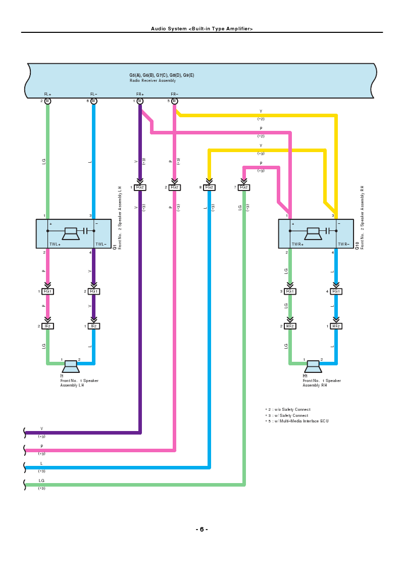

I guess you figured out the wiring then....We have the wiring diagrams online here.
On the Limited's with JBL ,green is pos and blue is neg .
No. 1 speakers are the dash and no.2 speakers are the doors.
Ya, I just stuffed a bunch of foam insulation all around around mine with the crossover in them. One of the most instantly noticeable, easy and fairly cheap mods out for the 5ths.
Front speaker(dash) wiring diagram for Limiteds with JBL

Thanks harper.
