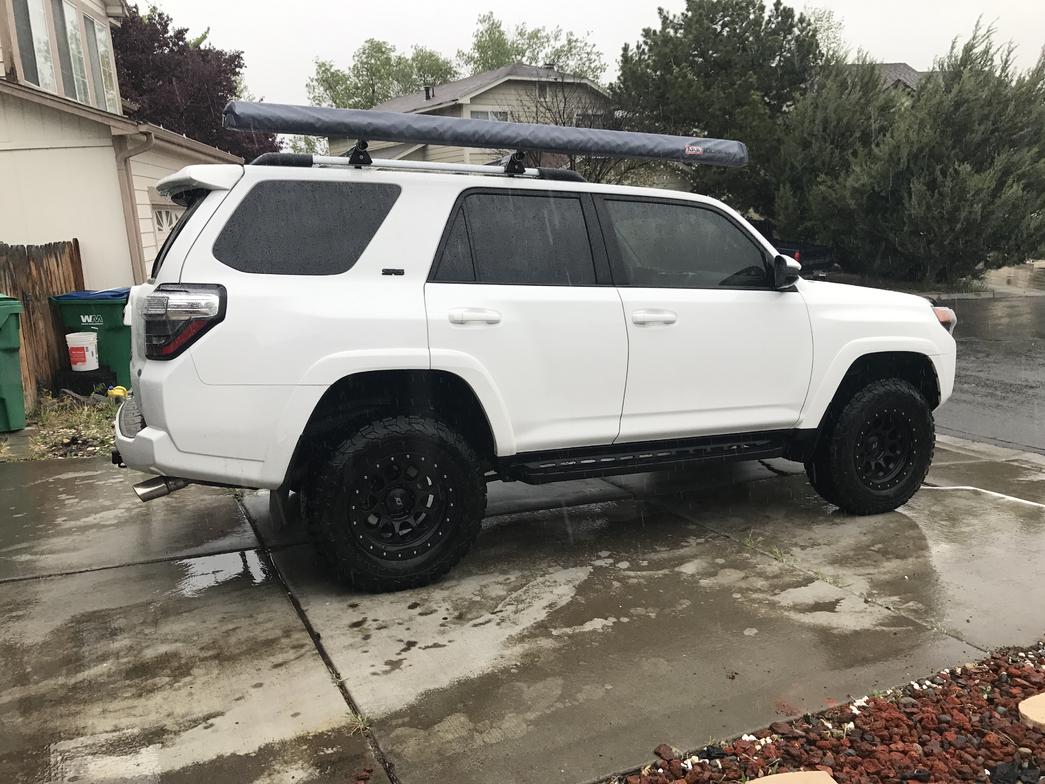

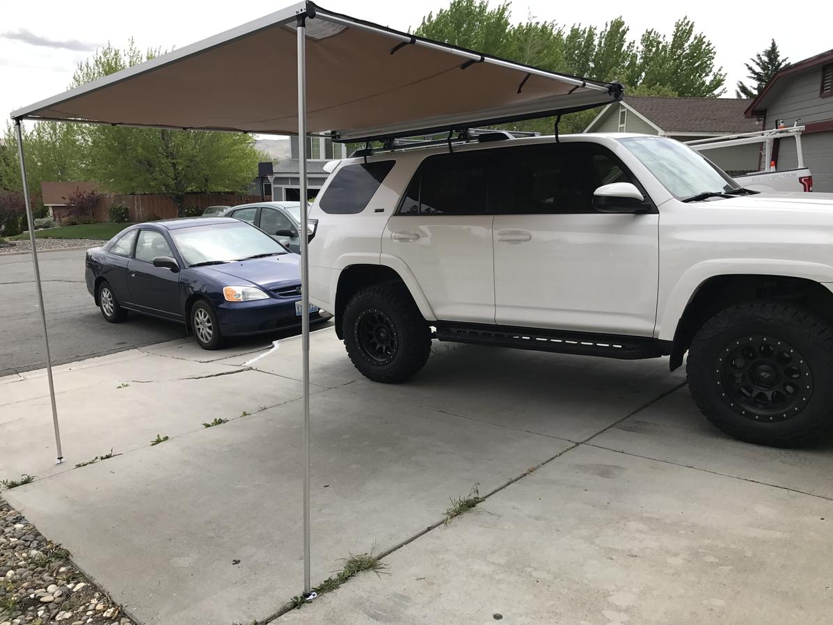

I installed the ARB awning. Pretty happy with it. I just feel like I installed it a bit too high.

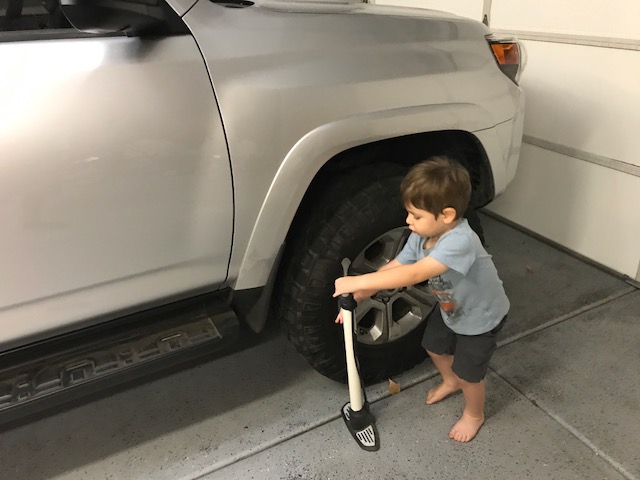

arb compressor vs air pump
For the folks with an onboard compressor, is it worth the money or just keep having my lil'helper do it manually?

Ya maybe a little high, especially if you're on tight trails but I wouldn't worry too much. Bigger thing would be if sunlight crept through between the roof and awning. I dig the full size awning, I've got the same one and love the coverage it affords.

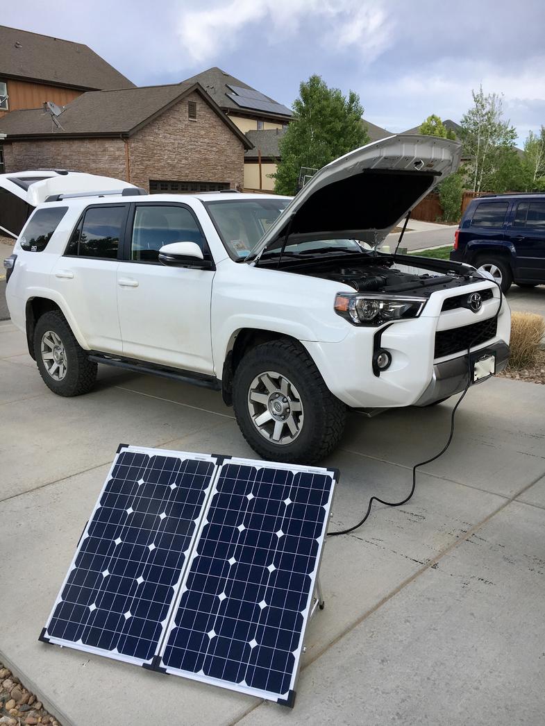

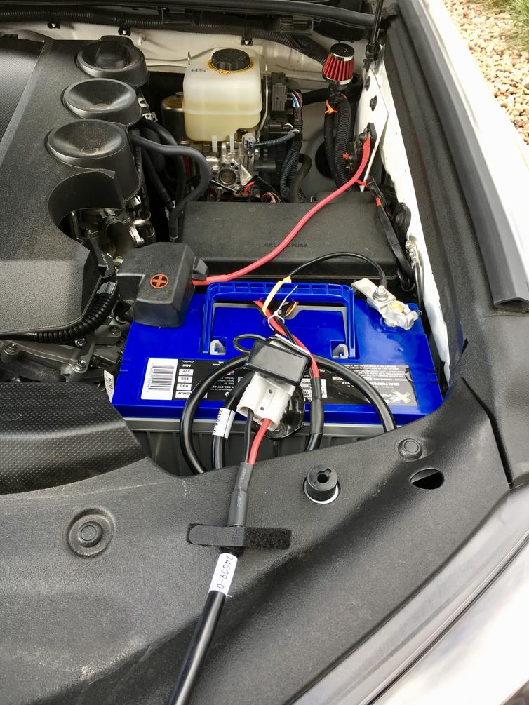

Upgraded my battery to a Group 27 X2 F (Northstar from Batteries +) and new battery tray from Bass Pro which all fit great with a little modification. Then I added solar (120W kit with solar controller adds 7.2A in full sun) to recharge it to keep my ARB Frig and the contents cool on days in camp. Getting ready to enjoy the summer in the mountains.

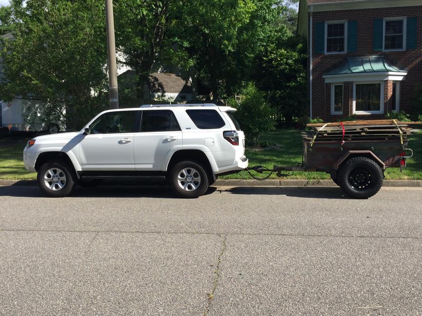

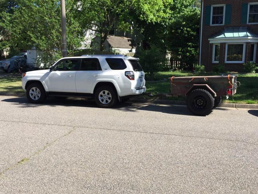

Before and after!
I installed a Toytec lift this weekend with JBA Upper control arms. 2.5sh in the front 2" in the rear. I might adjust the front a little after driving it around a for couple of days. Then get the alignment done. Next up TE wheeels with Ridge Grapplers. My trailers running FJ steelies with 255/75/17 BFG MTs.

Nah, not if your 6'9" :)
Seriously though, that would be about the perfect height for a foxwing with your gate open.
I think a cool mount design would let you lay it back flat against the rack and roll the assembly forward and upright when in use. So when it is in stow position it is lower, resting flat on the rack, inset more, and further from the edge of the truck, making it less likely to get caught only branches or other near high obstacles.

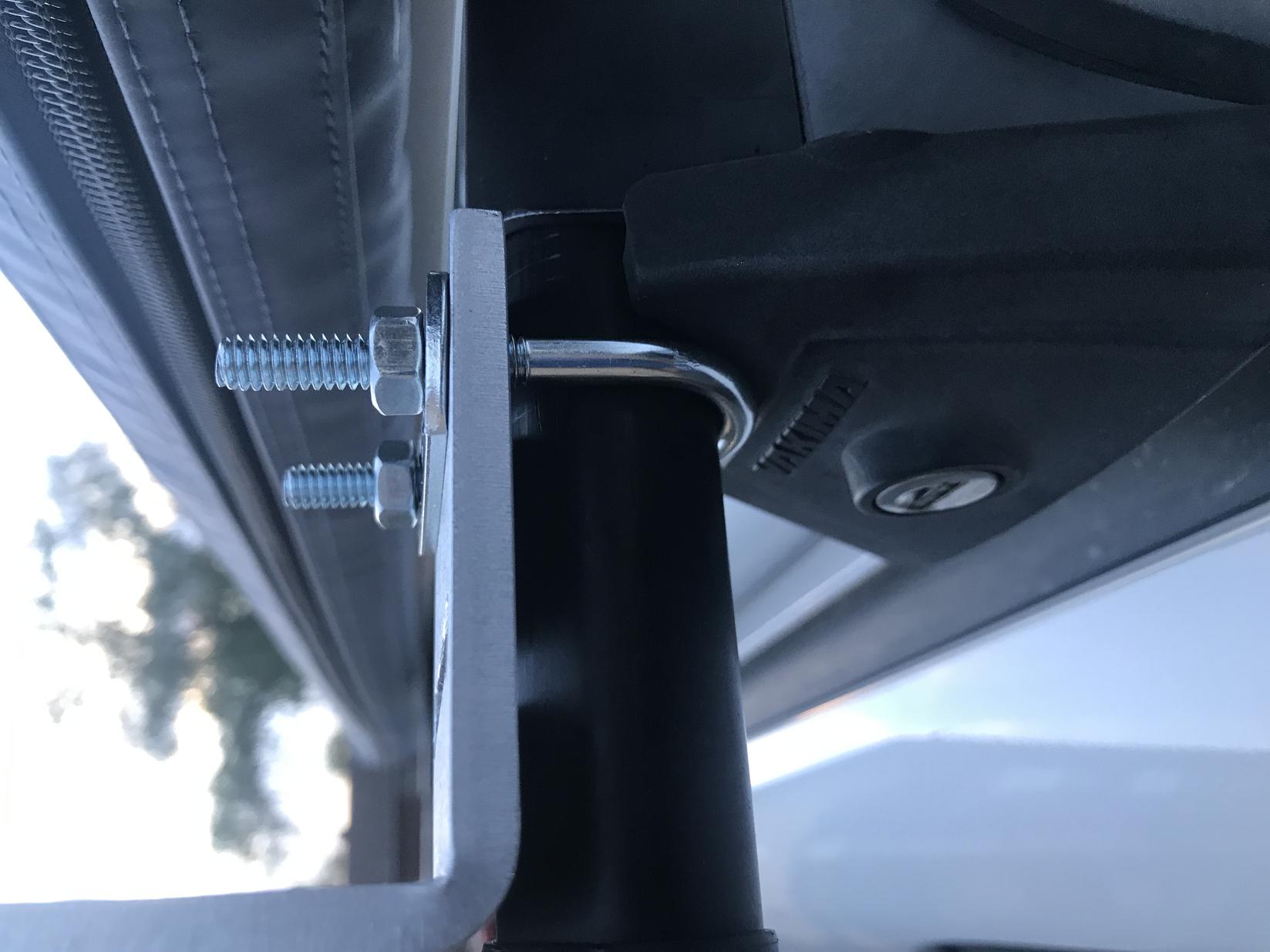

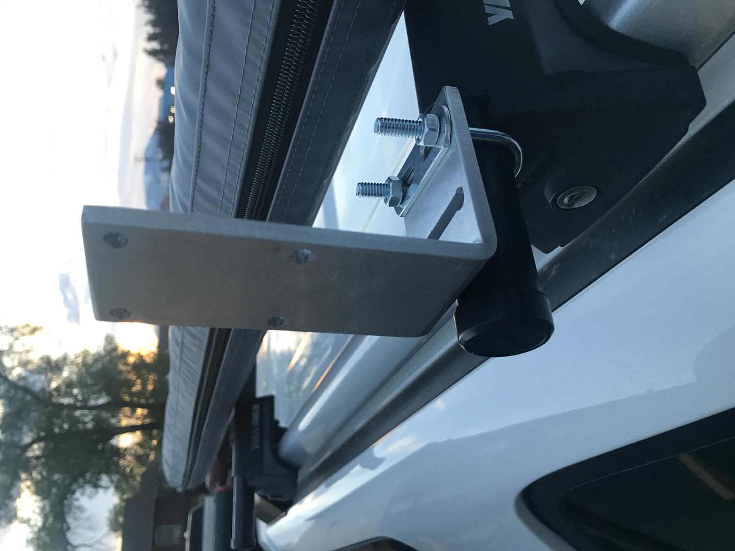

Well I'm only 5'6" haha and I can take out. I'm thinking of flipping the L brackets upside down maybe that would keep it lower to the vehicle.

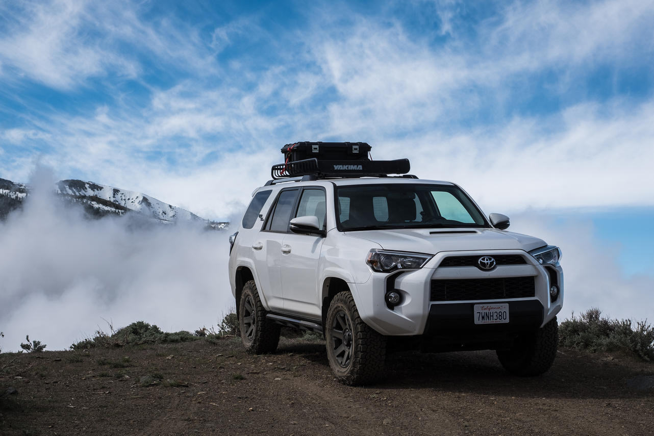

My front bumper had the license plate holes. I filled them up with some body filler, sanded, primed and flat black-ed that silver piece. Gained at least 5 HP from this mod alone.
That is a beautiful setup!
I recently bought a 17 TRD Off-Road Premium Superwhite 4Runner and I would like to make the front of mine like exactly like yours with the black front bumper and upper valence.
I see that you're located really close to me, I'm in Huntington Beach, Ca. I have no experience with automotive work so can you recommend a shop that could blacken the front of my 4runner to look like yours. I am planning to make my 4runner look exactly like a TRD Pro; I wanted a moonroof so the Pro was not an option.
How long did it take you to blacken out the front of your car? If I were to provide you with some cases of your favorite beer, could I tempt you to do the same to my 4Runner?
