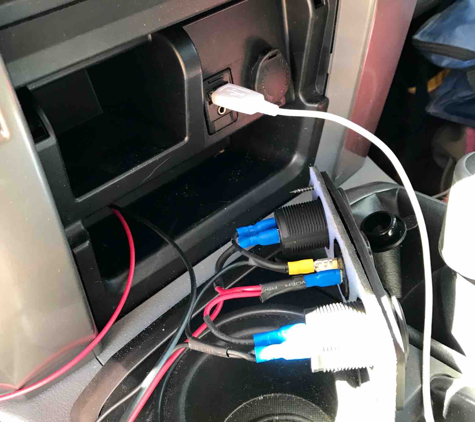

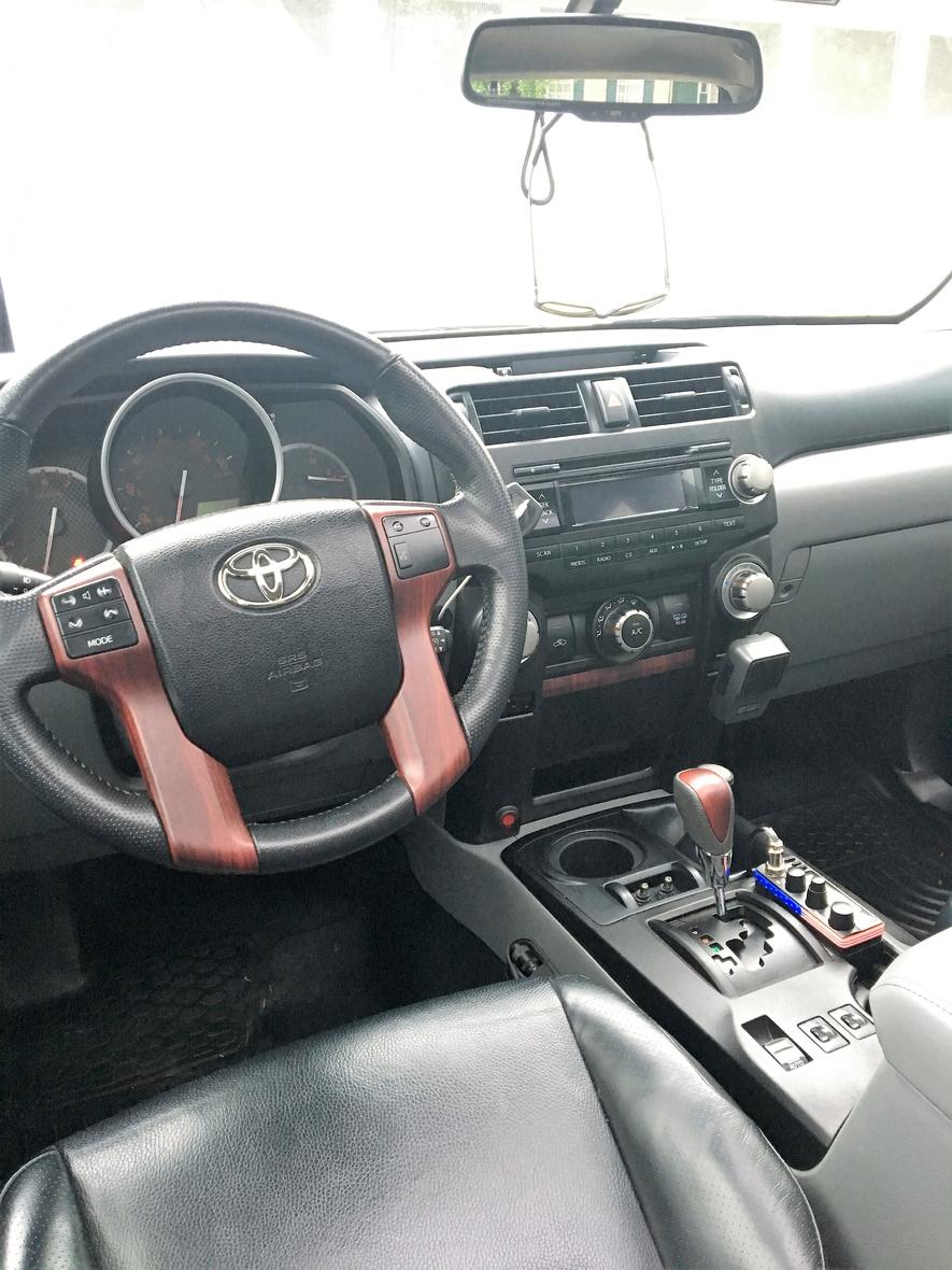

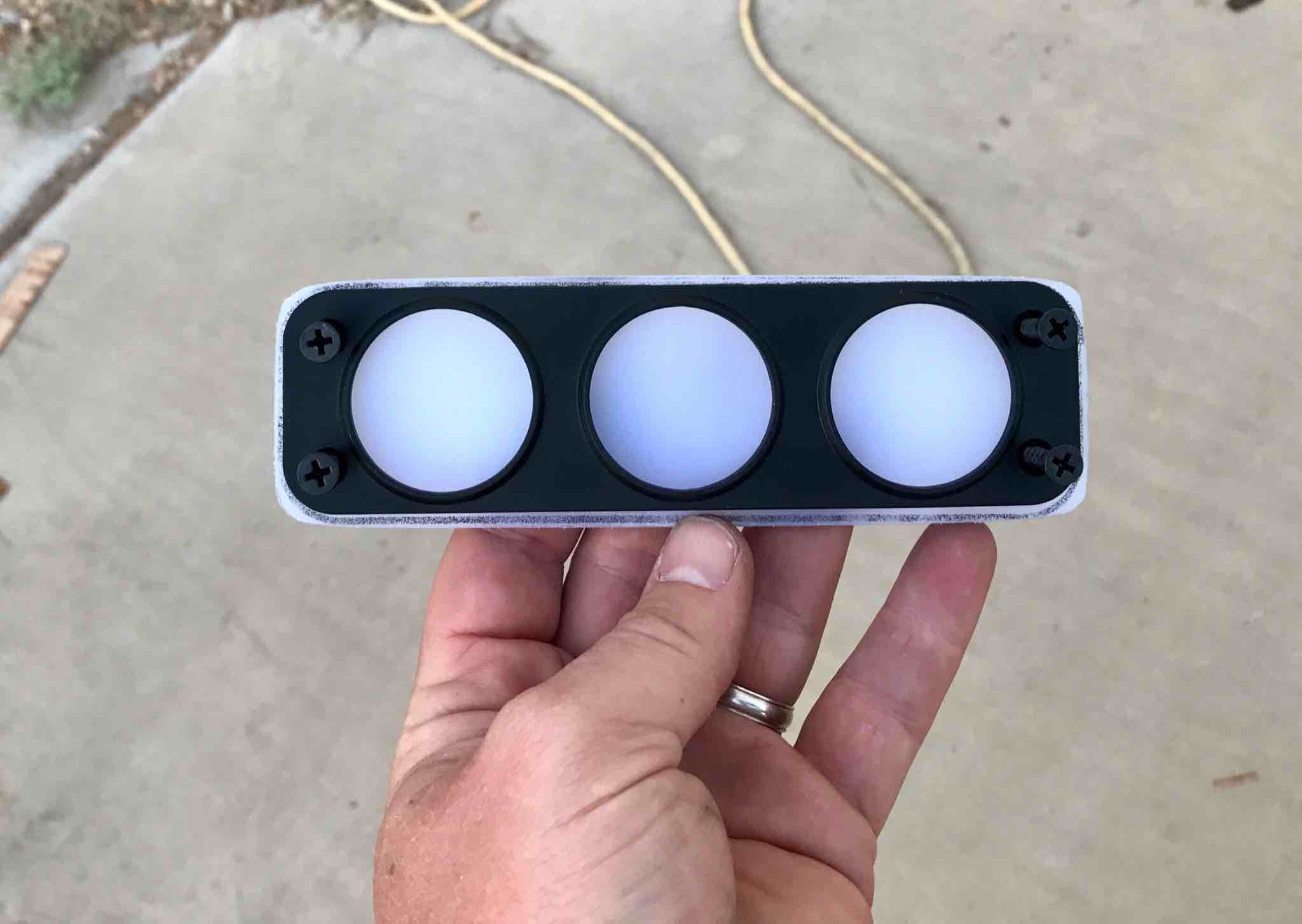

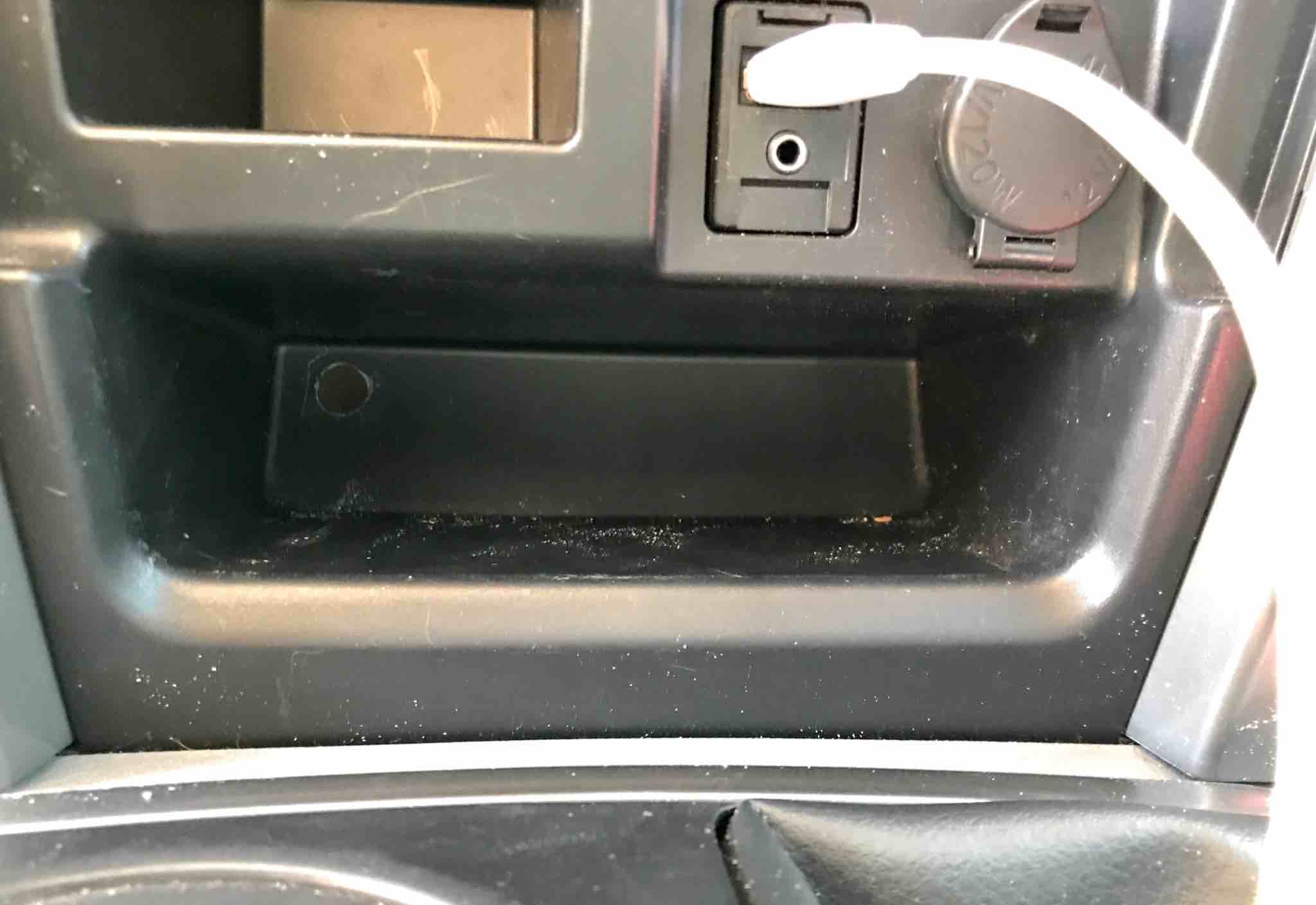

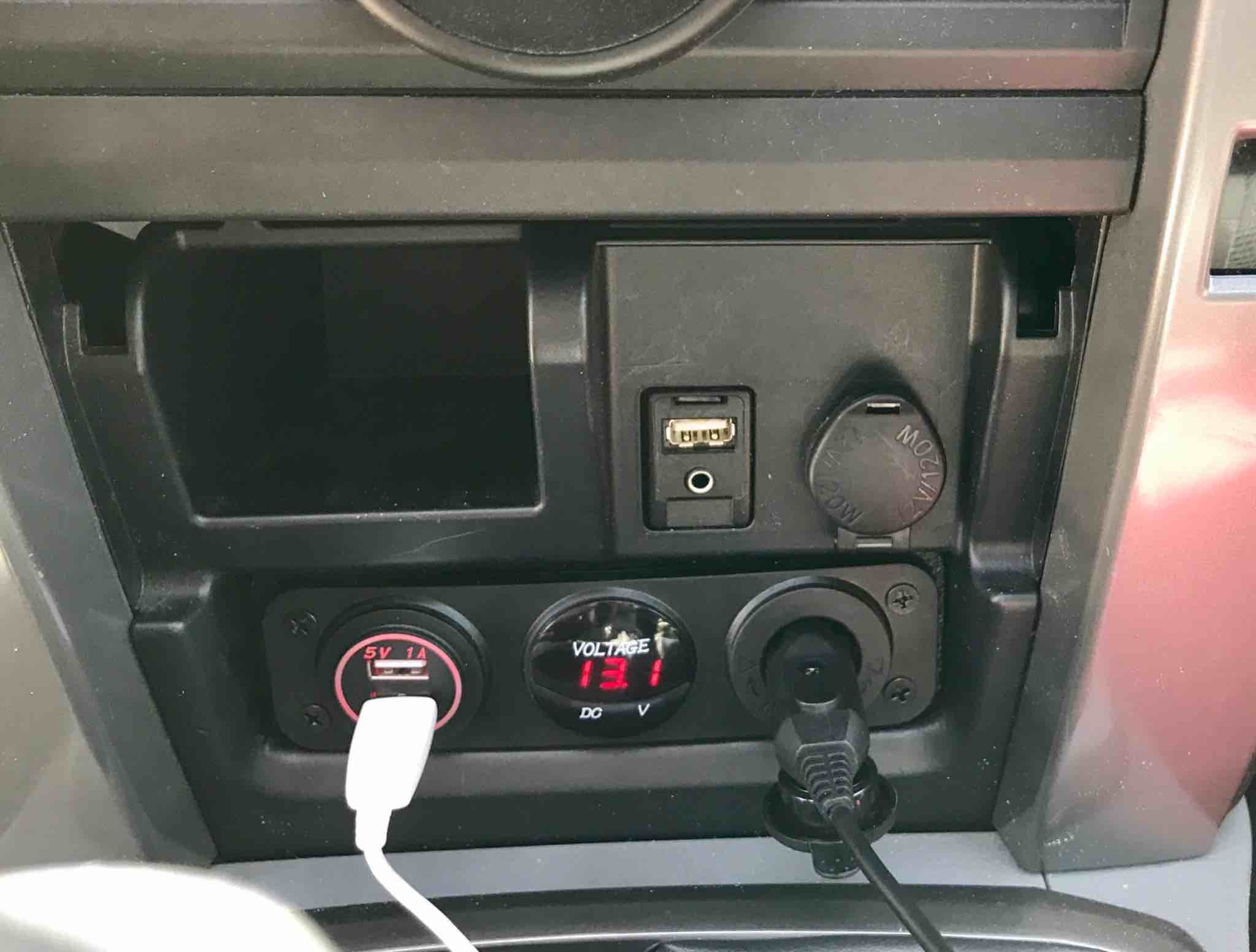

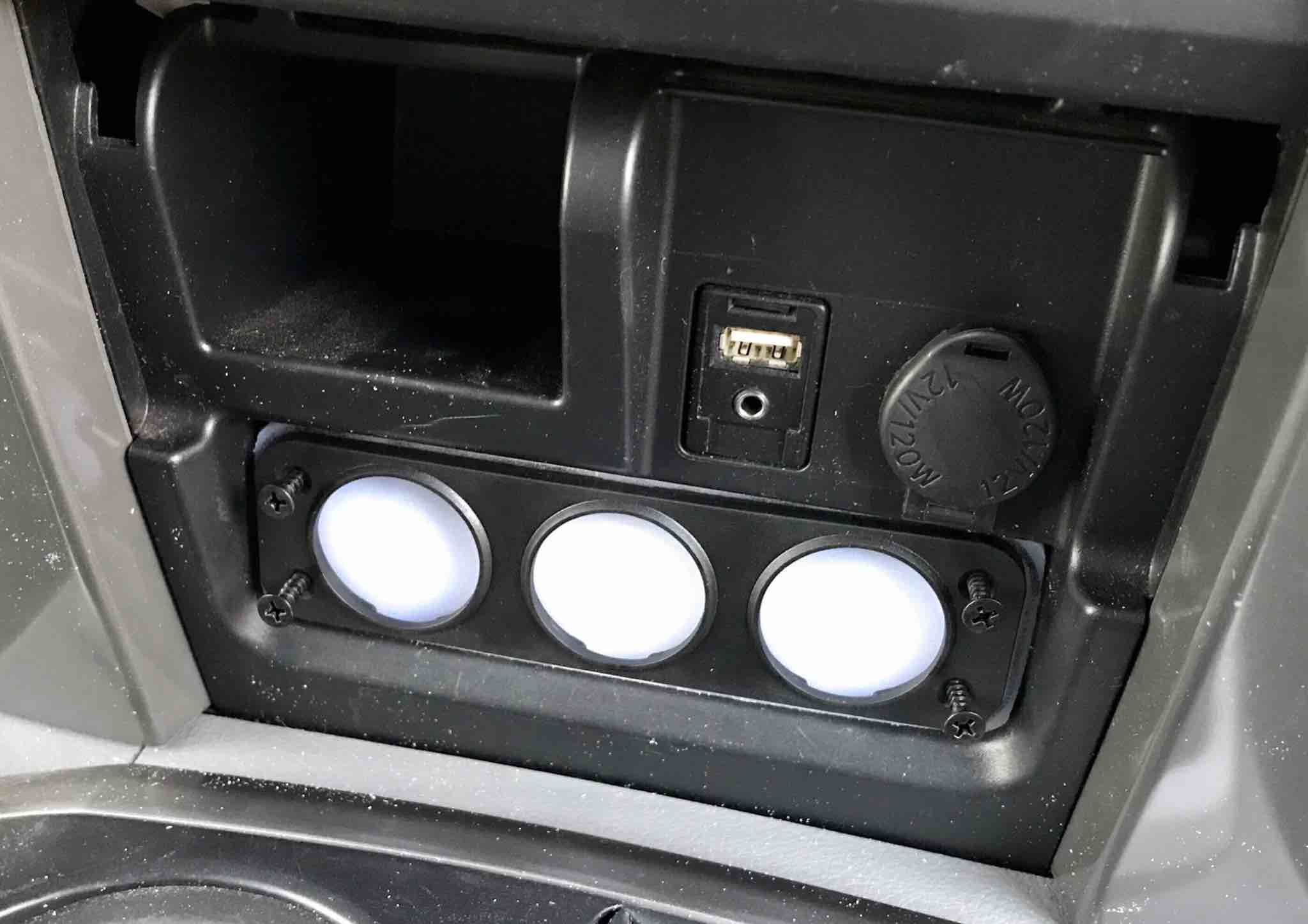

So I got rid of the flip top cover over the power plugs, never used it and it was always in the way anyhow and then I built a cover for the storage space and added a bunch of extra power outlet and battery monitor, the console fits almost perfect in the front of the storage shelfIMG_8510.JPGIMG_8511.JPGIMG_8533.JPGIMG_8534.JPGIMG_8535.JPG

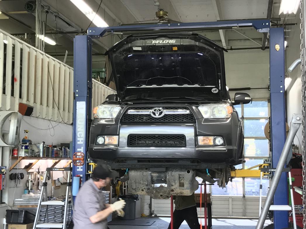

Shout out to [MENTION=138584]Fjtoyman[/MENTION] with the powder coat blue shock skids. Strongest shock protection on the market for your 4Runner!

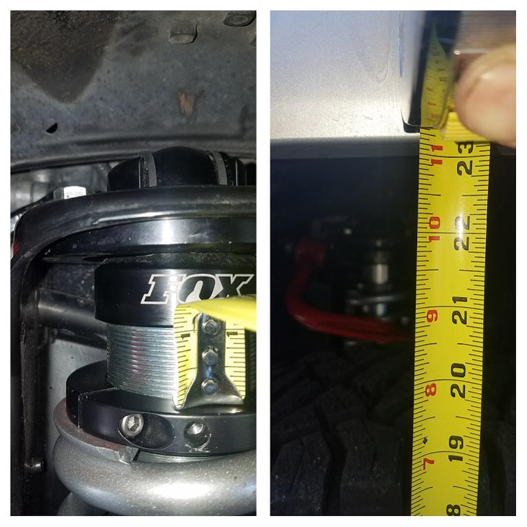

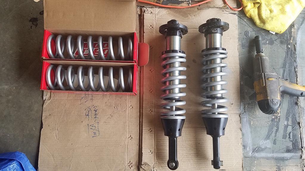

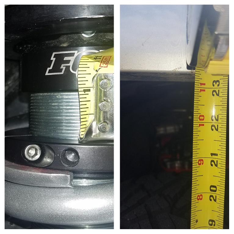

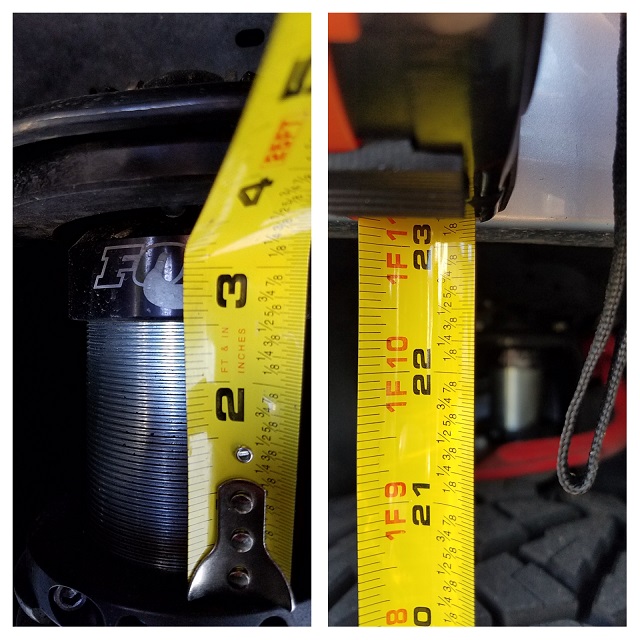

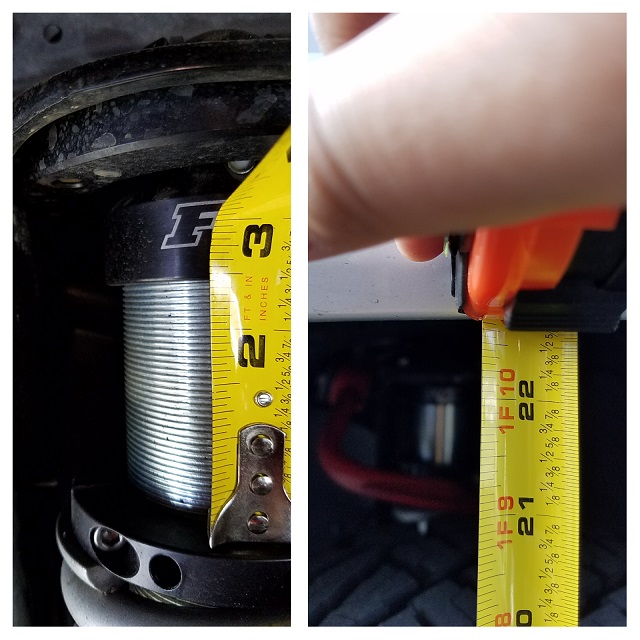

Swapped out the factory 13" 600# off my Fox's and swapped in 14" 700# Eibach coils. Running an additional 350lbs of armor toward the front which the factory coils could not handle. Also took a crap load of preload just to get some decent height.
Comparison pics show the 13" 600# Fox/Eibach coils with about 2.5" of preload compared to current setup with 14" 700# Eibach coils1" preload driver/passenger. Also measurements from center hub to fender.
