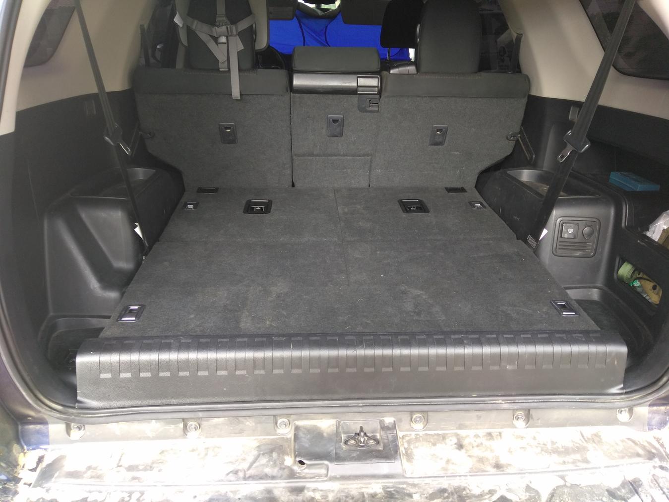

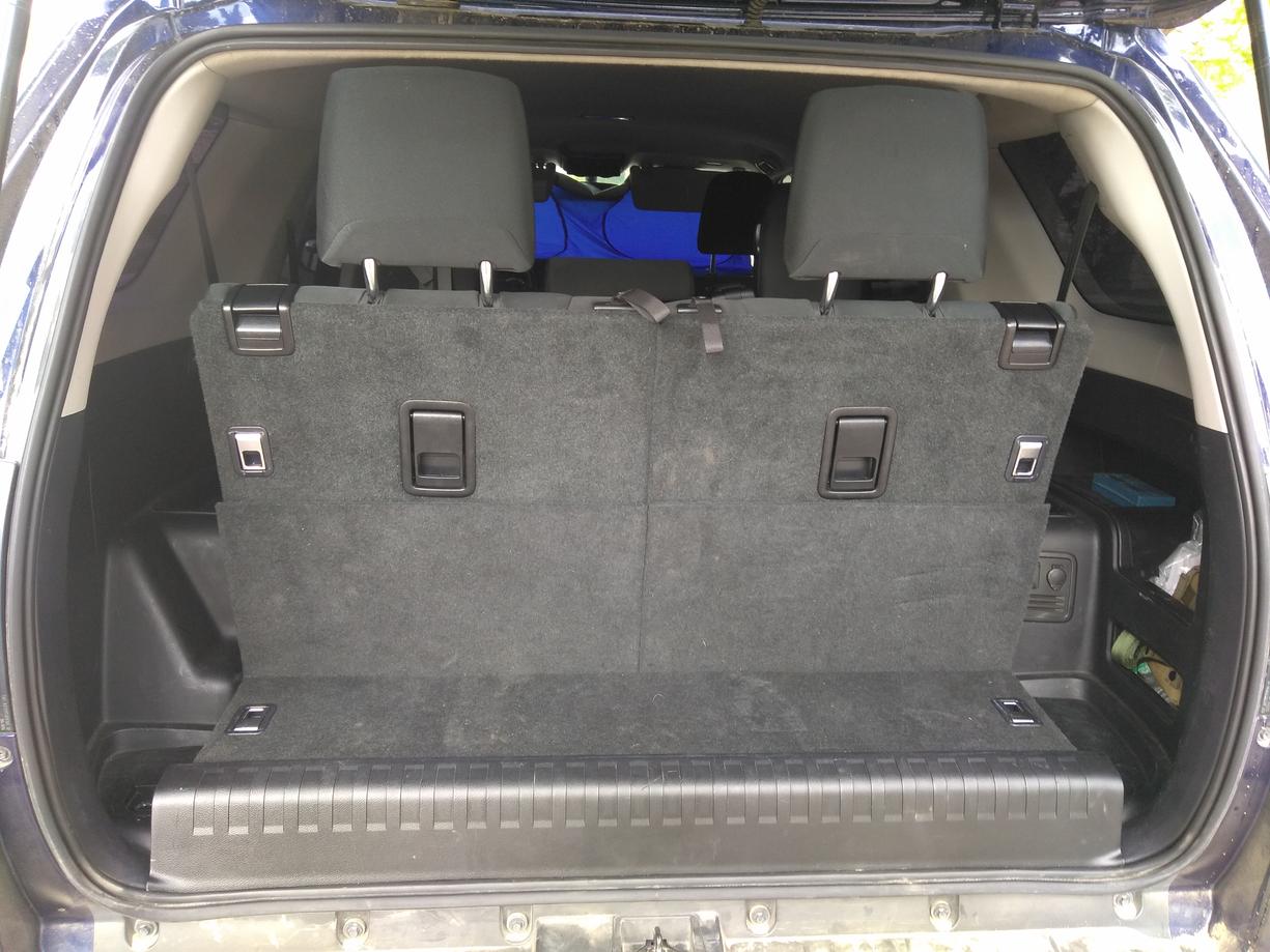

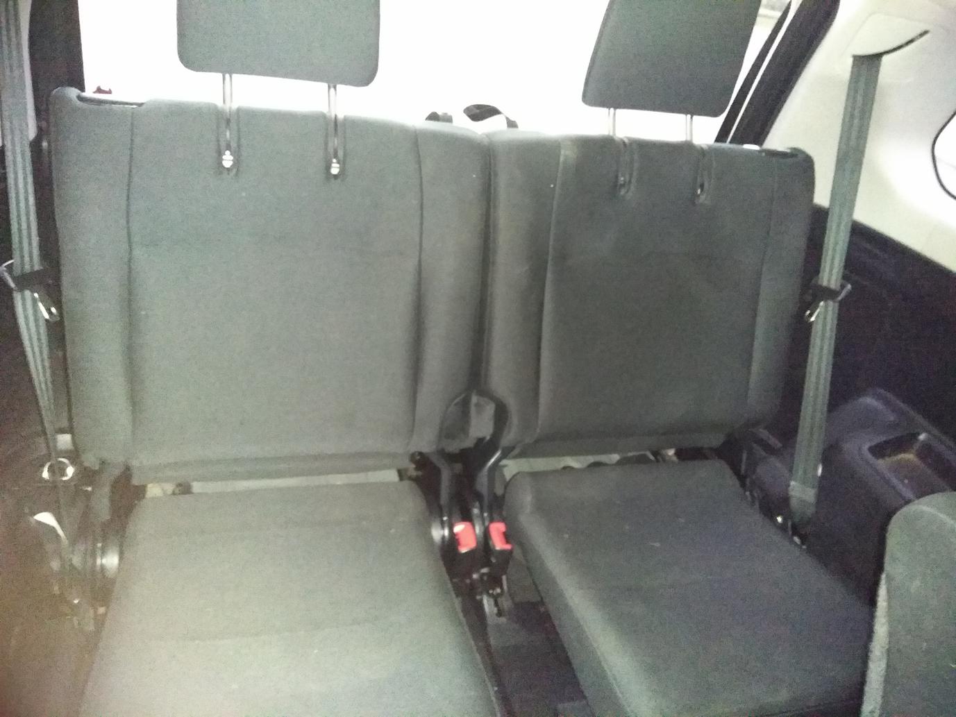

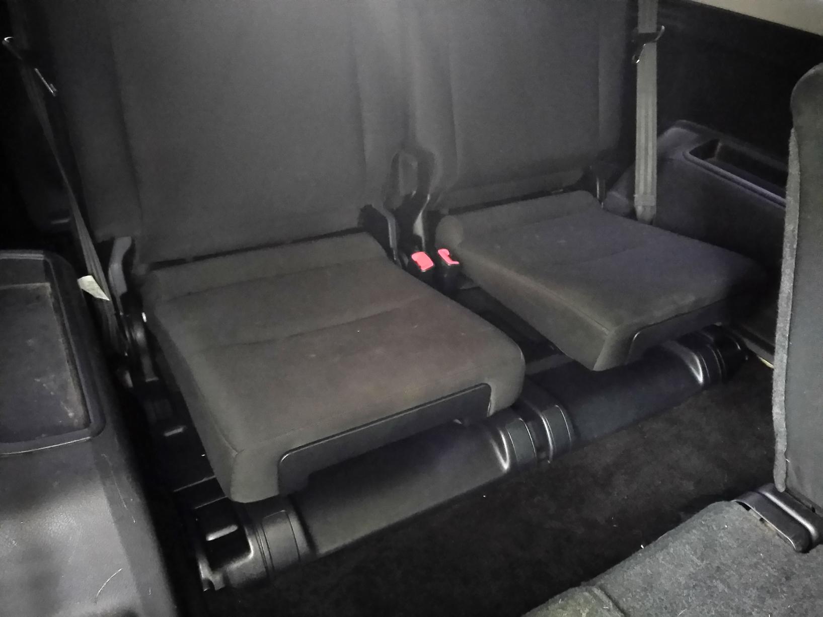

3rd row
Installed a 3rd row in my trail edition. Turned out awesome and the wife is happy! Couple things took some work but it works!

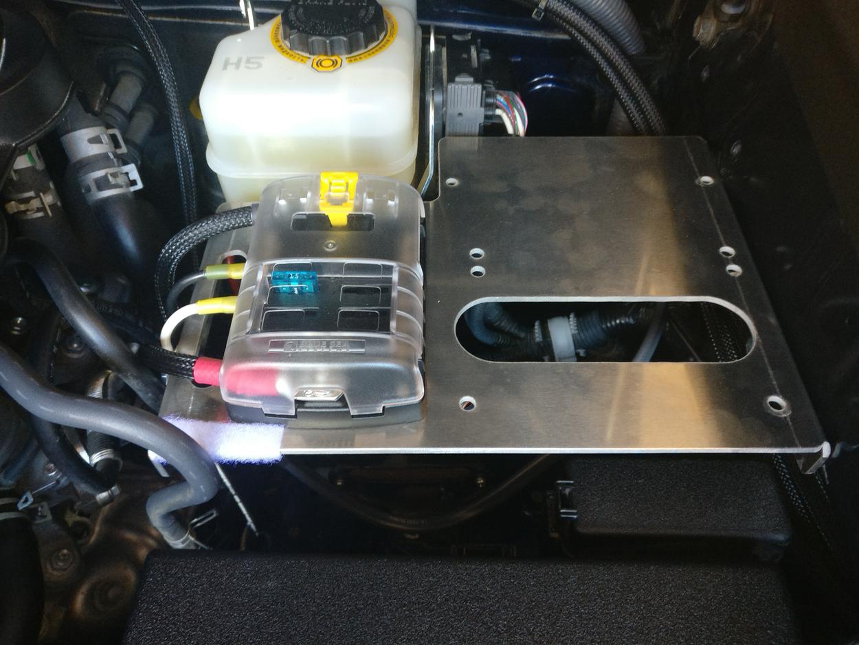

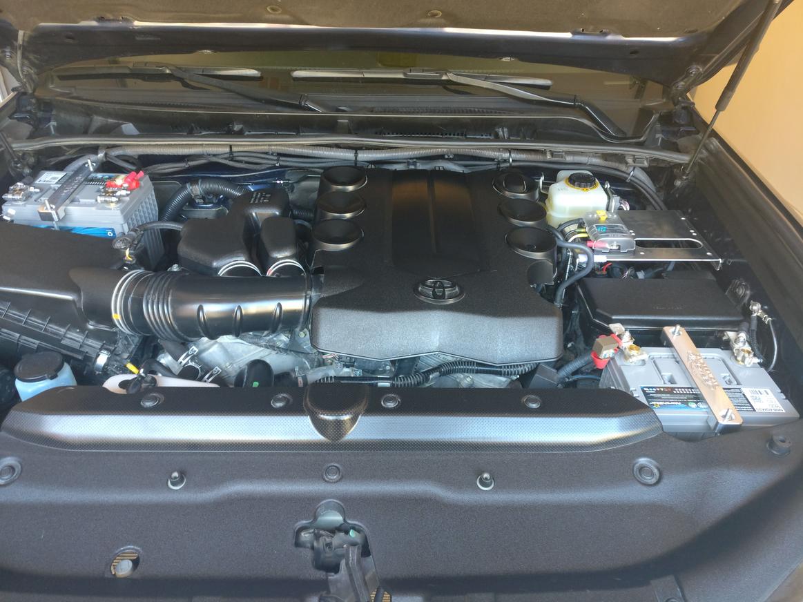

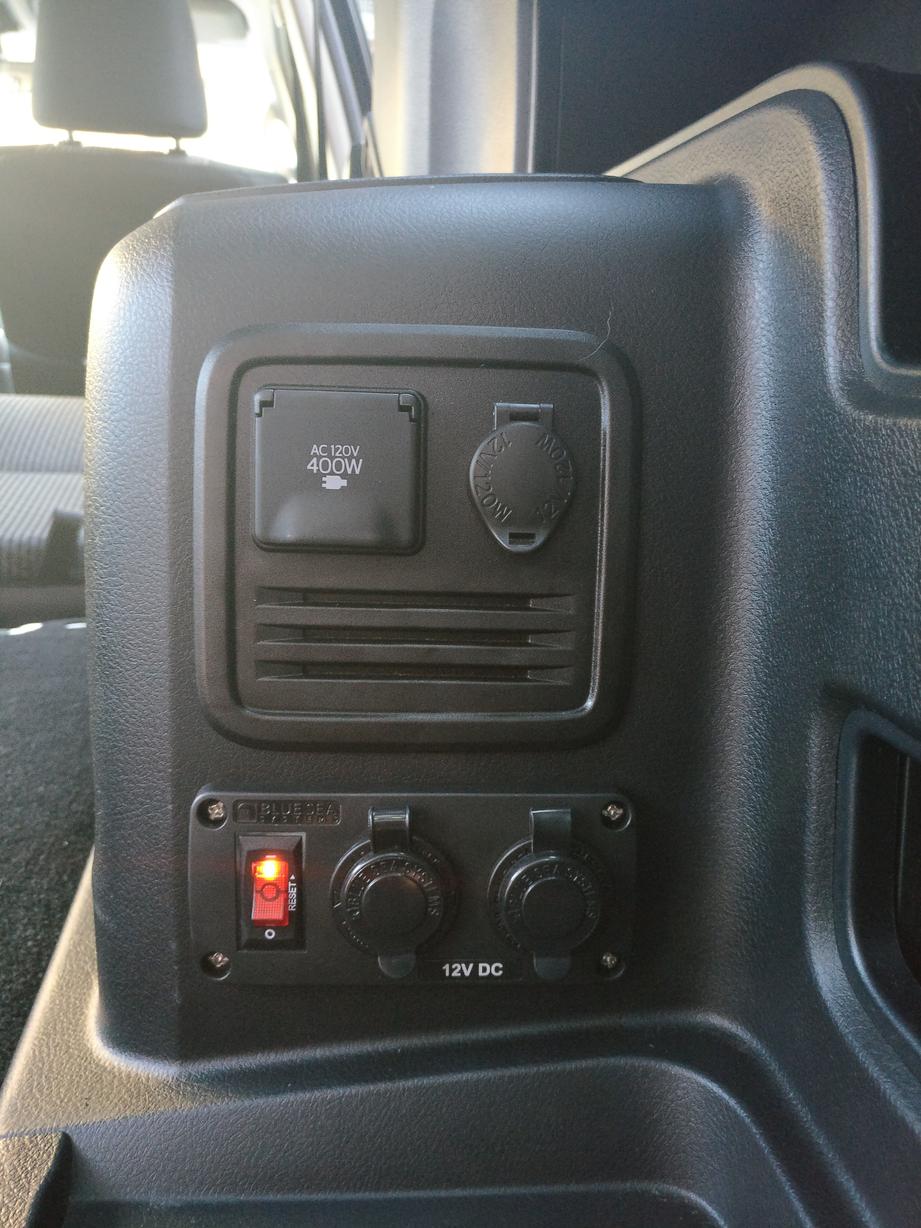

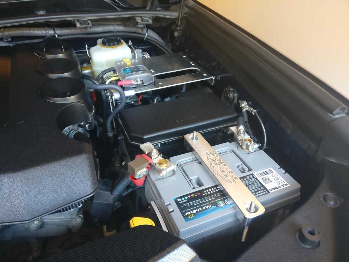

Off-Grid Engineering Dual Battery System
Finished installing and wiring my Off-Grid Engineering dual battery system. Went with 2x Northstar Group 35 AGM. It uses a Blue Sea ML-ACR to control the two batteries. Then bought a Powertrays bracket to mount a Blue Sea ST Blade fuse block. Ran 10ga wire to the back to a Blue Sea Below Deck panel which has a 12v cigarette port and 2 usb ports. I ran the wire through the driver side fire wall then under the kick panel trim to the rear where I then ran it across the carpet area behind rear seats. Then snuck it underneath the passenger rear wheel well area to the Below Deck panel. Cut out a template for the Below Deck panel and mounted it right underneath the factory outlets. Powers up the Indel B 41L fridge perfectly :rockon:
