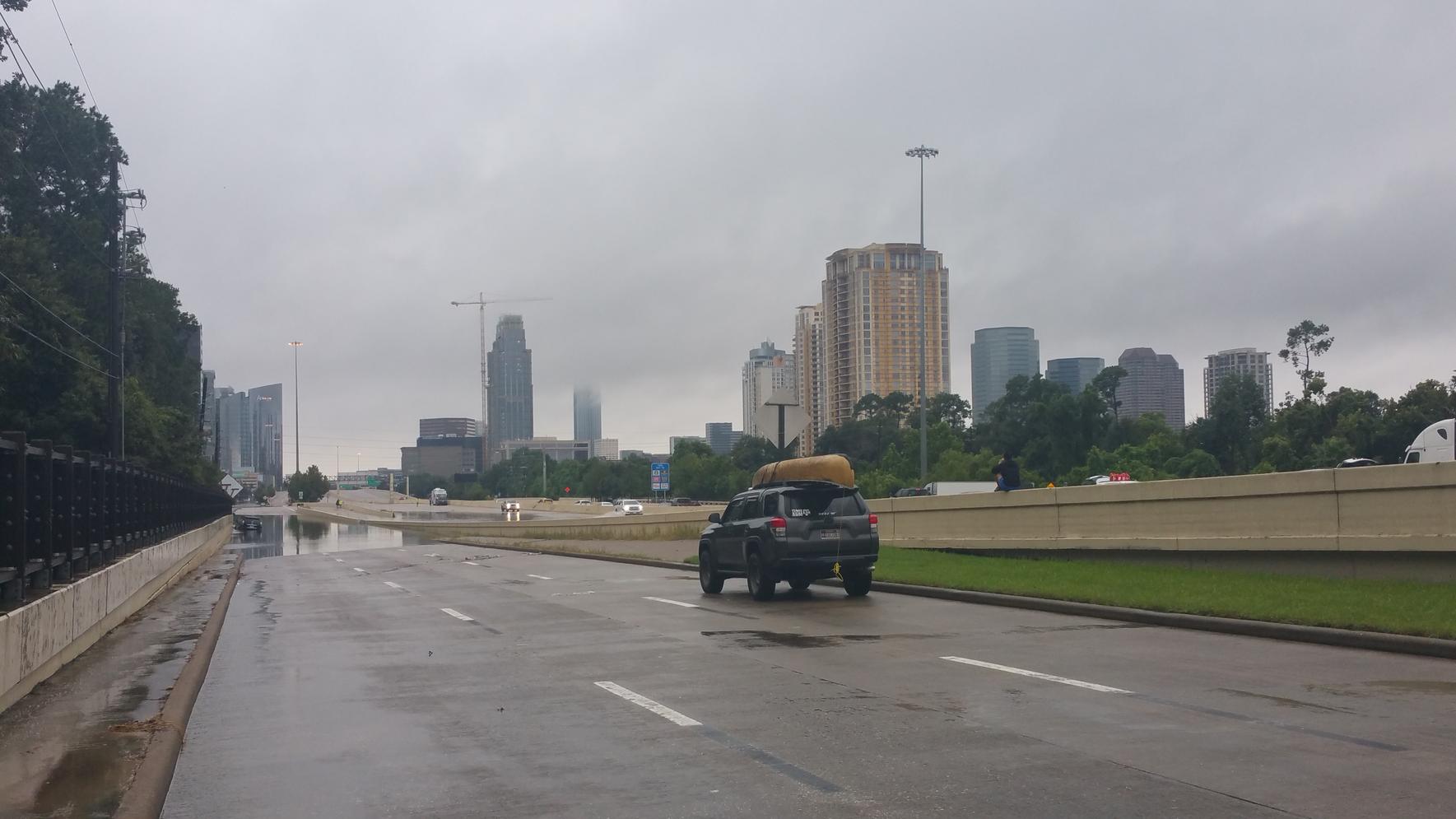

Oh no... that poor GX...
i watched him drive into the water... it was the craziest thing. There was a woman in the passenger seat. We saw it start floating and then the tailights turned off. Then they had to open the sunroof to escape and climb up the fencing to the left of the GX. it was insane.
Harvey showed me a lot of things, one of those things being a stock GX cannot handle 4ft of water without a snorkel. :bathbaby:

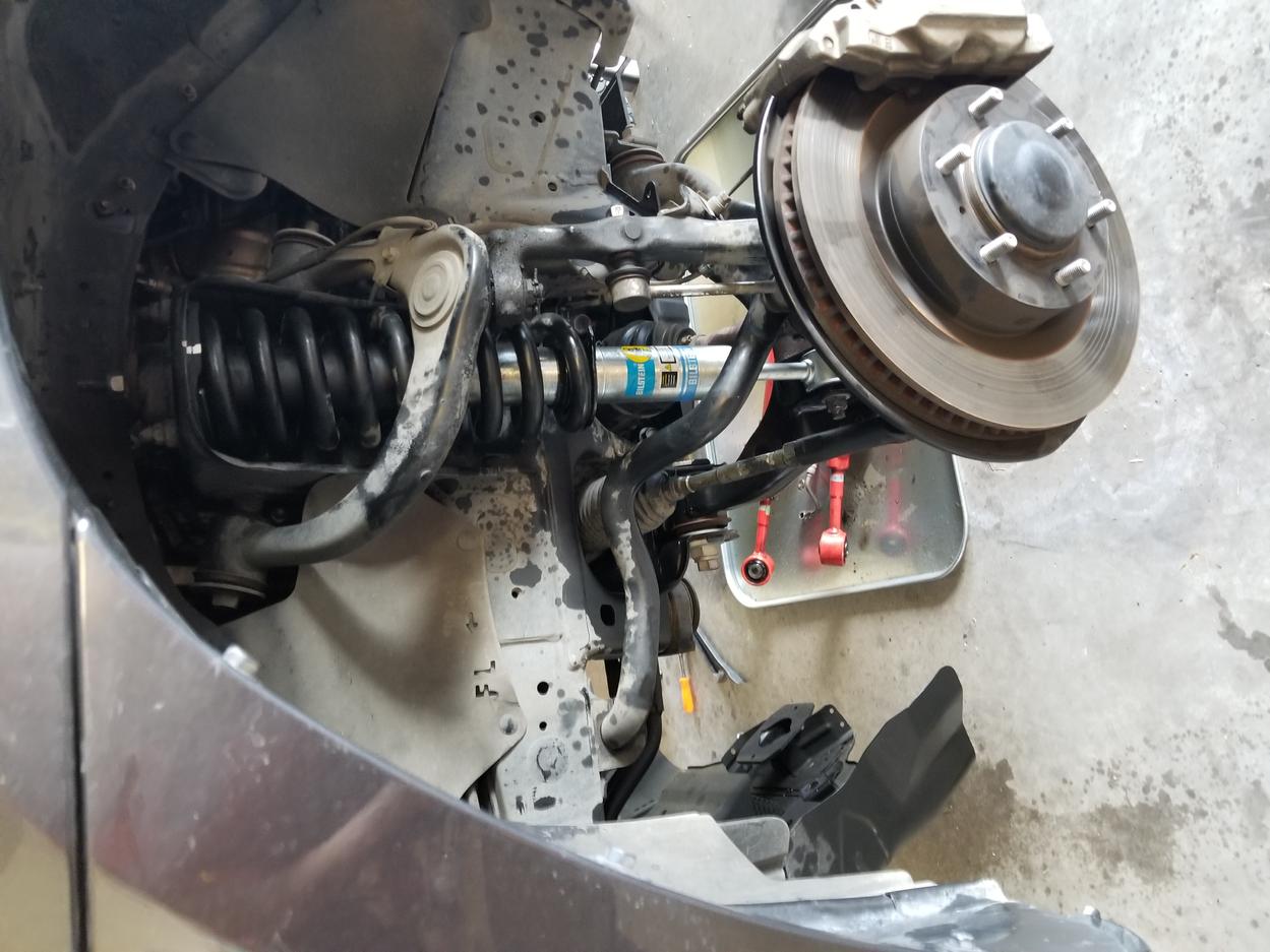

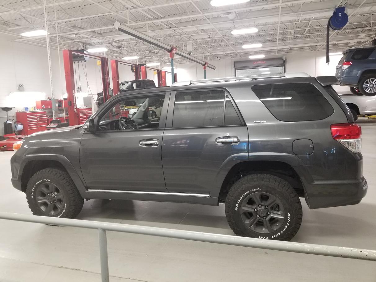

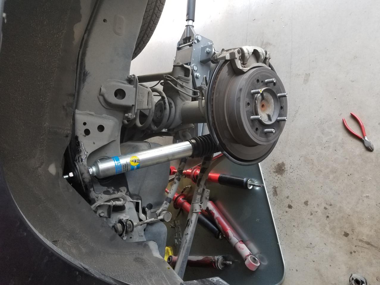

Installed front Bilsteins at 2.5", rear Daystar 1.5" spacers, and rear Bilsteins. At the stealership now getting an alignment!
Strangely enough, the amount of steering wobble I've been having between 50-60 wasn't noticeable at all on the drive over... But there's no way I can leave it unaligned, the toe is majorly off! Haha
Took about 4 hours with a buddy. Biggest problem I had was getting sprayed in the face with hydraulic fluid taking off the XREAS connectors.... Lol
