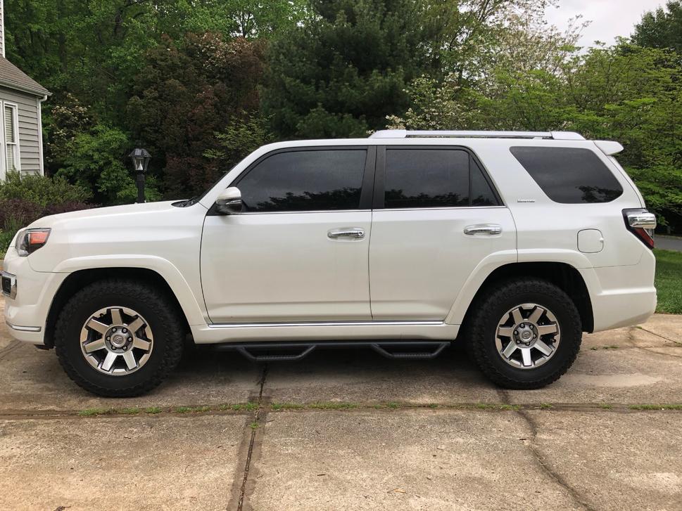

Not today, but finished up my initial mod list to personalize my Limited;
MODS COMPLETED
- Replaced wheels & tires
- FN wheels, 17” Type X Light Gun Metallic $899
- Tires... 265.70.17 Mich Defender
- did the necessary fender mod to eliminate rubbing at lock
- LED Lighting upgrades
- Interior, license, puddle lamps
- LED Turn as tail mod (Diode Dynamics)
- LED Xtreme Pro low beams (XenonDepot)
- LED switchback running/signal lights (Diode Dynamics)
- LED fogs (Alla bright yellow)
- Horns - FIAMM El Grande
- Proclip phone mount
- Toyota all weather floor liners, cargo net
- Bug deflector - AVS
- Bully hitch step
- Blendmount (V1 w/mirror tap)
- Mud flaps (Roadsport B series)
Taking a break before I tackle the next few, which will include a 1" front end lift and a 2-ch 4K dashcam...

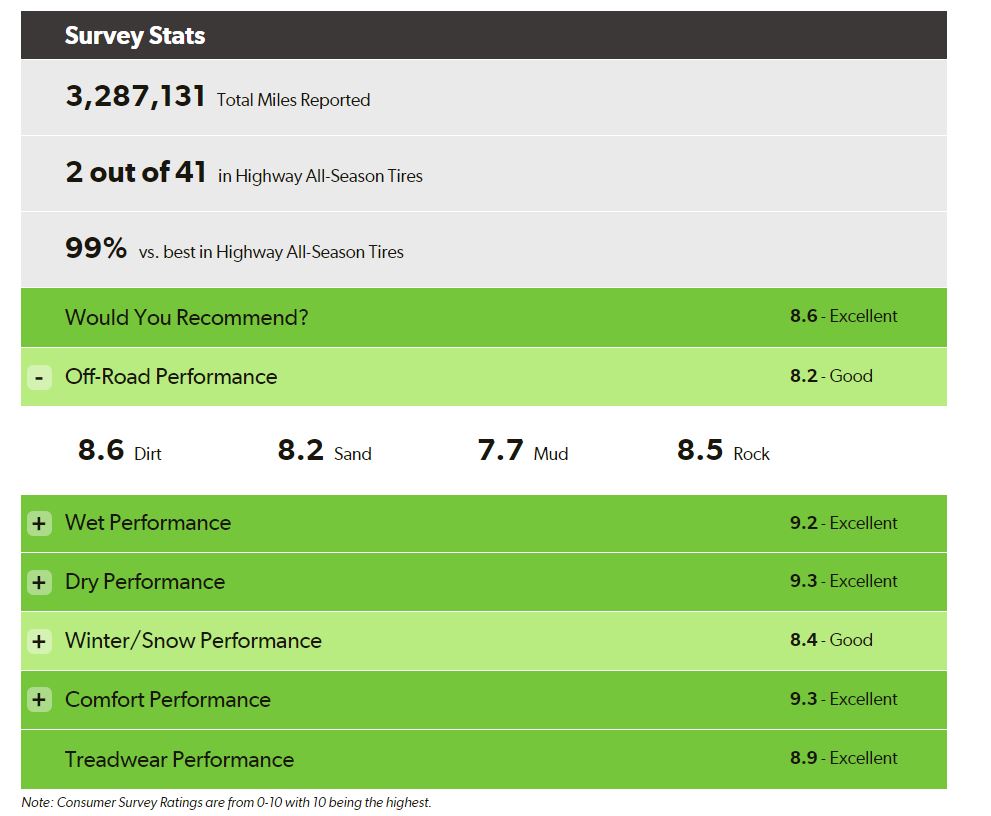

how do u like them michelin defenders so far
great! Nice ride, quiet. Look good, too.

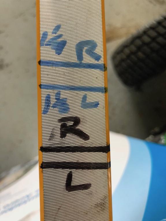

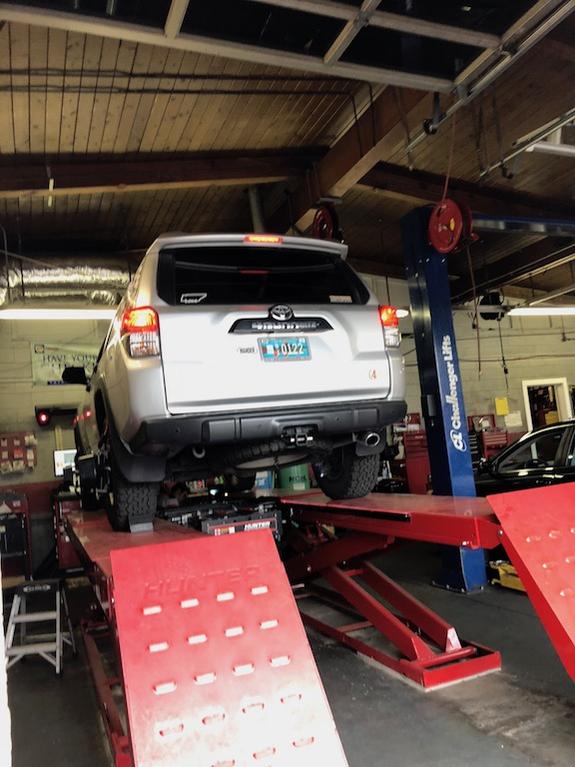

Got the 4R aligned since I installed the new Bilstein 5100 struts and shocks yesterday. I set the front on the +0.8" setting to level it up. As you can see from the before and after marks I gained about 1.125" on driver side and 1.25" on the passenger side. The ride is so much better. The original shocks/struts had 130k miles on them. One of the rear shocks was leaking and one of the front struts had the metal dust cover rubbing the cylinder housing.
