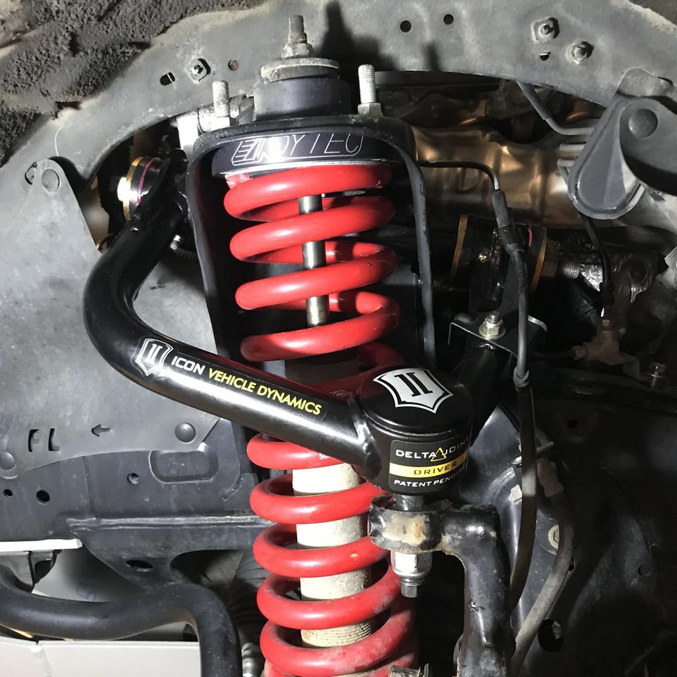

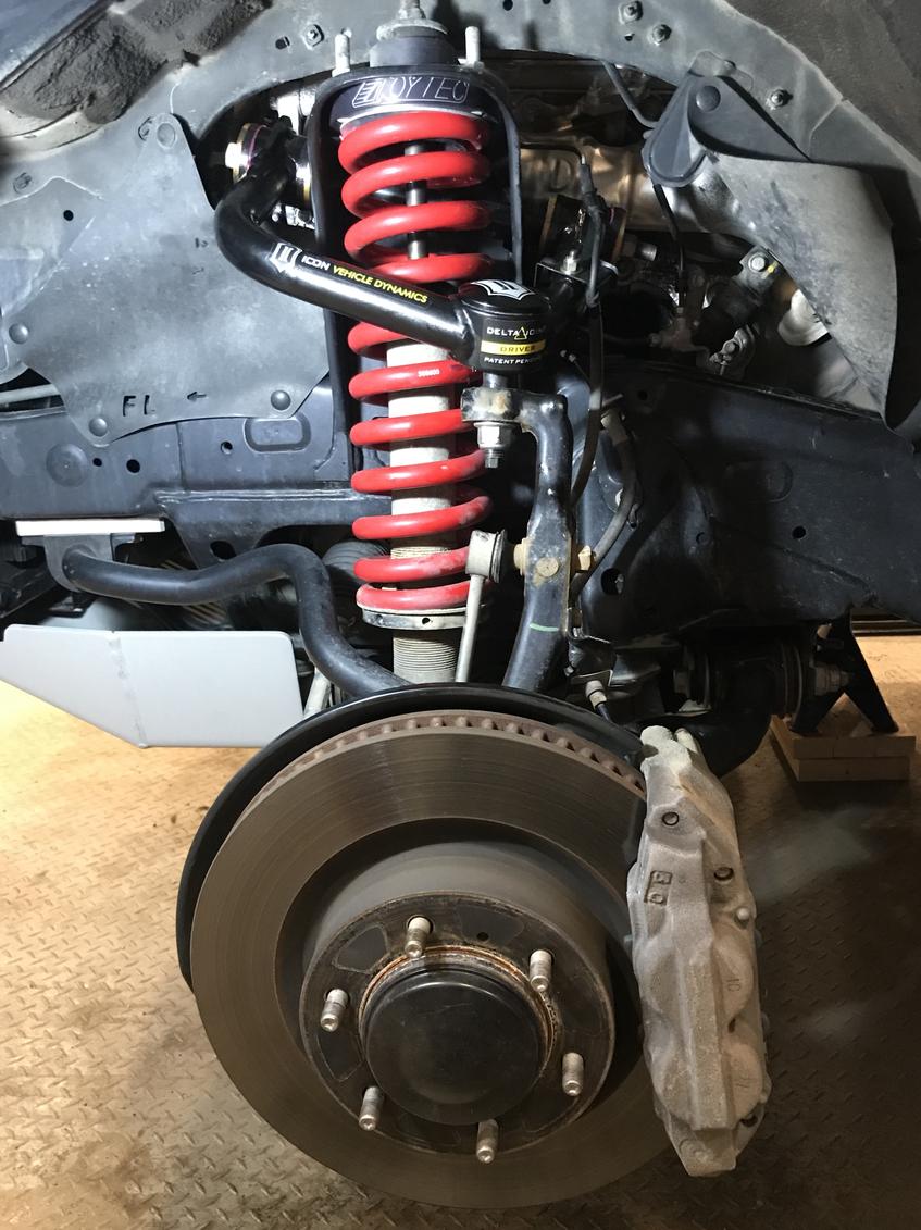

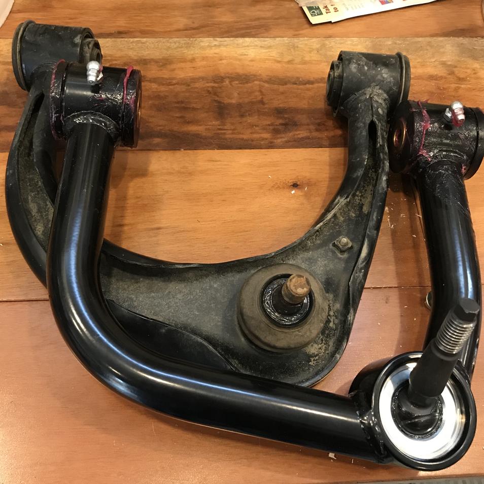

Installed the Icon tubular UCAs with Delta Joint!
Hardest part was getting the 3rd washer in as it was a very snug fit. Ended up using a large flat screwdriver to pry the rubber bushing away from the bolt tube then sliding in the washer. Then used a mallet to pound in the washer the rest of the way.
Be carful not to over torque the brake line mount nut.
