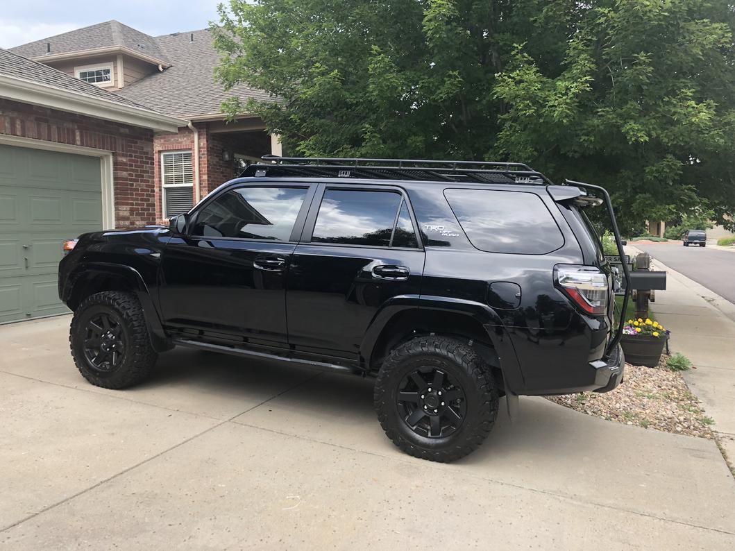

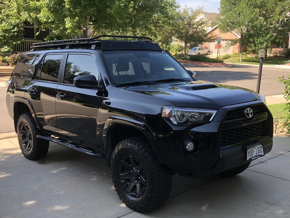

FJ Summit and Gobi Install
First time visiting Ouray/Telluride during FJ Summit was a blast. And say what you will about Gobi as a company...they make an incredible rack. Scoured classifieds for four months and finally found a like-new 5 month old rack for $700 less than new on ebay of all places.

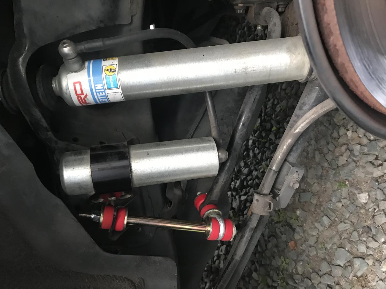

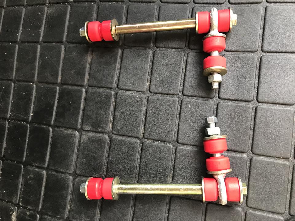

Took this rear endlink idea from the 4th gen forum, it so far seems as it would fit fine. The overall cost was great, I went to Ace Hardware and Autozone for parts, here after dinner I’ll get to trying out one side for install, particularly the driver side since the gas tank is there. One thing I am noticing is the length of the endlinks might be a problem so they might need to be shortened a little which is a easy fix. Ghetto, yes but it fits and I’ll report soon with any change of feel since it will preload the sway bar more as the links are about 1” longer but would allow a little more flex over stock.
Here is the link for reference
http://www.toyota-4runner.org/4th-g...sh-extended-rear-sway-bar-links-write-up.html

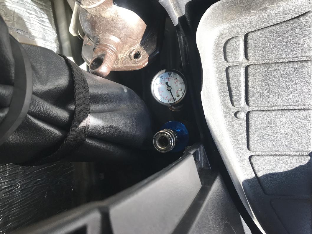

I also got the remaining fititings for my rear mounted air manifold, the manifold will have 3/8” air brake line fed from a 1 gallon seamless air tank mounted under the 4x4labs arb compressor mount in the front.
