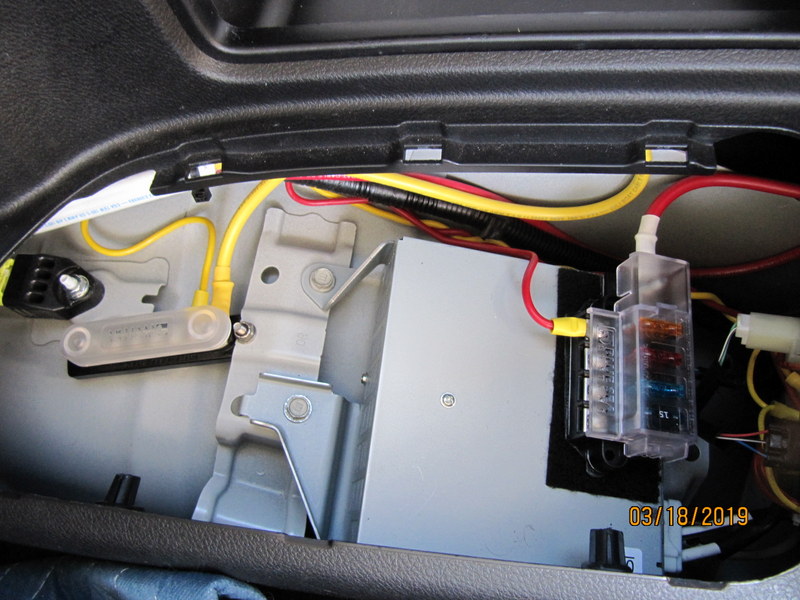

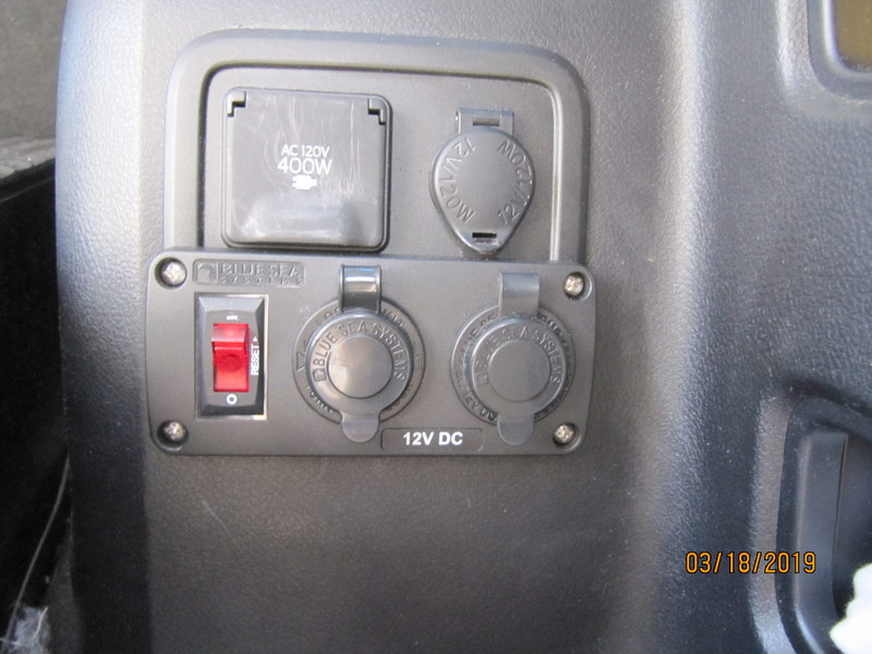

Finally Installed a Blue Sea 12 volt "Constant Hot" outlet in the Cargo area.
This is fed from My 2nd Battery Via a Bussman fused relay panel under the hood. I also installed a small fuse block in the fender well for future expansion of devices if needed later.
The hard part was getting the tray removed. Thanks to many on this forum who have posted this removal it didn't take long. The fit in this box is tight due to the power inverter. I ran a 2 conductor #8 marine cable from the engine compartment to the wheel well via the PS rocker panels. I cut the existing OEM outlet panel to fit the Blue sea because if I screwed this up I could always order another panel for the OEM outlets.. It just fits. Now My phone and pad can get charged when I'm out fishing. Some of the post for this mode date way back and I searched for a long time to find a recent one but could not.Throughout my search I picked up bits and pieces of other mods, mostly from the refrigerator mods threads ( thanks guys).
I have posted more photos and comments of this in my album pages.

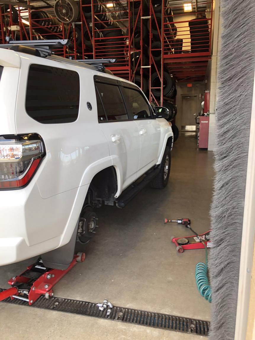

Got a few screws in her hoofs and had to take her to the tire barn.
