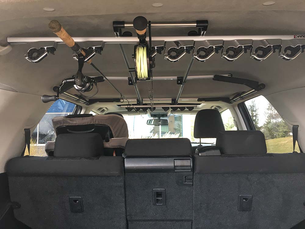

Inno Fishing Rod Holder
Haven't seen many posts on the Inno racks, especially if you don't have third-row handles. Used the second-row handles and it works great. A nine-foot fly rod hits the window and bends a little but not bad. You can also break them down, it holds several pieces, as seen in photo.
Here is a link to the company website. ROD HOLDER | FISHING | inno Roof carrier & Roof box

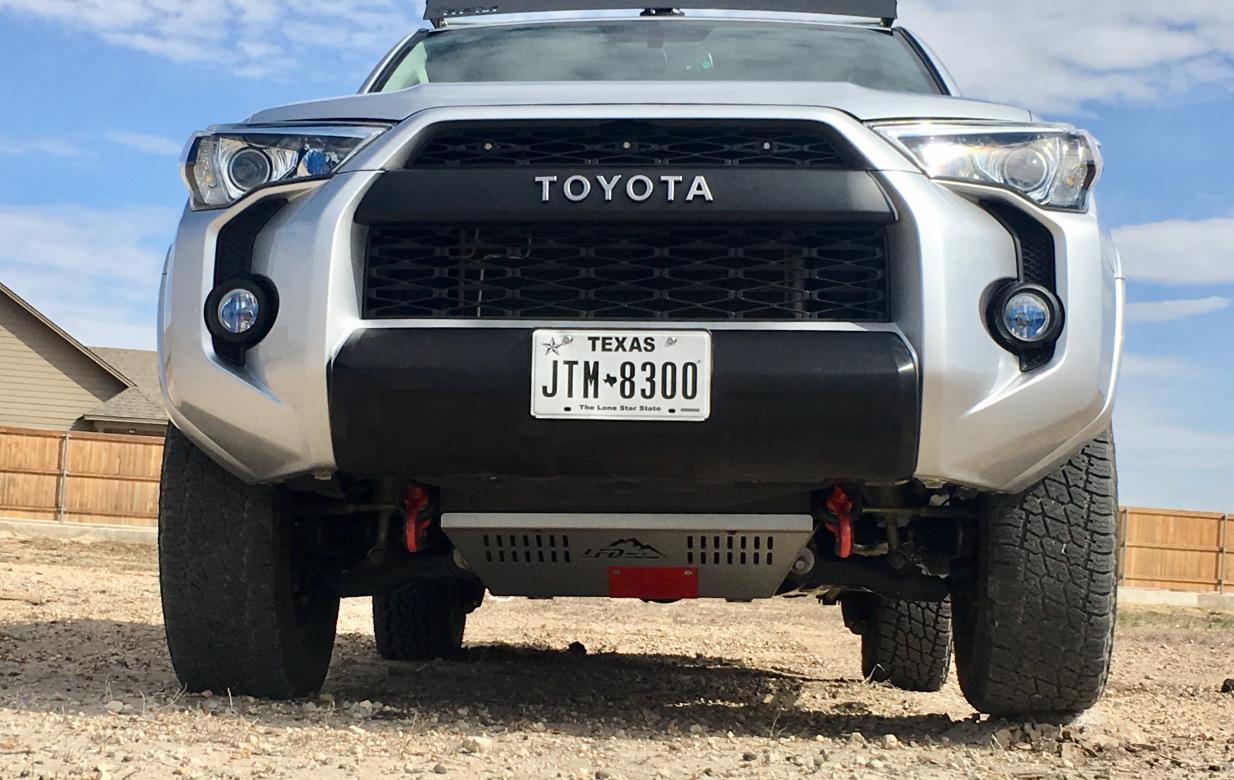

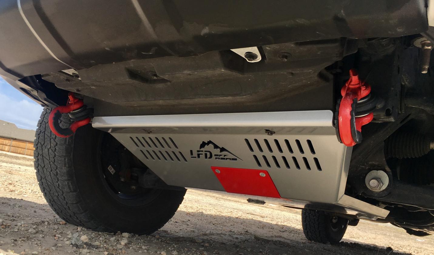

Got my skid powdercoated and put on finally! Thanks to LFD Offroad and [MENTION=136636]jafrush[/MENTION]
