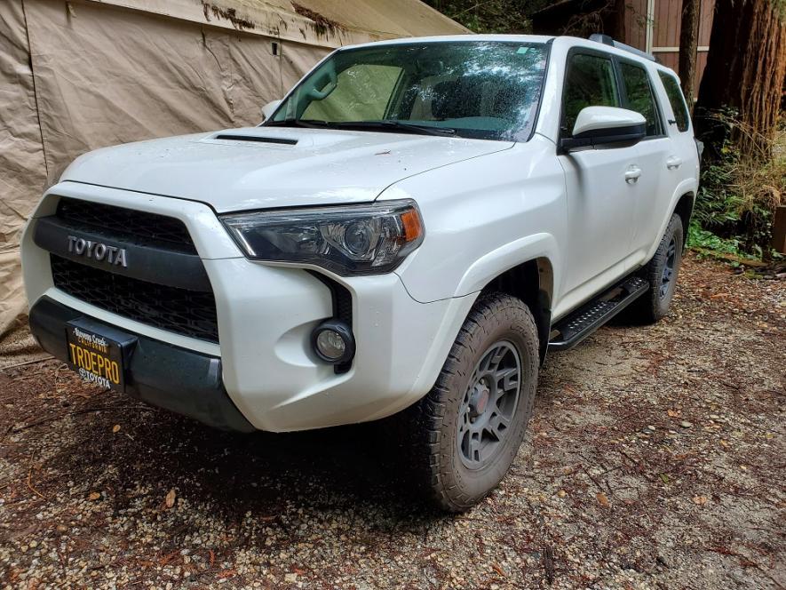

Installed some Shockworks sliders on the wife's TRDPRO, wasn't too bad except those pinch bolts can go to hell. I think I need to do a little more adjusting on the driver side but overall I like them. Time for a much needed beer. :cheers:

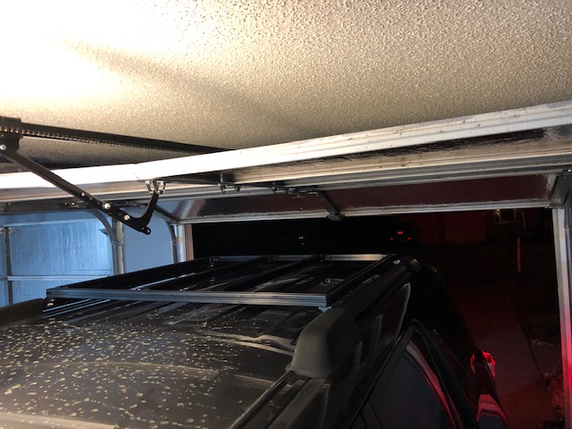

DIY low profile roof rack for under $110.
This is my first post and for some reason not allowed to start a new thread.
I'm not into the 4runner at all but my better half, therefore I'm doomed to work on it.
She wanted a roof rack for our yearly road trip.
Well it had to be low profile since the car still needs to go into the garage.
I kept searching and searching but the price tag on such a rack is not worth it for once a year use.
So I started to look into other option. Being a engineer I have worked a lot with aluminum extrusion material.
And this is what I came up with.
I used the 3030 profile.
No cutting of the pieces. It is very versatile and almost anything can be attached to it.
If you like it a little beefier. It is also available in 4040 or 4545
This is what I purchased
3030 Black T-slot 30mm Aluminum Extrusion Kit 6m Angle Brackets Screw Nut | eBay
and this in 4040 M8 for the attachment to the existing bars.
M3-M8 T-Nut Round Roll T Slot Spring Nut 2020/3030/4040/45 Series Nickel Plated | eBay
