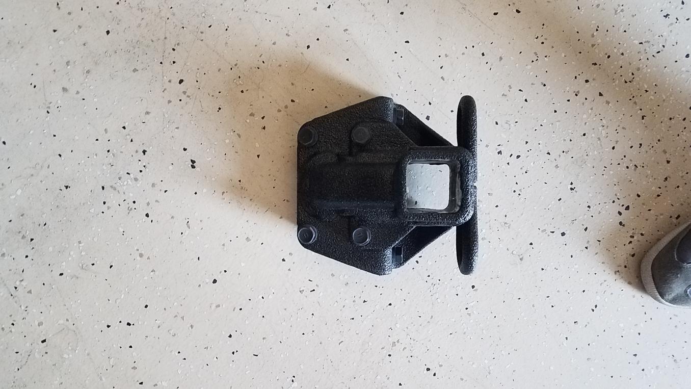

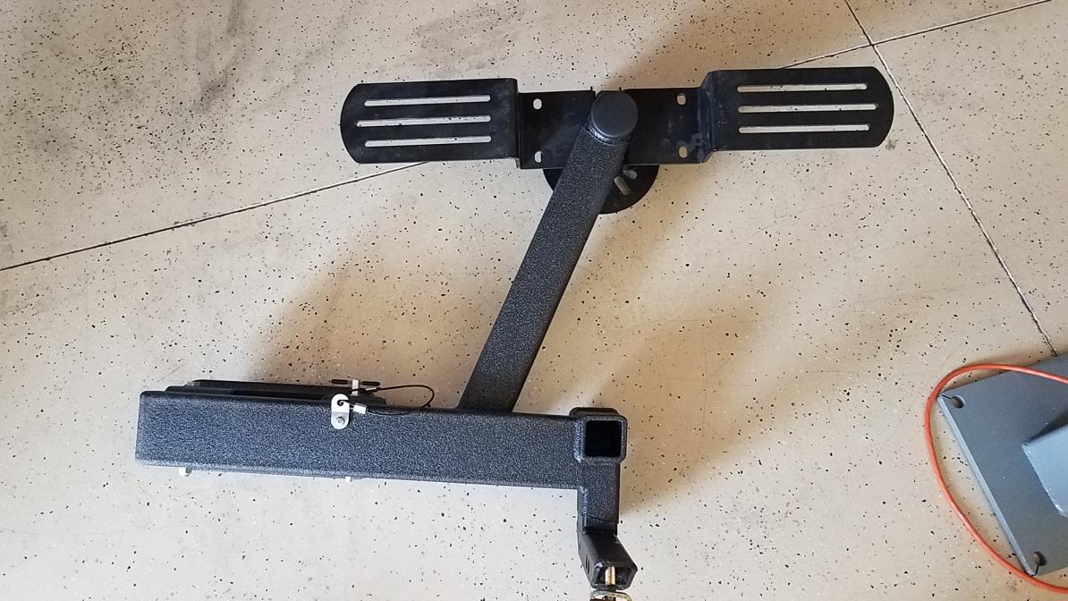

Added the tire hitch mount...so far I love it. :girl:
So after two weeks...it already has surface rust from poor quality powdercoating. Wilco made it out like it wasn't their fault. Had to remove everything including my hitch and get lineX to help out. The rotopax mount and license plate mount going in for quality powdercoating. If anyone is considering a wilco tire hitch mount get it linex or repowdercoated immediately. Wilco can suck a D...hope they end up in Pelfreybilt's situation.

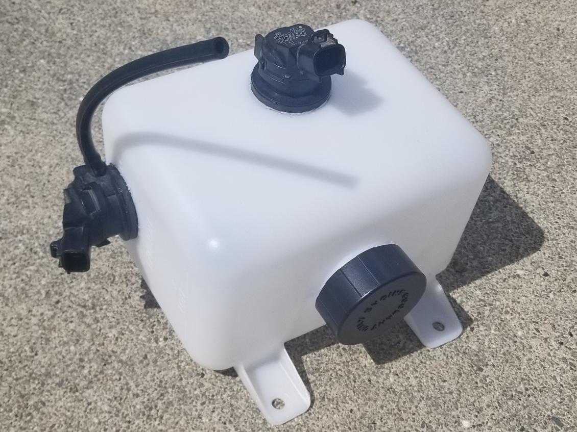

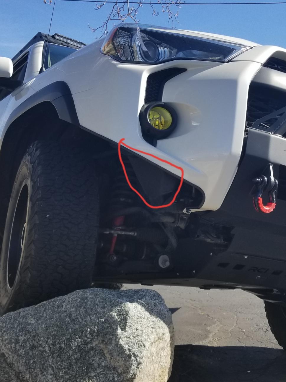

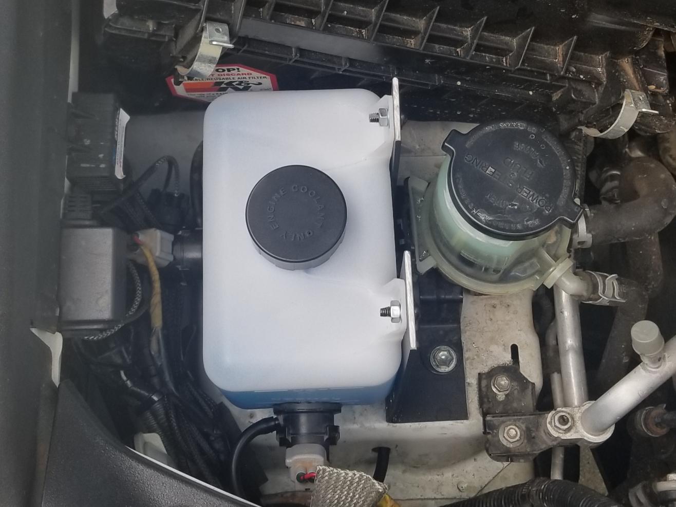

After doing the high clearance mod to my bumper a couple weeks ago the washer fluid tank was bothering me. I made a cover out of plastic which helped but then I decided it was time to relocate.
I found a universal tank made by Dorman (603-001) for $6 and then made some brackets out of some metal scraps I had in the garage. I drilled (2) 1-3/8's holes for the pumps. The hole for the rear pump is slightly higher than the front just like it is on the stock one. I hot glued the bottom hole shut and did a plug for good measure. I also used clear silicone around the pump grommet on both the tank and pump side. Turned out pretty good for less than $10.
