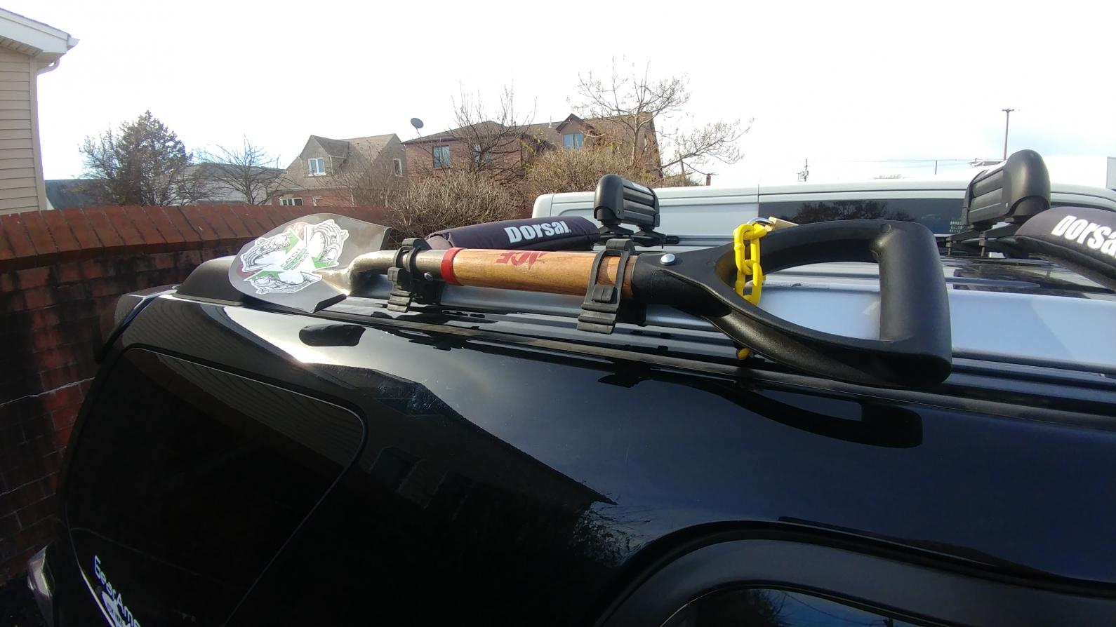

No Drill Roof Rack Shovel Mount
Shovel Relocation Today... Can You Dig It?
Just a few "Quick Fist" clamps. No drill method. Mounted with heavy duty zip ties over black "Gorilla" tape to prevent any sliding or movement. Solid. Shovel was in the back for a while. Was using the third row seatbelts as a sort of shovel holder. Wound up with some minor scuffs on the walls as a result. So... Very nice to have the trusty shovel mounted up top now.
